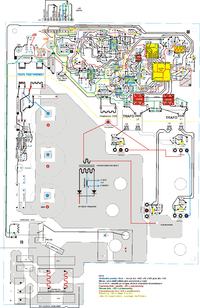

    Hello. The lack of a diagram often discourages repairing the device. I drew a diagram of the Powolin welding machine from Powermax2. The diagram is in such a shape as the elements on the motherboard are placed. It's nice to print it on A2 format, due to the high density of elements. The colors of the lines correspond to the potential according to the legend. I've provided all the values and names of elements, and basic voltages. When you notice errors, please pay attention to this, I will apply the corrections.

    I'm happy that the file is downloaded. I would also be happy to leave my comments after reading the diagram. This will allow me to make corrections that you may need to apply to the schematic. It would be nice if you downloaded :) after downloading the schema

    Are those BA marked schotky diodes?
