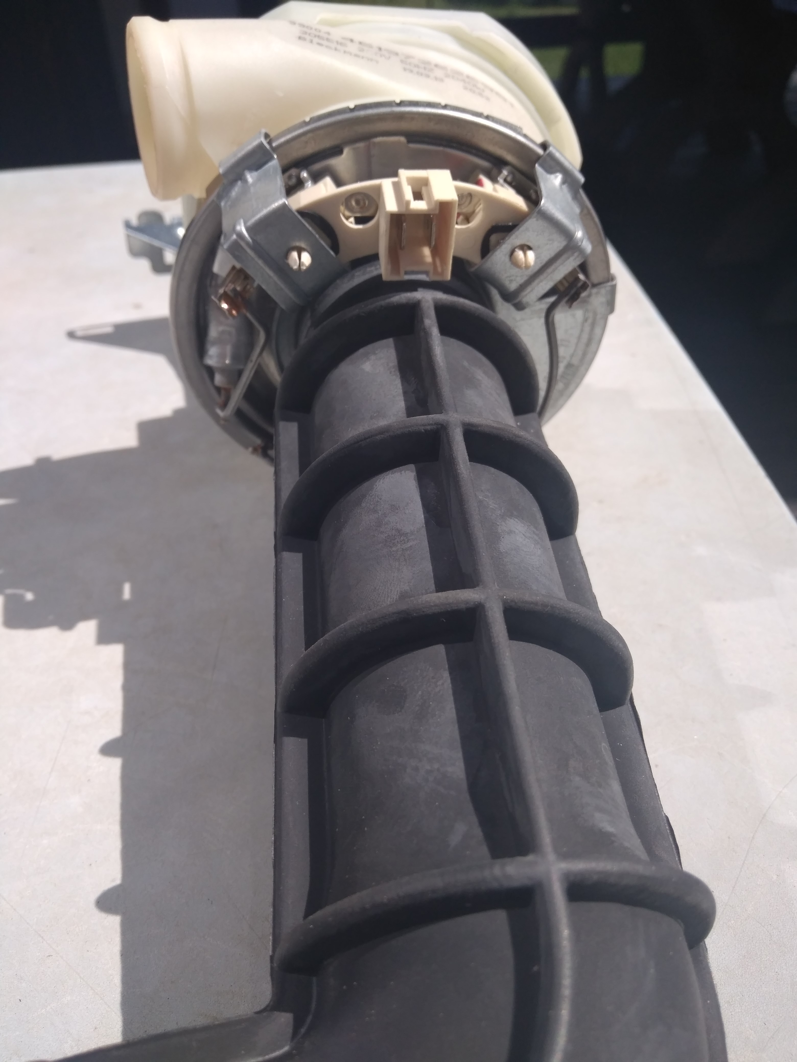

    DariuszPlich
    Posts: 9
    Rate: 11
    gumasek wrote:
    TYou wrote that you have error F9 E1 then you need to replace the distributor. Only that when replacing you have to unscrew the cover in the middle of the dishwasher to which goes the water channel (next to the filter and the sieve) there will be such a plate that only in one position can be mounted on the distributor,.
    To be sure is this part from the photo?
    Clearing Error F6 E4 on Whirlpool ADG6240 Dishwasher after Incorrect Tablet UseD6Z-X3-CL2...-WC5_0.jpg (26.43 kB)You must be logged in to download this attachment. .
  • #13 14534394
    gumasek
    Posts: 100
    Help: 7
    Rate: 112
    Yes, that's what you have to buy.

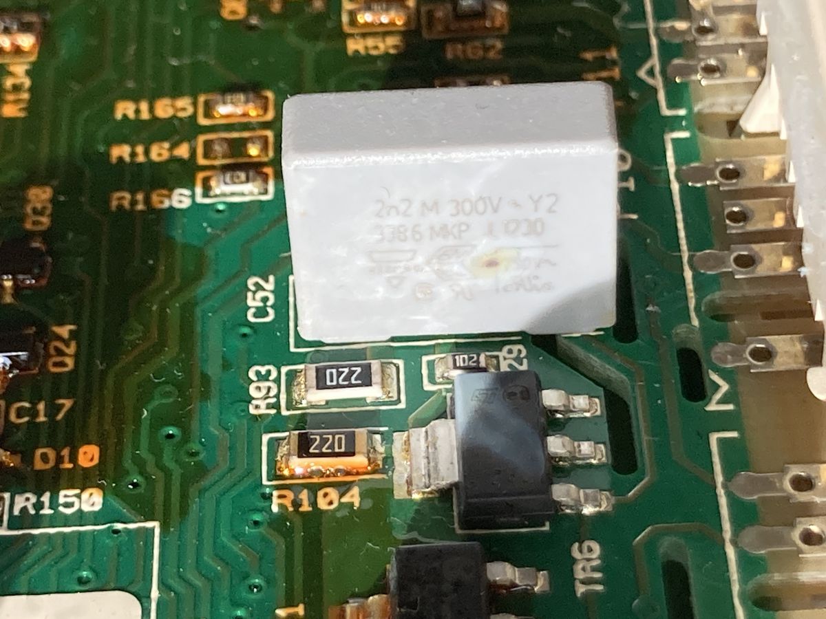

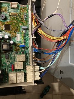

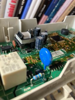

    Hello everyone, I don't want to start a new topic that's why I'm writing here
    My dishwasher is Whirpool ADG9553 error code is F6 E4 maybe someone with more experience can tell me how to check the water distributor. I mean the motor because the micro button is working and the second question what are the components I have burned out on the controller to everything I attach pics. I will also add that the dishwasher got a short circuit through a damaged drain hose. Heater checked ok, drain pump checked ok, float and micro contact checked ok.
    Greetings :bye:

  • #17 16950896
    piwa27
    I had the same error ie F6 E4 : replacing the microswitch in the flux distributor, plus cleaning the contacts on the board and plug. Full success.
  • #18 16954582

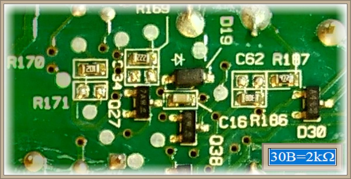

    orajc
    Posts: 111
    Rate: 25
    Hello thank you for your reply, what I care most is what value is the burnt resistor next to the one in the last photo.
    #19 16955093
    TONI_2003
    Moderator
    Posts: 15334
    Help: 2195
    Rate: 3826
    orajc wrote:
    what I care most about is what value the burnt resistor next to the one in the last photo has.
    Please :D Close-up of a circuit board with labeled components. .

  • #24 20277662
    Mrcellok
    Posts: 43
    Help: 8
    Rate: 15
    @TONI_2003
    TONI_2003 wrote:
    Please
    Do you perhaps know what value R184 has? I would also like to make sure about the value of R186 (80E/308) and R187 (4 7(underlined) 2) their measured values are inconsistent with the theory.
  • #25 20277938
    TONI_2003
    Moderator
    Posts: 15334
    Help: 2195
    Rate: 3826
    Mrcellok wrote:
    their measured values are inconsistent with theory.
    It is to solder them out for measurement....
  • #26 20278467
    Mrcellok
    Posts: 43
    Help: 8
    Rate: 15
    R186 is less than 2 kΩ, after soldering, of course.
  • #27 20278751
    TONI_2003
    Moderator
    Posts: 15334
    Help: 2195
    Rate: 3826
    Mrcellok wrote:
    R186 has less than 2kΩ
    Then I'll ask what you read on that R186 that surprises you because I can see from the poor photos that it: 30B =2kΩ :D
    Clearing Error F6 E4 on Whirlpool ADG6240 Dishwasher after Incorrect Tablet Use .

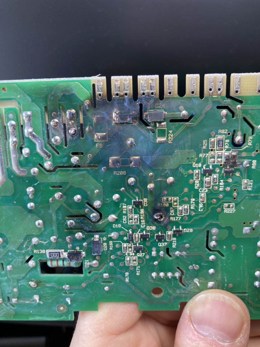

    #28 20901721
    Stager
    It started during the wash cycle of my ADG 6240 FD the main breaker tripped and the lights went out. After turning on the circuit breaker for the dishwasher, the dishwasher displayed an F6 E4 message and I began to investigate. I didn't find any water in the lower tub and started checking the individual components like the heater and the pump and everything seems to be working. However, I disassembled the front panel and discovered the same destruction of components as user orajc on the control board.
    Can I ask if you managed to repair the control board? On my motherboard, the component marked F9 is destroyed, as well as resistor R80, capacitor C52 and about varistor V1.
    I would need to know the values of components F9 and R80.
    I don't even know if these defects arose spontaneously due to old age (e.g. drying out of capacitors) or if there was a malfunction from the outside, i.e. overloading of some component in the dishwasher (pump, valve, etc.).
