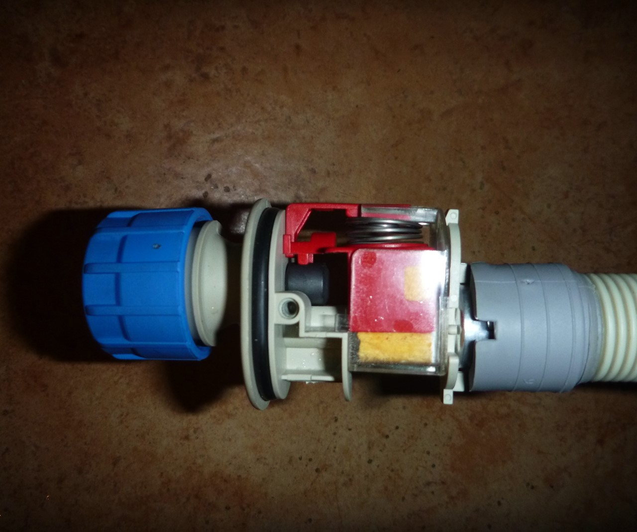

    I found an instruction for a similar dishwasher:
    Link
    According to her, if "F6 E7" or "F6 E1" is displayed:
    1. Water pressure too low - The water tap should be fully open while water is being supplied (minimum flow: 0.5 l / min).
    2. Kinked water inlet hose or clogged water inlet filters - The water inlet hose must not be kinked and the filter on the connector at the water tap must not be dirty.

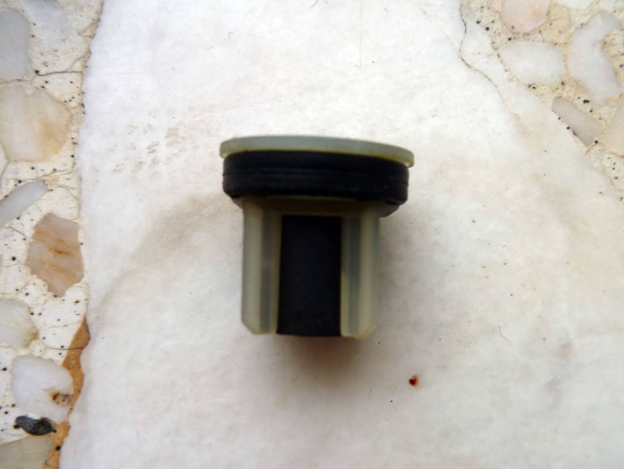

    The OWI sensor is damaged or "chopped", not some "can" :|

    karoalex67 wrote:
    Is it the OWI sensor in the photo in the attachment?
    This is the sensor.

    Connect the dishwasher through the hose that is not included in this "can".
    You probably have a damaged snake.

    This "can" is an electric valve that opens when it receives 230V, which is supplied to it by the dishwasher. Simply put, this hose will let the water flow only when the solenoid valve opens, otherwise it will be clogged.

    If there is no wiring harness, then it is an Aqua Stop hose and the dishwasher can be connected, as my colleague Andrzej 1959 advised, with a hose that does not have this system. The conclusion is that this factory-fitted hose is damaged.

    Unscrew the whole unfortunate hose and connect the regular one from the washing machine and check, there may also be a damaged solenoid valve inside the dishwasher, the one to which you screw the hose. But first check it.
