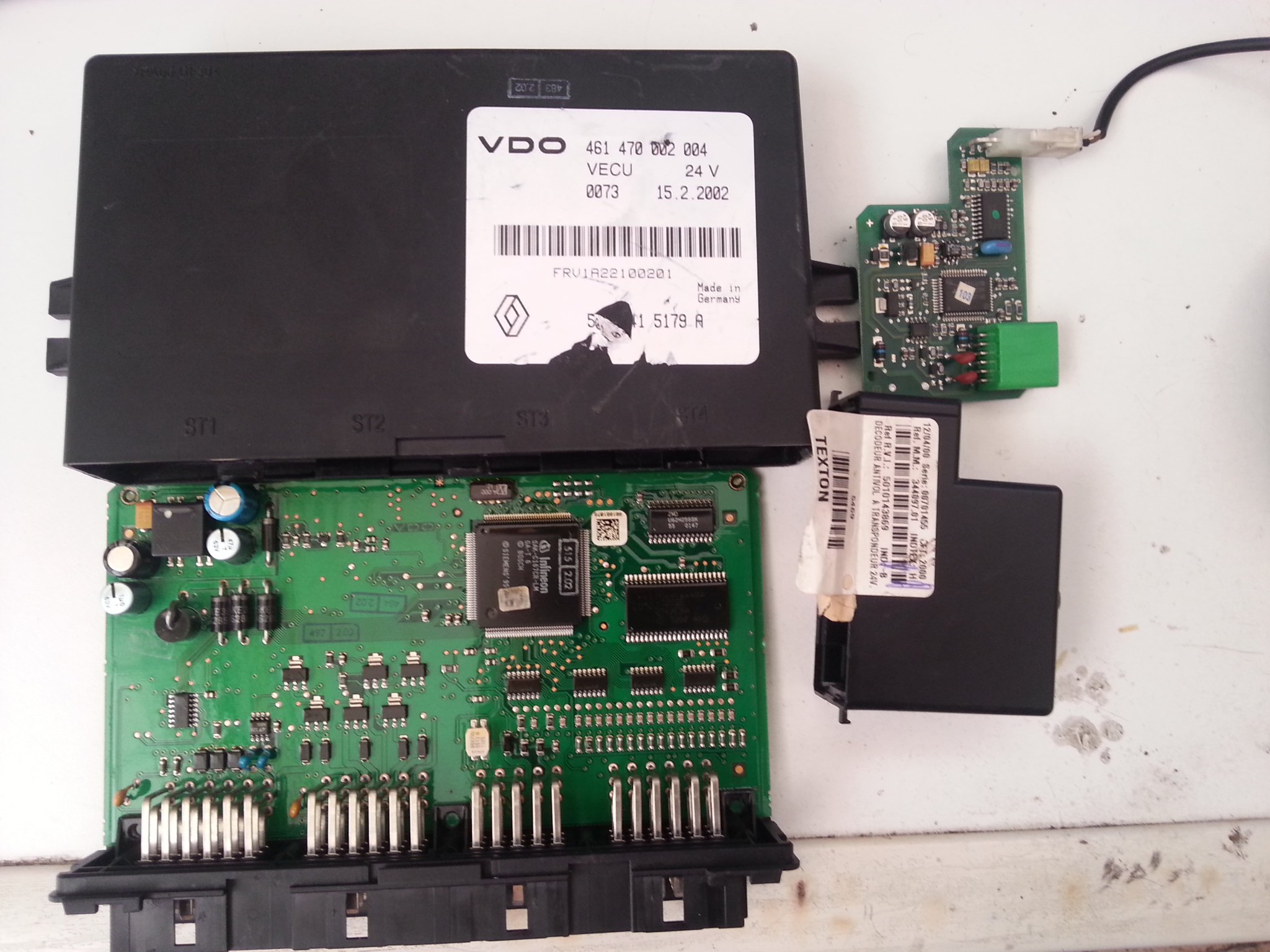

    I am asking experts for advice I found a renegade with imitated immo after reading cans immo- 93C46 same FFFF, so I got a new batch of programmed stone and ECU I made on Virgin, after these treatments Immo went out in ECU errors while no error in VECU I have an error Anti-theft lock active and maszynka nie pali :cry:
    Thank you.

    And that would be enough. Which ecu did you do on virgin because the engine does not have immo

    I have a program that does immo OFF or virgin in the engine ECU

    The motor controller has nothing to do with the imo of all the VECU driver in the cabin.

    You should write the VECU (on-board computer) controller inside the cabin, it is connected there and then it goes to the fuel dose controller (ECU)

    I understand that the pin in immo should be like in VECU so how to pull a pin from VECU or how to put it in there ??

    Has someone a set of batches from VECU and IMMO cans
