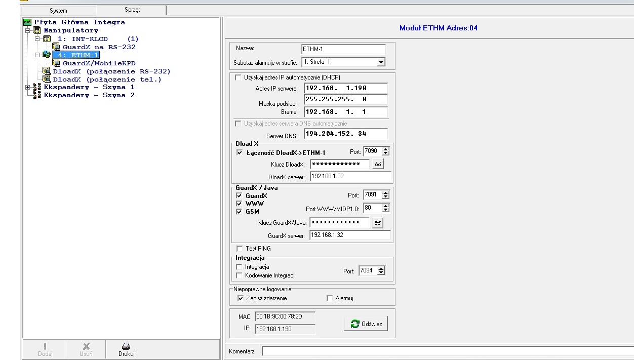

    I have a 128 integrated connected to the ETHM-1 via a Satellite RJ/pin5 cable, and connected to the local network.
    Connection via www works without any problems, the problem occurs when you try to connect via DloadX, the following message appears: "Remote access to the control panel is blocked. Further communication is impossible."
    Downloading is disabled and all keys match.
    Configuration:
    Integra 128 & ETHM-1 Connection: Remote Access Blocked via DloadX, Satellite RJ/pin5 Cable Integra 128 & ETHM-1 Connection: Remote Access Blocked via DloadX, Satellite RJ/pin5 Cable
    Please help,
    Regards.

    After connecting the modules to the control panel Integra 64 it remains to connect the card with a cable used to connect the RS-232 ports of the ETHM-1 module and the INTEGRA control panel with the RJ type socket. (Cable diagram in the manual "TCP/IP ETHM-1 communication module - page 4)
    There is no need for an RS-232 cable to program other parameters, because everything can be done from the keypad.
    From the manipulator:
    1) ([SERVICE CODE][*][9] ) -> options -> options.phone
    a) External modem - set "Y"
    b) Answer modem - set "Y"
    c) ISDN/GSM modem - set "Y"
    (set "T" with the "8" key, remove the marker with the "6" key)
    2) Structure ->Hardware->Keypads->Settings->ETHM-1->DloadX key
    (set there any string of characters and then enter the same in DloadX)
    a) write back DloadX Port - by default 7090
    c) check if Z DloadX is "T"
    3) Status->IP/MAC ETHM-1 - check if an IP address is assigned
    After these activities, ping ETHM-1 if it responds - which still does not mean that everything is OK if it responds to pings.
    Now let's move on to the program DloadX . In the menu Communication->Passwords, phone numbers and verify that everything is entered as needed.
    TCP/IP connection
    - LAN/WAN
    - Server address: (enter the address assigned to the ETHM-1 card here)
    - Port: (if not changed then 7090)
    - DloadX key: enter the one that has been set
    After that enter the menu Connection and choose: TCP/IP: DloadX->ETHM
    Attention! Do not turn on Download on the keypad!
    If, after initiating the connection, a screen appears with the following information:
    That means it works :-)
    Attention!
    If, despite correct settings, a message appears during connection via TCP/IP: DloadX->ETHM "Remote access to the control panel is blocked. No further communication possible" it will most likely only help to reset the control panel from the pins. The post above shows that my case was not isolated, so it can be concluded that there are such flowers in Integra control panels. Interestingly, from what I remember, in the fields DloadX server and GuardX server there were some "bushes" of several characters. After the control panel reset, these fields are empty. And most importantly - it works :-) .
