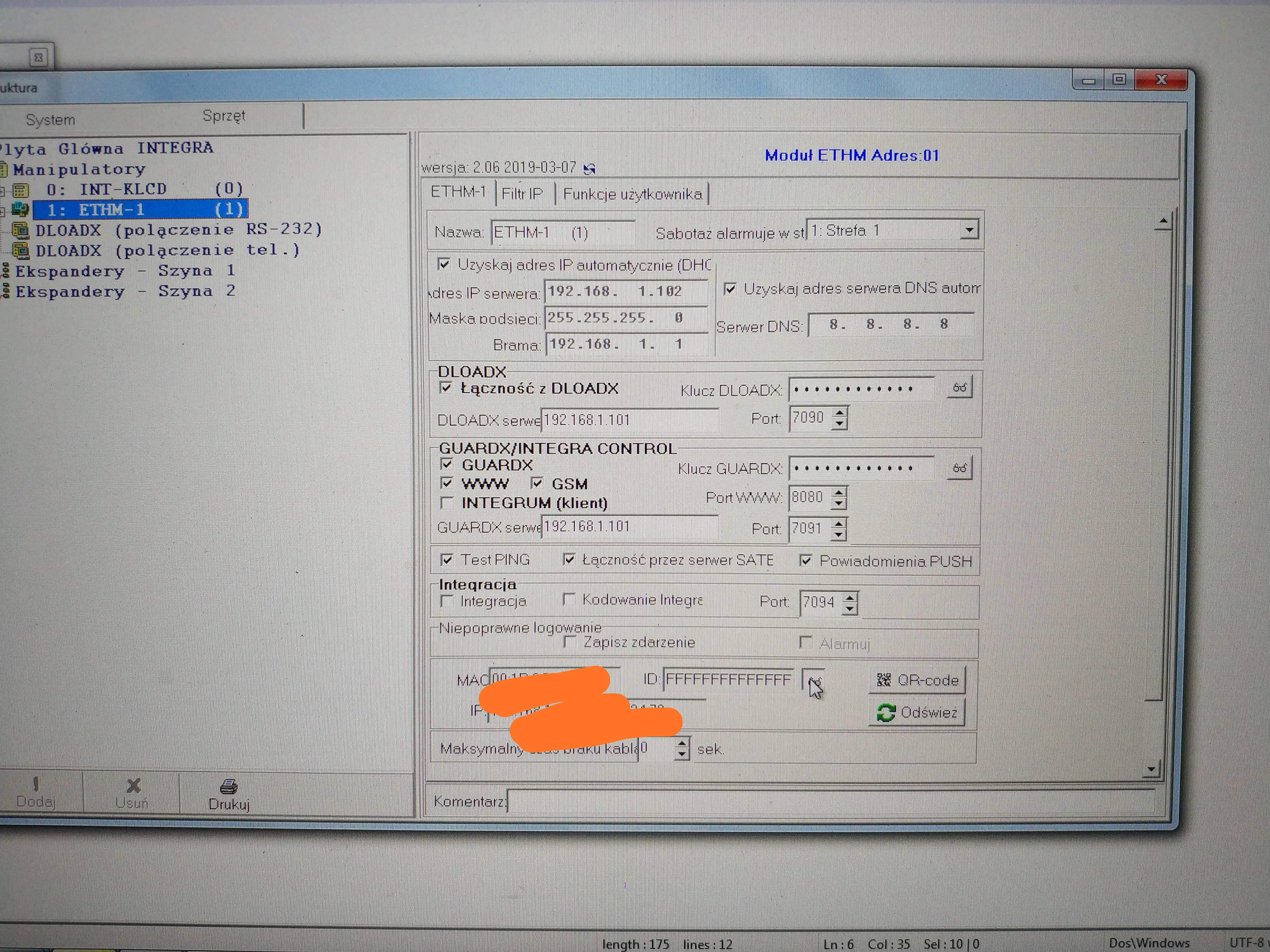

    I'm trying to configure Integra Control apps.
    I have a problem with connecting to the Satel Server, and I do not specifically have an ID number assigned (currently it is FFFFFFFFFFFFFFFF).
    Only the ETHM-1 Plus module is plugged into the Satel Integra 128 control panel. The RS-232 ports of the module and the control panel are connected with the original satellite RJ-PIN5 cable.
    ETHM connected to the network. I use mobile internet from digital polsat. DNS on the router set to google (8.8.8.8 and 8.8.4.4).
    I am able to connect to ETHM via WWW and Dloadx.
    included functions:
    - "with SATEL"
    - external modem
    - ISDN / GSM / ETHM modem
    - answering-modem
    Integra control connects to ETHM without any problems when I am inside the local network (communication method: direct connection).
    Connection from outside is not working (connection via Satel server using MAC address).
    Integra 128 control panel, firmware v1.18
    ETHM-1 Plus v2.06
    Dloadx v.1.19
    integra control (android): v4.5.1 (81)
    although the topic has already appeared, I have not found a solution so far.
    any suggestions welcome :)
    thanks

    In the ETHM-1 tab, do you have "connection via the Satel server" enabled?
  • #3 17987078
    Daniiii
    Posts: 22
    Rate: 14
    yes, it's on.
    when I refresh the settings related to the satellite server (in dloadx), where you can display QR, the following appears: MAC, internal and external IP address ETHM, but the ID field is ffff ...

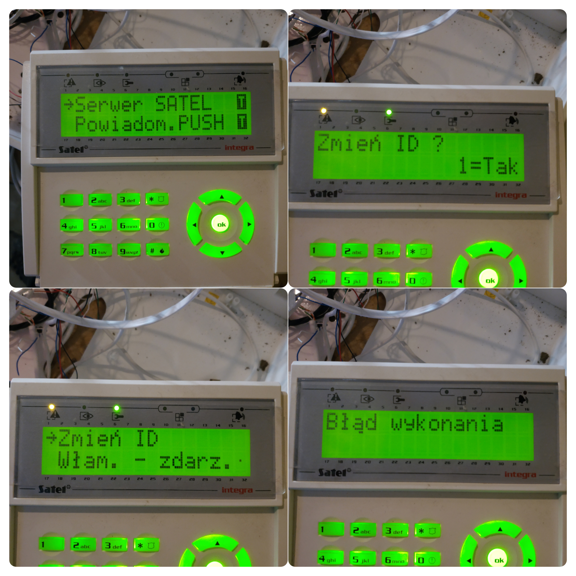

    I suggest trying to change the ID from the keypad (if it works). So service mode -> structure -> hardware -> keypads -> settings -> ethm-1 -> ID change -> confirm with "1".
    If the "Change ID" option is not available, it may mean that the Satel server is not enabled in this control panel (module).

    I tried this too and I really can't change the ID.
    So I will check this option again, although I'm pretty sure it's turned on.
    thanks for the suggestions, and I will let you know how to check the switchboards.

    ID cannot be changed (does not pass) is the option not available? Because they are two different things.
  • #7 17987208
    Daniiii
    Posts: 22
    Rate: 14
    the option is available, the ID cannot be changed

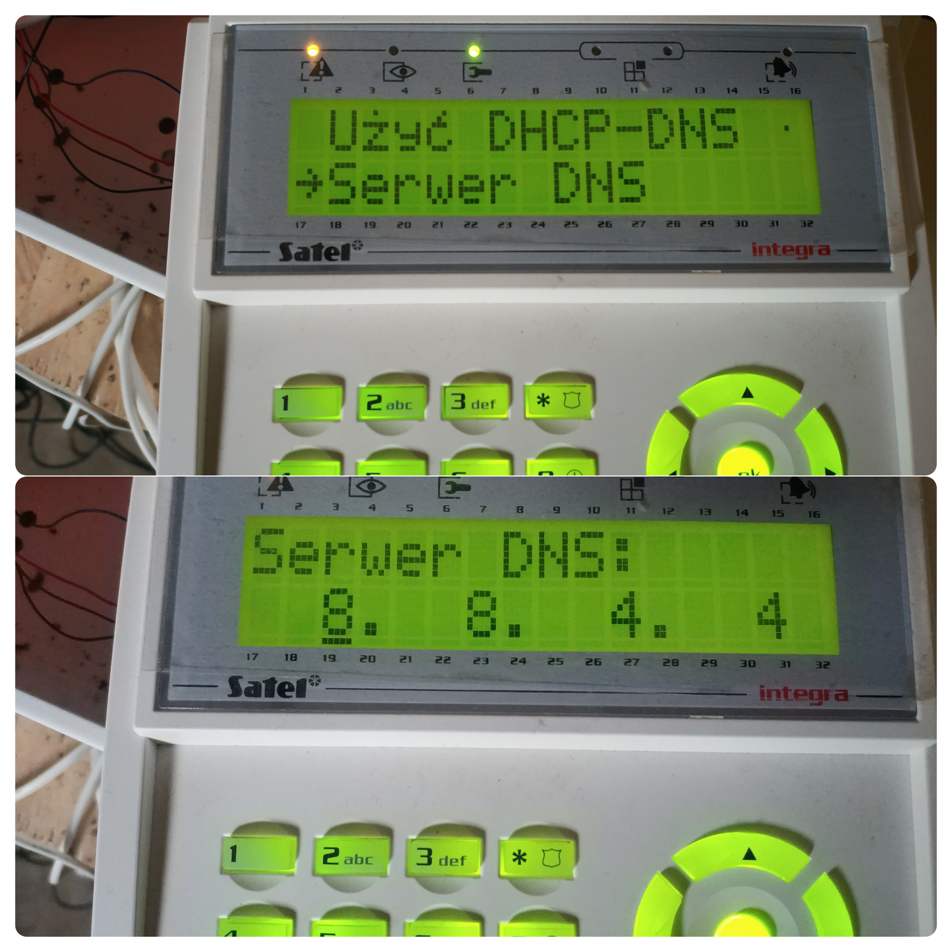

    Maybe there is something wrong with DNS. At this point it is not 8.8.8.8, only the DNS address is taken from DHCP. And I understand that it is set in the router, but it does not interfere with setting such DNS in ETHM.
    And the problems with the lack of proper DNS are in my opinion the most common reason for not working with the Satel server. At least I face such problems.
  • #9 17987537
    Daniiii
    Posts: 22
    Rate: 14
    exactly like that, DNS 8.8.8.8 and 8.8.4.4 and one more (I don't remember from head) is set in the router and assigned to ETHM via DHCP.
    that is, try to disable DHCP and assign DNS in ETHM rigidly?
    good idea. I'll try tomorrow

    unfortunately setting DNS hard did not help. I've tried with different DNS servers, eg 8.8.8.8, 8.8.4.4, 1.1.1.1, 9.9.9.9 and some others.
    is it possible in some other way to check the connection to the satellite server?

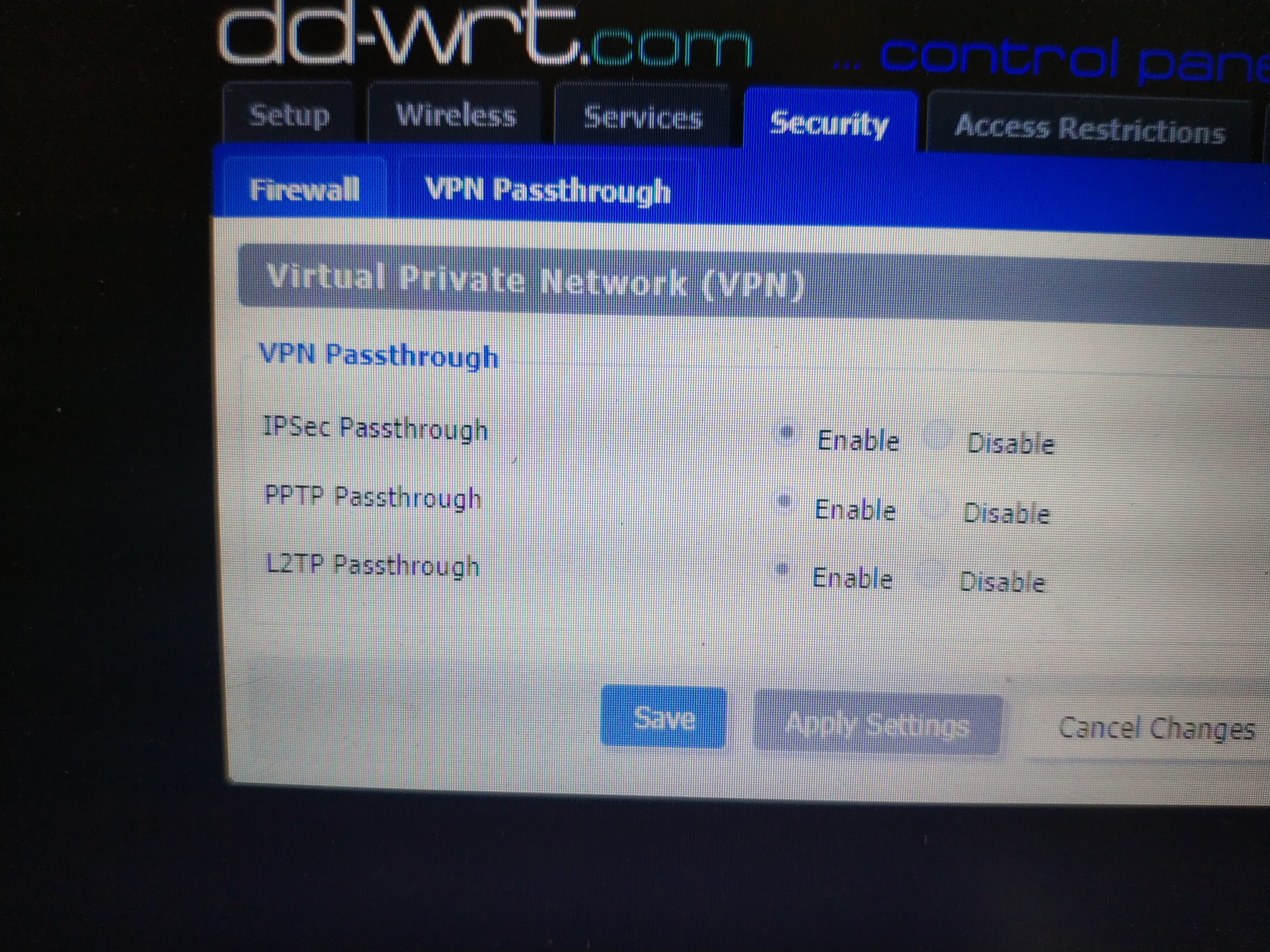

    On your router, check it quickly if you have VPN passthrough enabled.
    Something like this:
    VPN
    PPTP Pass-through: Enable
    L2TP Pass-through: Enable
    IPSec Pass-through: Enable
    Should help. If not - it can be worse because it may mean that ISP is also blocking it, although it would be an overstatement.
    Generally, you must be set up to establish VPN connections.
    greetings

    @Mar_rcin
    the options you mentioned are enabled (photo)

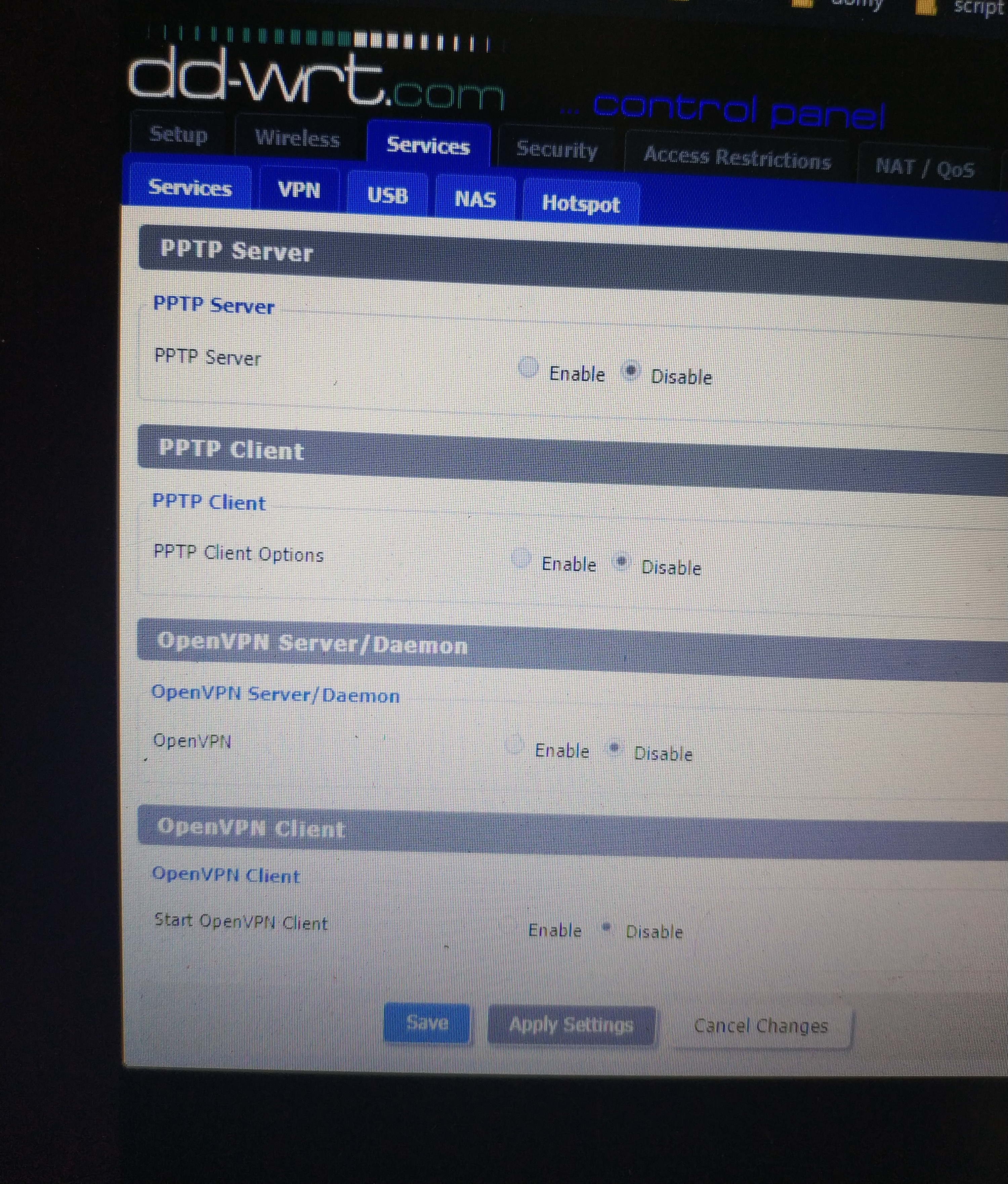

  • #20 17998157
    Daniiii
    Posts: 22
    Rate: 14
    or is it a matter of different VPN settings?

    sosarek wrote:
    After all, you have disabled services ...
    Exactly. You didn't set up a VPN.
    I understand it's a mistake?
