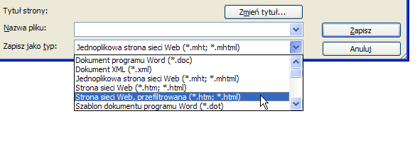

    Recent versions of Caliber allow you to convert directly from docx.
    The recommendations so far have been as follows:
    1. work on your doc / docx file, and when you're done
    2. save the file as filtered html (older versions of Word can do that too).
    3. Import the html file into Caliber.
    If there are headings in the document, Caliber can create a table of contents convenient for the reader (s). I don't know how all readers handle it, but two levels of the table of contents should adopt (K. Paperwhite for sure).

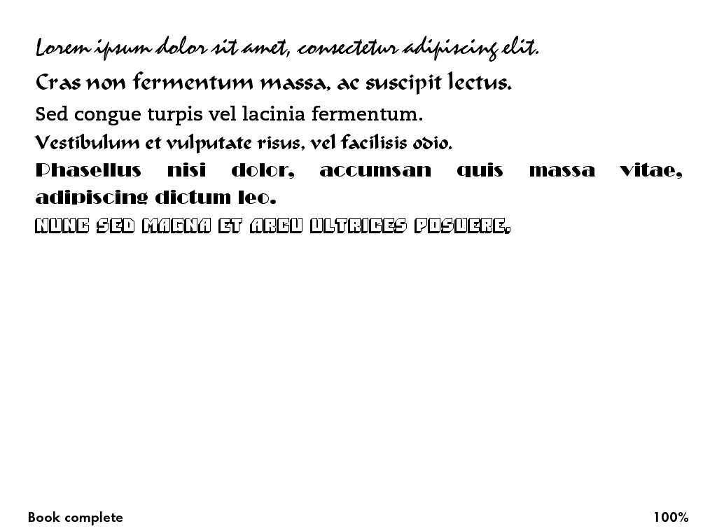

    and finally a small sample (a screenshot from the reader), but I make a reservation right away - every reader has a chance for other solutions (or lack of them), so it's better to be careful with other fonts:
