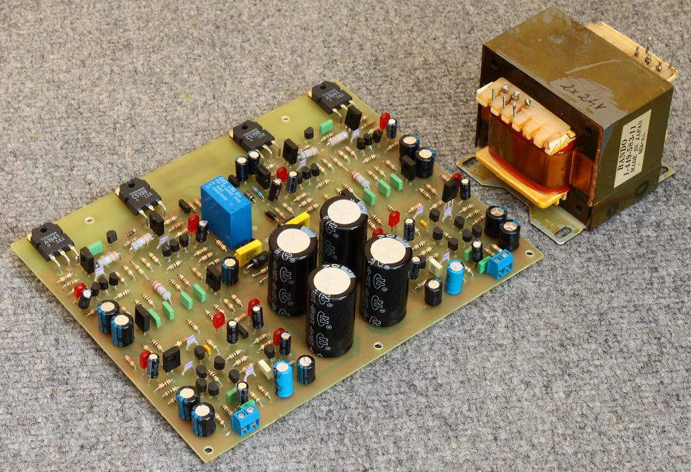

    Qualcuno ha lo SCHEMA ?
    grazie

    You can search for schematic based on transistors 2SA1941 and 2SC5198. They are very popular in audio power amplifiers.
    There are a lot of schematis, most of them are similar ;)

    Dude, I am assuming you want to put it all together, right?
    It is a very simple circuit - you need to post a large picture of both sides of the board and someone can point you in a right direction.
    I see a rectifier bridge in a center of it - so that's where you want to connect your transformer 2x24 outputs. The outputs are where you got these large transistors - and the inputs are the small blue screw connectors. OK?
