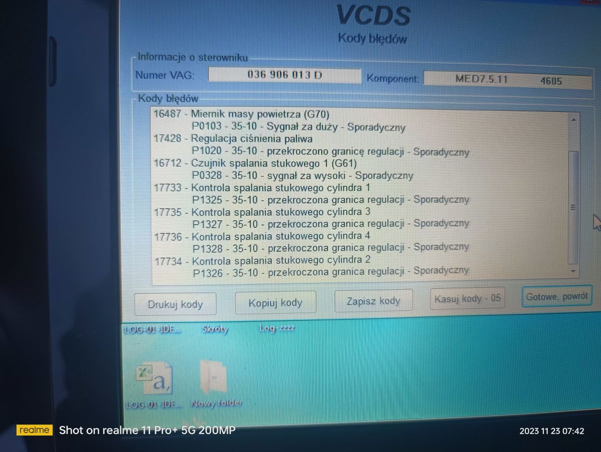

    I have a problem with my Golf V 1.6 FSI Sportline from 2003/2004.
    Car from Italy, full service (history checked in the VW database), the course of the original - 109 425 km (I made in 2 months over 1000 km).
    The problem is that - let me post my stories from another forum:
    Jul 21, 2013
    Today I left the car and think "I switch the computer to average daily combustion" ... and I stand at traffic lights (200-250 meters from the garage, the engine was cold from the previous day) and looks like the combustion grows ... 22 liters, then every few seconds by 0.2-0.3 liters per 100 .... until the light changed to green and I had 26-27 liters.
    I think something a lot but it may be so, because the average daily driving from the city is about 6.9 l (night, no traffic) - 7.8 (today, Sunday, small traffic). So generally burning decent - pour PB 98 on Orlen - always the same station in the city, refueled there the previous car, Police there refueling police cars (so they have good fuel).
    I switched off the car after leaving the garage for about 2 km (it was from 80 degrees on the indicator and I went for quick shopping - up to 15 minutes).
    I came back, I fired and ... sk **** n went out: / (I am terribly upset by my car, my Corsa B, despite 203 thousand km never disappointed me, I sold because they corroded the stringers) - but the second time I started, as if I wanted turn off but I gave him some gas and it was ok.
    The revolutions do not wave (before changing the candles they waved - I set up NGK ZFR6S-Q).
    I drove later on city roads (70-80 km / h) with approx. 6 km and ... :shock:
    How do I start and run it evenly, but quickly - always like a warm engine - never on cold. It must always be around 90 degrees on the indicator.
    Changing the candles I made throttle pics (according to the mechanic does not look bad yet, but you have to clean, but again He has no computer to do the adaptation ...):
    VW Golf V 1.6 FSI - Problem with the NOx sensor and the engine / electrics VW Golf V 1.6 FSI - Problem with the NOx sensor and the engine / electrics VW Golf V 1.6 FSI - Problem with the NOx sensor and the engine / electrics
    I do not have a cable, but I think I will buy one ... I will not make a connection for PLN 90 (recently NOx, some error). It used to go out, but I replaced the battery and the same (2 km after changing the battery, the previous one was already 9V and was very old ... maybe the original from 2003. Charging is ok. DO NOT SAY JUST - they just said OK . Candles - it was ok until today (from 2 weeks ago).
    5 Aug 2013
    about 80-85 km from the NOx deletion (week after city) and it turned on as I entered the garage. Late so I was not going to the mechanic (after 21)
    EDIT: P1033 (NOx sensor - signal too small) - always the same. Mechanic puts a leak in the exhaust system (draws in air) ... The second fool probe has a slow resistance of 0.00 and after adding gas jumps from 0.00 to 2.00 (various readings are) and this in a circle ...
    In addition, it showed: P1914 - brake assist pressure sensor - an unintelligible signal. Why ? The car drives normally, and on Thursday there was no mistake. I had insulated cables under the hood - at the height of the plastic cover of the engine, behind it - you can see a yellow tape. A mechanic, a month ago, when I was exchanging candles, he said that something was being touched, but he did not touch.
    11 Aug 2013
    Again the check lit up ...
    From the deletion I made about 180-190 km (recently route 155 km in one day, moderately 80-120 km / h, almost constant climat and side roads 30 km / h, average consumption from a computer 7 liters. Once without an air condition of 5.4 l / 100 km, but also without these side roads - is 1.6 liters per 100 a big difference?).
    Probably the same mistake as last - the cable will come, it will write more.
    I turned off the garage and switched on and off immediately. As I fired the second time, I gave him gas slightly, it did not go out. I pulled into the garage and revolted around 950, I think too much ... and I checked to 3-3,500. Turnover and after releasing the gas dropped to 700. The engine is known, warmed up 90 degrees after driving 12 km.
    Everything happens when I cross between 3 - 3,500 of turnover ... In addition, in the garage today (when I strapped) smelled of rotten eggs from the exhaust - slightly, but I'm just sensitive to smells :lol: Evidently, the exhaust gas because you felt behind the car, in the engine compartment, zero odor. Smell delicate but feel.
    Something I think is all the fault of the dirty throttle, dirty entry, and maybe I have a small hole in the exhaust (somewhere before the second catalyst) ... I have not checked anything yet

    Address 01: Engine Labels: 03C-906-056-BAG.lbl
    Part No SW: 03C 997 056 M HW: Hardware No
    Component: MED9.5.10 00 9265
    Revision: 00000000 Serial number: VWZ7Z0C8715883
    Coding: 0000072
    Shop #: WSC 01722 264 93767
    VCID: 37792FEF3A69
    3 Faults Found:
    17441 - Sensor for NOx (G295): Signal too Low
    P1033 - 002 - Lower Limit Exceeded - MIL ON
    18321 - Pressure Sensor for Brake Boost (G294): Short to Ground
    P1913 - 002 - Lower Limit Exceeded - Intermittent
    18322 - Pressure Sensor for Brake Boost (G294): Implausible Signal
    P1914 - 008 - Implausible Signal - Intermittent
    Readiness: 0000 0001

    Hello, I have a similar problem with the Golf 1.6fsi, in the morning the car turns over and I don't want to start it when connected to VCDS, the errors I posted in the photo and now where to start to diagnose the fault step by step. Regards.
    Screenshot of a VCDS diagnostic screen with vehicle error codes. Screen displaying VCDS program showing error codes for a car.
The discussion revolves around issues with a 2003/2004 VW Golf V 1.6 FSI, particularly concerning the NOx sensor and engine performance. The user reports abnormal fuel consumption readings, with figures rising significantly at idle. Responses suggest potential causes, including a leak in the valve connected to the air filter, which could lead to uneven engine rotation and stalling. Users recommend checking for leaks, using VCDS for diagnostics, and considering injector cleaning and fuel filter replacement. One user resolved a similar NOx issue by sealing a hole in the exhaust system. The conversation emphasizes the importance of proper diagnostics and maintenance for resolving engine-related problems.
