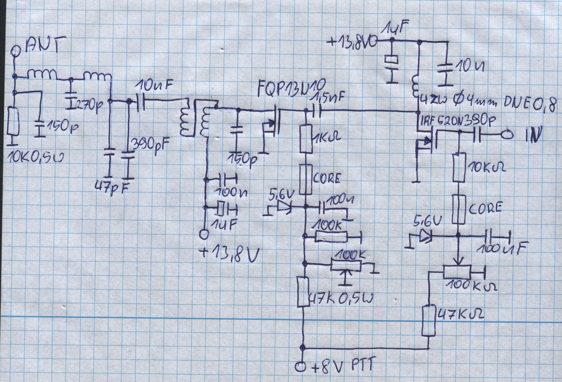

    I was forced to do this by the price of the original transistors and the ubiquitous coloring.
    So, after analyzing a multitude of diagrams, I came to the conclusion why not to use easily available and commonly used mosfets in new radios.
    I went to work and it worked, so I wanted to share it with you.
    I apologize in advance for the quality of the photos as I was taking a webcam.

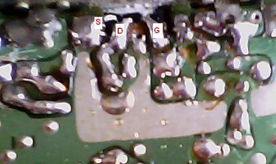

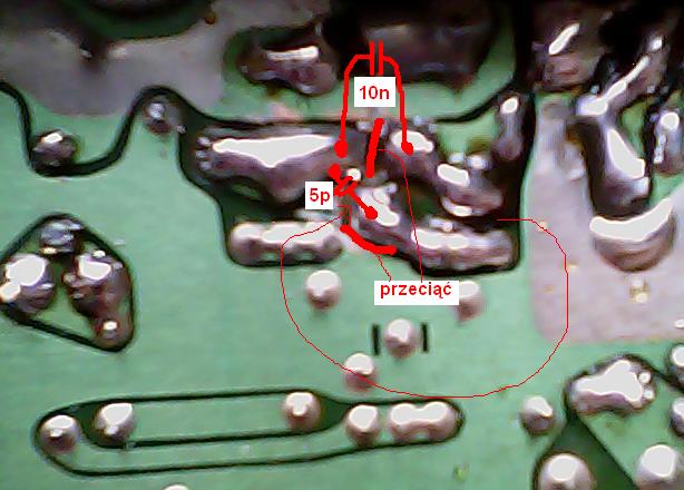

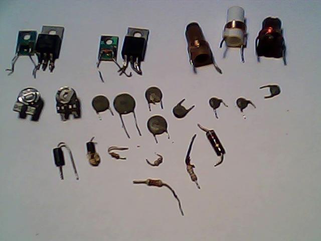

    I started with dismantling the old elements.
    Final stage resuscitation CB PRESIDENT JACKSON IRF520N FQP13N10

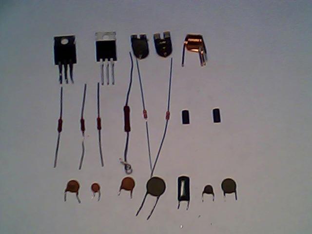

    Next, the diagram of the new stage was created and the necessary components were assembled.
    Transistors.
    IRF520N better IRF510 but I didn't. The price is around PLN 2.

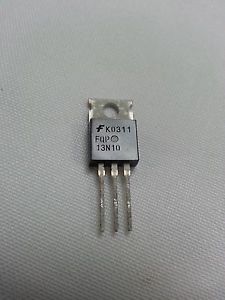

    FQP13N10 price around PLN 5.
    LEDs.
    Zener 5.6V two pieces. Price 2 PLN.
    Resistors.
    1k-10k-100k-47k-47k0.5w. I had.
    Peerki.
    100k two pieces. Price: PLN 3.5.
    Capacitors.
    390pF two pieces. Jackson disassembly.
    47pF. Jackson disassembly
    150pF. I had.
    1.5nF. I had.
    10nF. I had.
    100nF. I had.
    Two ferrite beads. Jackson disassembly.
    Coil twice 3.5 ZW on fi 7mm DNE 1mm. I did.
    The price for the elements is negligible in my opinion.
    Assembly time approx. 3 hours.

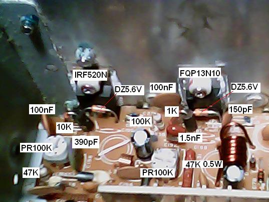

    Final stage resuscitation CB PRESIDENT JACKSON IRF520N FQP13N10 Final stage resuscitation CB PRESIDENT JACKSON IRF520N FQP13N10
    Then I started editing.
    Final stage resuscitation CB PRESIDENT JACKSON IRF520N FQP13N10 Final stage resuscitation CB PRESIDENT JACKSON IRF520N FQP13N10 Final stage resuscitation CB PRESIDENT JACKSON IRF520N FQP13N10 Final stage resuscitation CB PRESIDENT JACKSON IRF520N FQP13N10

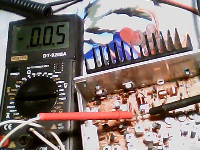

    After assembly, it was the turn of the quiescent currents: driver 70mA, tip 50mA.

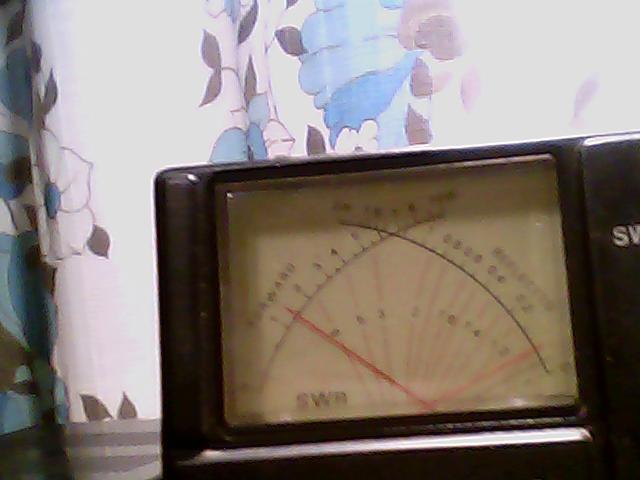

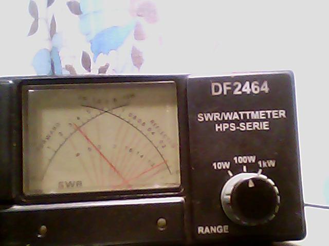

    And now test the power AM 14W SSB 30W.

    After testing, they perform no worse than 2SC2166 and MRF477.

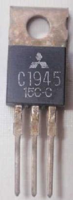

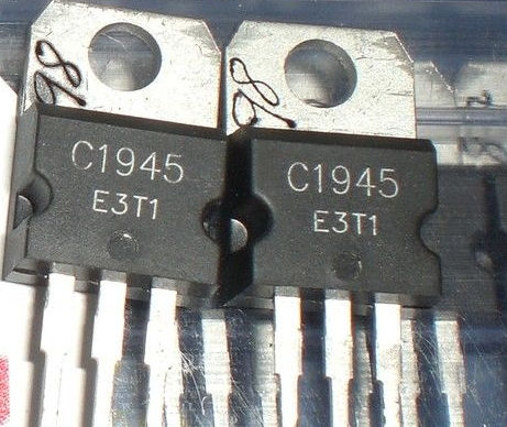

  • #8 14420641
    rotkiw19
    Posts: 16
    Adamcall
    2SC1945 You can get it from Chinese for about $ 9 ;)
    Which you can wear ... in shoes, but not in the system being repaired. Because they don't keep parameters and they burn or don't work properly. Fakes and coloring books.

    The original 2SC1945 was from Mitsubishi and all the others, unfortunately, are paint jobs that, even if they "work", are a different transistor.

    For 10 years I worked in the CB radio service and I will say that sometimes we dismantled the amplifiers to put the client on the MRF, and the 2SC1945 is actually a lame. It's better to use Russian pastilles. However, the idea was brilliant. I need to check. Respect.

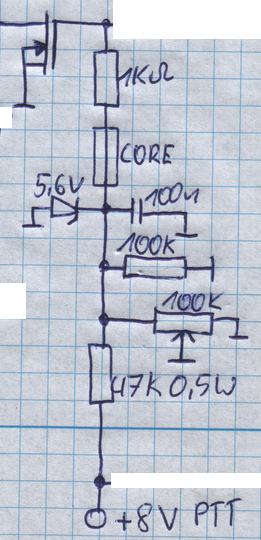

  • Questioning the Zener bias circuit and IRF gate drive
    #12 14422749
  • #13 14422769
    Kwazor
    Posts: 2483
    Help: 184
    Rate: 530
    You certainly do not have 100% modulation in AM, because the modulator will not do that ... So slide down with power, because you are not domodulated on the bank.
    The PA current is 100mA in the original, it was for a single end. So you have too little too.

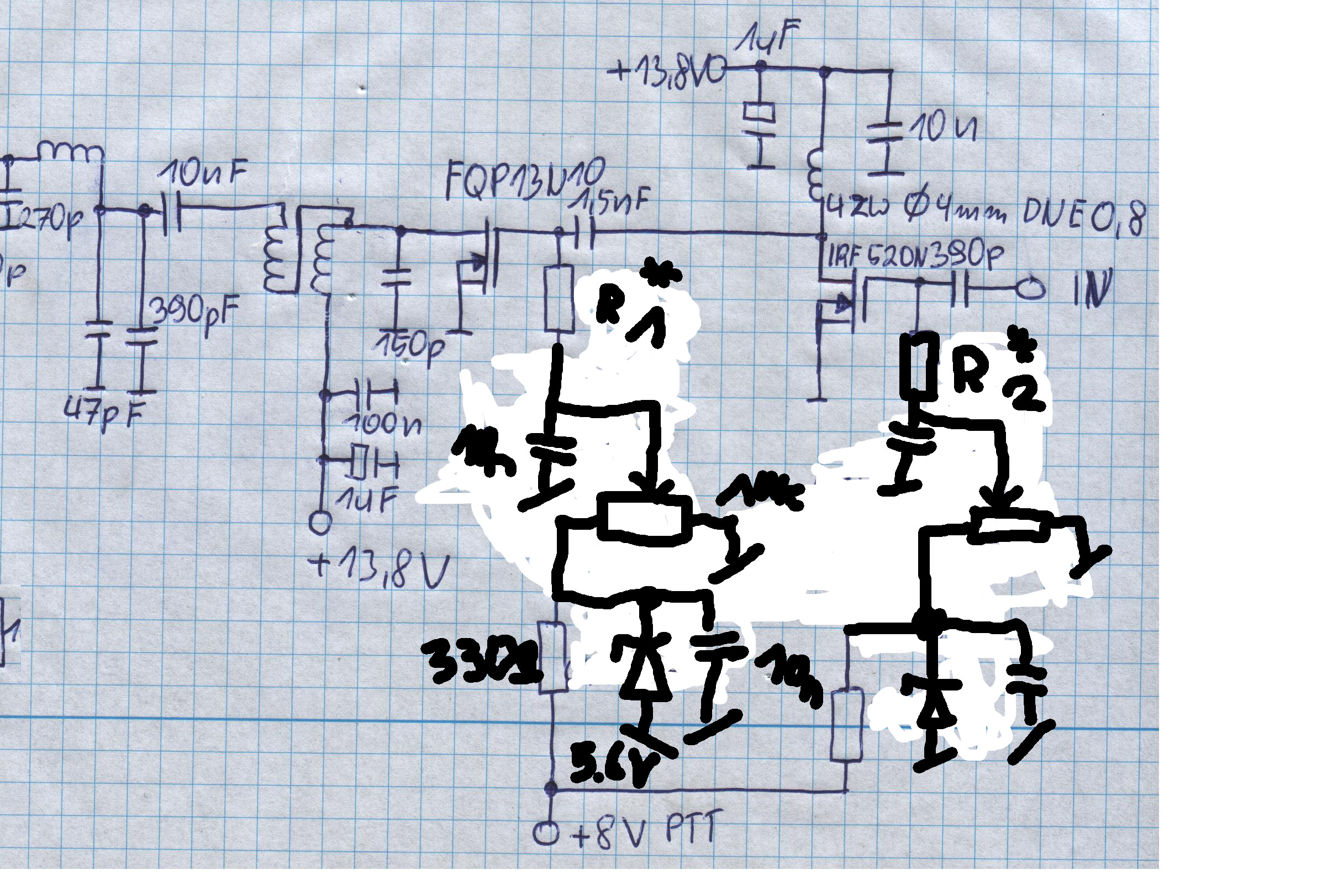

    KrzysztofS wrote:
    I am already writing what it is about, this piece with a Zener diode. Actually what is it about ??
    I was also wondering what their function is and I am not able to comprehend it for anything ...
    Was the output signal observed with an oscilloscope or (which would be great but who has one at home) with a spectrum analyzer?

  • #19 14423481
    Adamcall
    Posts: 156
    Help: 21
    Rate: 77
    KrzysztofS wrote:
    My friend, however, the price of these transistors is knocking down. It knocks because they are used in Linkolanch and other radios and only because. The strike price is not much different than an IRF. But selling aaa because it is Linkol's. That's why we're saying no here. Better to convert to PLN 5, not PLN 80 :P
    I would make this polarization like this:
    Of which R1 and R2 should be selected with regard to the load of the HF stage and it should rather be done in a working system. In addition to these zener diodes, I do not understand these resistors in the gates of these selected (core), what for ?? Where is this direct current supposed to flow there ?? My guess is that they were supposed to limit the regulation of these PRs ...
    Regards Krzysztof 73
    As for your correction, first see the original diagram and then incorrectly correct it.
    These diodes do not act as stabilizers in this system.
    http://www.cbtricks.com/radios/galaxy/dx98vhp/index.htm

  • #20 14423561
    SQLmaster
    Posts: 829
    Help: 31
    Rate: 172
    In your schematic, they don't act as stabilizers. Well, they don't work at all.
    However, in the original, their role is completely different and very ingenious - the polarization of the gates of the MOSFET transistors only when transmitting and turning them off when receiving, so that they do not noise towards the antenna and do not consume power unnecessarily. And yes, they make zenerkas there for stabilizers and for HF voltage rectifiers. They are also connected there completely differently than yours. What KrzysztofS advises is better in your case. If the 8V voltage is already stabilized, these zenerki can be simply removed.
  • #21 14424020
    Adamcall
    Posts: 156
    Help: 21
    Rate: 77
    SQLmaster wrote:
    What difference do you see. Final stage resuscitation CB PRESIDENT JACKSON IRF520N FQP13N10 Final stage resuscitation CB PRESIDENT JACKSON IRF520N FQP13N10
  • #22 14424283
    SQLmaster
    Posts: 829
    Help: 31
    Rate: 172
    Adamcall wrote:
    SQLmaster wrote:

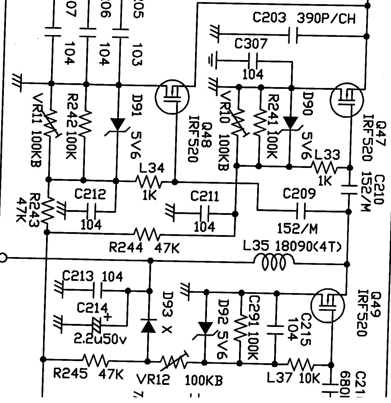

    1. This link you provided earlier leads to 20 diagrams, I referred to another.
    2. The difference I can see is that this diode will be idle when powered from 8V:
    You have 8V. Even if you set the potentiometer to the maximum resistance of 100k, the divider will produce a voltage of 4V on the zener diode. EVEN the fact that NIBY this diode would limit the current of the transistor to a reasonable value with the potentiometer being completely broken by the 'radio poker' is not an option. After it is completely broken off, the voltage will be 5.3V. Still not enough to turn on this diode.
    We don't know if the same voltage is there in the original you copied and that may be the difference . Because maybe there is, for example, voltage not 8 but 12V. I don't want to analyze it.
    But if you have an idea why this LED is there, I'll be happy to hear it.

    This is a new matched pair of 2SC1945 Eleflow replacement RF power transistors for CB / HAM radios.
    Commonly used in many old type CB transceivers as a PA final and also in some vintage HF transceivers as PA drivers or finals.
    This transistor uses internal CE diode protection and is designed as a direct replacement for the original Mitsubishi device which was
    discontinued in 2003.
    Note; All pairs are matched for within a hFE of 2, most pairs are exact match - hFE range is from 80 - 110.
    2SC1945 SUBSTITUTE APPLICATIONS:
    The 2SC1945 RF transistor can also be used to replace the obsolete 2SC2509 Toshiba and 2SC3133 Mitsubishi RF transistors commonly used in the PA stages of many older HF transceivers.
    2SC1945 = common emitter, B - E - C
    2SC3133 = common emitter, B - E - C
    2SC2509 = common emitter, B - E - C
    WARNING- 2SC1945 FAKES & REFURBISHED!
    The 2SC1945 transistor was discontinued by Mitsubishi in 2003 and like so many devices of this type is now highly counterfeited, many of these Fakes and also refurbished parts (used pulls) are widely available on the market and can be purchased at cheap prices but many are of poor quality and in most cases do not even work - you have been warned!
    SPECS-
    Make, Eleflow Technologies.
    Part #, 2SC1945
    Condition, Brand new
    Package, T-30 = TO-220, FIN = EMITTER (common emitter)
    Type, NPN - EPITAXIAL PLANAR - SILICON, RoHS compliant = Pb free.
    Vcc, 13.8v
    Ic,> 6a peak
    Gain / Gpe,> 14.5db
    Max pwr 'out, 16 watts typical (13.8V @ 27 Mhz)
    Freq 'range> 30 Mhz HF
    Application, Especially suited for use in class A / B power amplifiers in HF band etc.
    title
    Check my other listings for more RF transistors.
    Thanks for looking. "

3. What schematic changes are essential?
Add a gate-bias network with 100 kΩ divider, 5.6 V Zener, trimmer, and replace the output transformer with a 2×3.5-turn bifilar coil on 7 mm ferrite [Elektroda, Adamcall, post #14419811]
4. How should I set the idle (bias) current?
  1. Key TX with no modulation. 2. Adjust gate trimmer until driver reads 70 mA and each final 50 mA. 3. Lock the trimmer. This keeps dissipation below 2 W per device at 13.8 V [Elektroda, Adamcall, post #14419811]
5. What does the 5.6 V Zener really do?
It clamps gate voltage so VGS never exceeds ~5.6 V, protecting the MOSFET from accidental over-bias or RF peaks [Elektroda, brendy2, post #14451875]
