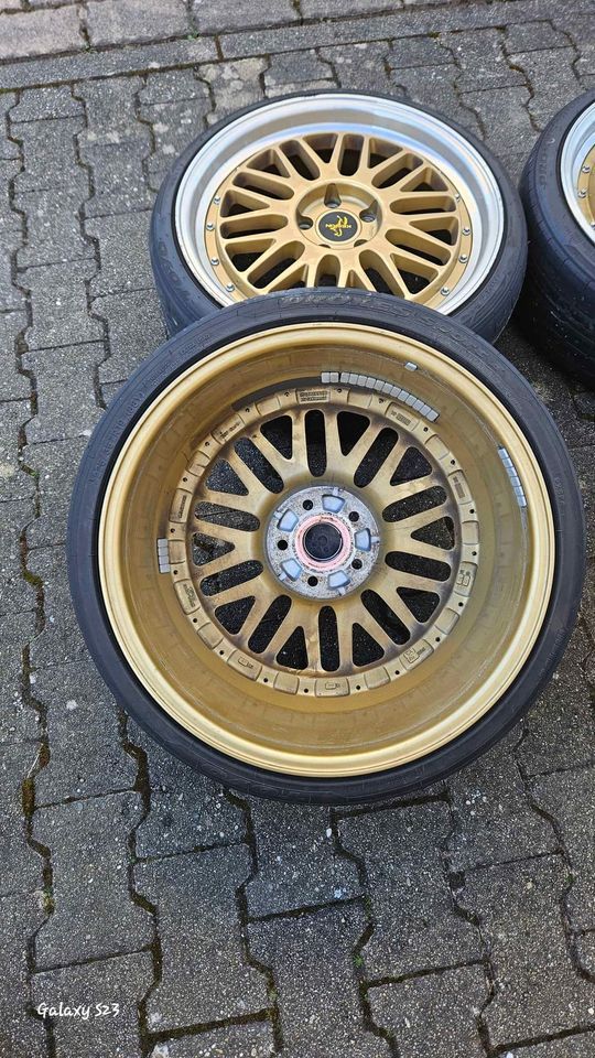

  • #36 20470265
    lukaszsar
    Does a large number of wheel weights matter after tire balancing?
    I have to buy such rims at a good price, but I am worried about the number of weights
    According to the description, the rims are 2 years old and the tires are worn out. rather impossible żeby were such curves after 2 years, maybe it's the fault of these tires that so much had to be glued.
    I need some wise advice because the guy wants 2,000 for it so I don't get on mine. I will add that the rims are from Germany
    ask for advice and thank you
  • #37 20470315
    sigwa18
    Posts: 11918
    Help: 1180
    Rate: 3316
    Someone botched the balance because the weights should be in two groups on the inside edge of the car and on the outside. Now they are in 4
  • #38 20470324
    lukaszsar
    Probably a German vulcanizer :) Do you think the rim can be so crooked? 2-year-old rim? I think that the balancing on the unfastening ... and on these old tires, and the rim of a decent company, i.e. Keskin, cannot be bent in such a short time.
    Good price, new about 5 thousand, that's why I'm interested
  • #39 20478694
    kakibara
    Level 35  
    Posts: 2378
    Help: 202
    Rate: 1278
    After all, a curved rim (an accident occurs in the so-called fraction of a second) and the time from the moment of production does not matter here. After all, they are twisted so very strong ☺.
    A Japanese car with new tires fell into a hole, my rim and tire burst. It was 3 years ago. Original rims. The new one cost me PLN 2.7 thousand.
    So?
    Being in a difficult situation, I was forced to buy winter tires with rims, they were perfectly balanced, no beating according to the seller - and one had similarly glued weights from the inside, I didn't like it very much at the time of purchase, but after mounting and the route, no bad observations.
