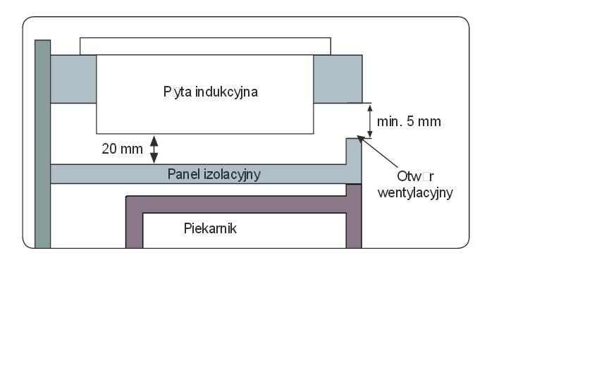

    I have a question related to the use of thermal insulation between the oven and the hob mounted above it. Recently, I have advertised a samsung induction hob that I have installed in my kitchen. The service technician had reservations about the installation of this hob - the lack of insulation between the hob and the oven, which, while heating up, may generate heat upwards and thus cause the hob to overheat (it is recommended in the manual in such situations). The complaint was accepted, but the service technician recommended the use of an insulation board for both devices. How does it look in practice? Should I put an ordinary thermal baking sheet there to reflect the heat into the oven? In addition, the problem is with the ventilation because I have a 6mm top and the vents only blow downwards, not outside the furniture. Does anyone know how easy it is to convert something so that the cooling is good? Maybe this thermal plate is enough? If so, where can you buy something like this?

    What is written in the assembly instructions? That some kind of insulation should be used?

    It says that you must use an insulation panel between the induction hob and the oven, if it is mounted directly under the hob.
    in the attachment I am sending a scan from samsung interaction

    Hello. I read in the IKEA manual that the insulation panel is mounted only as it is used under the drawer. If there is an oven, nothing is supposed to be there.

    I have no insulation, only an air gap of about 4-5 cm from the bottom of the plate to the top of the oven. Except I haven't had a kitchen for a long time, but so far nothing bad has happened.
    The Ikea manual states that the insulation panel is to provide:
    1. Items in the drawer under the hob do not heat up
    2. Mechanical protection of the bottom of the plate from sharp cutlery.
    So I think that this additional insulation is not needed, an air gap is enough for the fans to cool it down.
    It must also be added that the oven does not heat up much at the top - the heat from the oven is blown forward - through the gap between the door and the control panel. The oven itself is thermally insulated.

    The service technician who visited you seems to generate heat on his own and overheated his brain a bit :) No oven gets hot enough to damage the induction hob! Not only that, the induction hob generates more warm air downwards (e.g. into the cutlery drawer) than the oven itself. As mentioned in the previous post, the oven gives off heat by blowing it forward (the gap between the door and the control panel). The oven has a sheet metal housing, but it is well insulated under the sheet metal. No vents in the furniture next to the oven are an option! This is bullshit. Ventilation in built-in furniture only applies to the refrigerator. One of my colleagues wrote earlier that the so-called the disc separator is used only in the case of the drawer under the disc - AND THIS IS TRUE. This is the case, for example, with IKEA furniture as an additional option, a plate separator in the cabinet. It is mounted about 40 mm under the board (there are factory holes) and it is an ordinary furniture board with a thickness of 9 mm. And I am explaining to you what it is for. Well, it is not intended to thermally insulate the plates, but it is done to protect the plate from the bottom against mechanical damage, e.g. by cutlery. There was a case when a customer got stuck with a fork in the drawer under the record and, pulling the drawer out, the fork stuck under the record, making it impossible to open the drawer because the plate underneath has an irregular shape. Even if the fork is sticking out, this separator is designed not to block the drawer and not damage the disc. It is also true that the cutlery heats up without this separator, but who does it bother? If you have any questions, write to me, I will be happy to answer.
    Right - after using the induction intensively, the top of the oven was so hot that you could fry the eggs. Especially the control panel. The question is whether it will not hurt him.

    Relax, it won't hurt him. It is important that there is a minimum of space to vent this hot air from the plate and that's it. The oven itself is well insulated underneath its tin casing. You can be calm.

    And yet my semiemens oven is overheating my induction hob which generates an error. The oven fan works .... I will now insert the baffle
