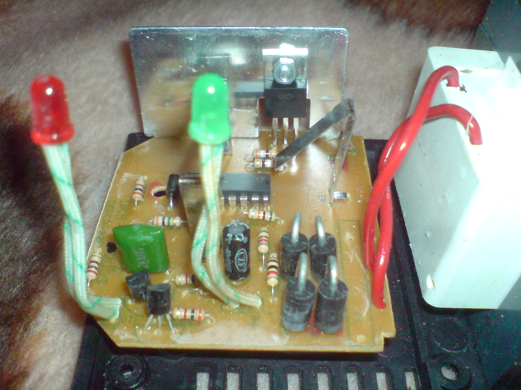

    Hello, I have a problem with the charger for the Einhell screwdriver, the original burned, I bought a replacement with the same parameters and does not charge the rechargeable batteries. There are two red diodes in the charger when it is charging and the green end of charging. In this replacement only green light shines, when I plug in, it shines a little more brightly but does not load. I measured the voltage on her output without connected aku and it was 13.25V, and I write on it that it has 18V. What could be wrong with her? Maybe someone had a similar problem? I am asking for advice on how to modify the charger to charge the batteries.
    I measured the voltage on the charger between: + and the center 17.83V; between +, - 13.25V; between - and the 4.61V measure.
    Charger parameters (replacement):
    Type: JDA-180KA
    230-250V, 50Hz, 70W
    Iwa = 2A, Uwy = 18V
    Thank you in advance for help and I am asking for advice.

    Hello, lukka8026. I probably will not help, but I have a request: The same charger burned toto bolted to the heat sink. I do not know if it's a thyristor or a transistor. In the picture I can not read the inscription on it. If you can, give it the symbol (lettering). As I mention it and let it go, I will take measurements and maybe then we will be wiser and we will launch yours.
  • #5 13220217
    sztyfcik
    Posts: 6
    Thank you. I found. This is Darlington's TIP122 transistor. Best wishes
