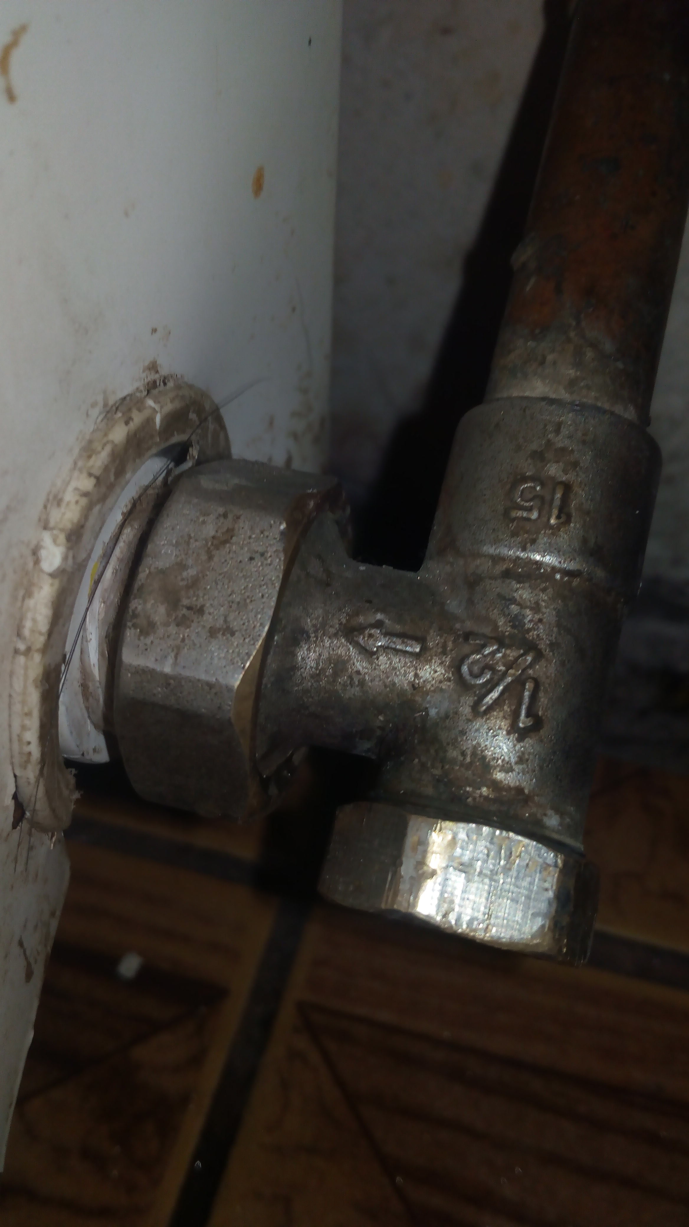

  • #33 17462723
    yeroo
    Hello!
    I will stick to the topic, because I have a small dilemma with the valve on the return (see photo) - namely the direction indicated by the arrow ... should it not be pointing in the opposite direction? Or maybe it doesn't matter?
    I have a system with a pump, or even two, but the problem with this heater was from the very beginning.
    greetings

  • #34 17465300
    W0jtek92
    Posts: 3852
    Help: 469
    Rate: 1253
    Hello. This is a return radiator shut-off valve, maybe a mistake was made in the production, I often happened that the spring return valves have a badly reflected direction pattern, so now I always test them by blowing, but since the radiator is warm and everything is ok. take over.
    Greetings.
