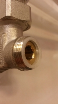

    I need information because a conservator is waiting a month here ... and that's a simple question :) The tile master dismantled the ladder radiator, it has a return valve. The heater does not heat. I loosened the hexagon on the valve slightly because I was afraid of flooding and the radiator got slightly warm. I think there was a problem here, but I don't know how much it needs to be unscrewed so that it does not pressure up. Elbow, Simplex embossed on the side. Simplex Return Valve Adjustment: Ladder Radiator Heating Issue & Proper Unscrewing Procedures Simplex Return Valve Adjustment: Ladder Radiator Heating Issue & Proper Unscrewing Procedures
    Thank you and best regards.
    Przemm

    Unscrew enough to keep the Allen key about 1-2mm below the valve body. Water may fly, which is normal. The outer nut seals it.

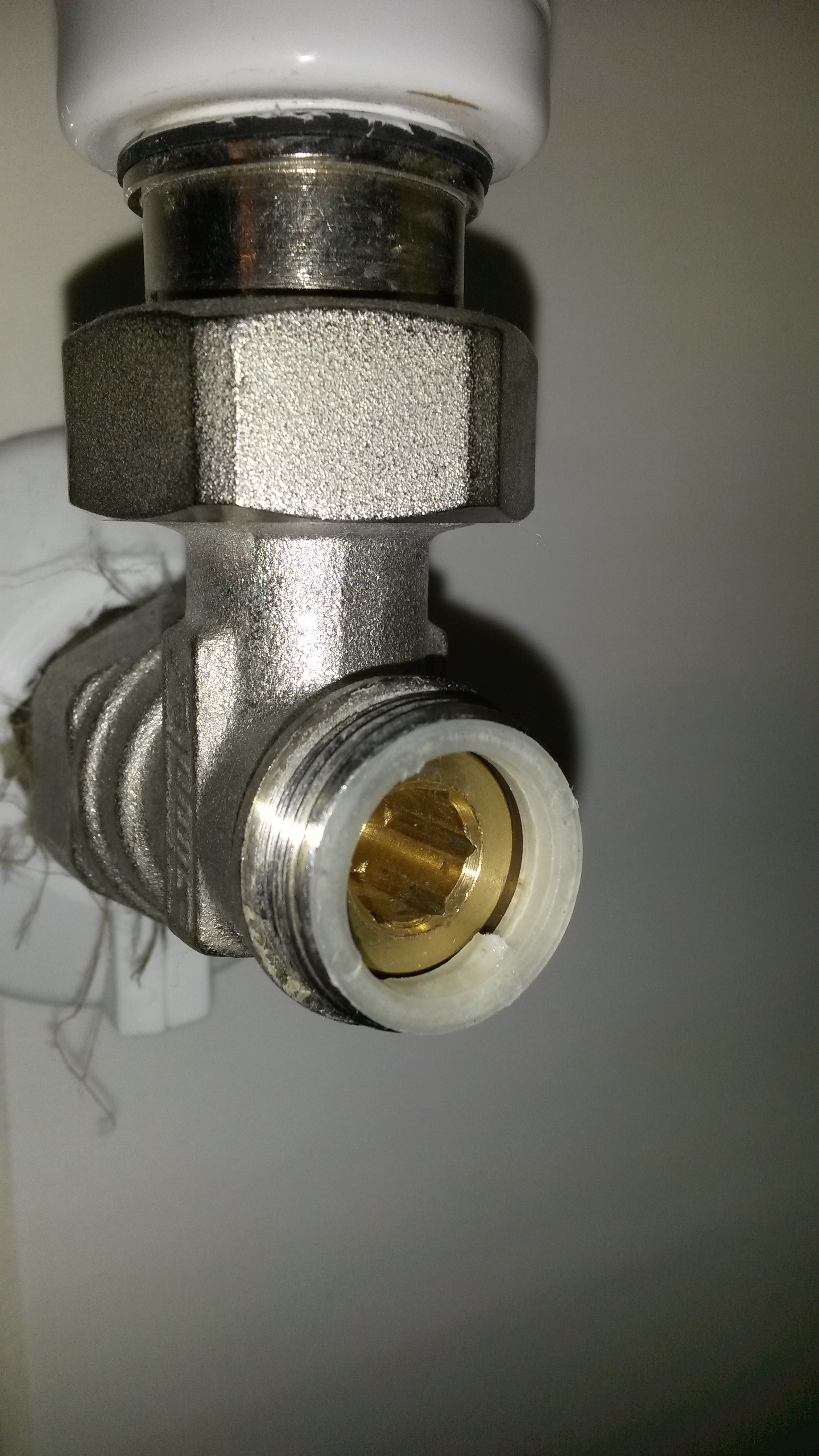

    Simplex Return Valve Adjustment: Ladder Radiator Heating Issue & Proper Unscrewing Procedures Thanks for the answer. I unscrewed the ginger as much as I could. This plastic element has a tab that locks it before further unscrewing? Simplex Return Valve Adjustment: Ladder Radiator Heating Issue & Proper Unscrewing Procedures

    Ok. Thanks for the hint. I will unscrew it for the night and see how it warms up. greetings :)

    In normal heating installations, this valve is used to equalize the pressure in the entire heating installation (not often in Poland). Fitters use it to open shut the energy carrier in.
