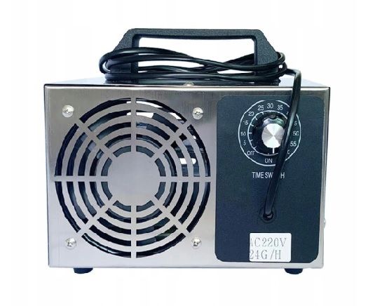

When using an OzonMaker to remove odors from a car air-conditioning system, should the air conditioning be on or off?
Use internal recirculation with the circuit closed, but keep the air conditioning/climate system off; the blower should run so ozone is carried through the ducts, while AC off leaves the evaporator unfrosted and easier for ozone to act on [#12944642] [#12944798] [#12944836] One user adds that ozone can also interact with the moisture/condensation on the evaporator, so some people use both methods depending on contamination, but the thread’s main recommendation is AC off [#13095294]

    I bought a Viaken ozonator, which has a power of only 400mg, but when it comes to the car itself, I think it helped. I did a cycle of 2x 30 minutes and it removed the stench perfectly after replacing the filter. Ozone was directed to the passenger compartment directly in place of the filter so that as much as possible hit the evaporator.

    I will step on and set the airflow to the windshield or to the feet or straight?
  • #33 18857460
    darekogarek
    Posts: 52
    I bought an OZONATOR 24g / h. How many minutes should I ozone the inside of a passenger car.

    If you actually have 24g / h, 20 minutes to half an hour should be enough.
