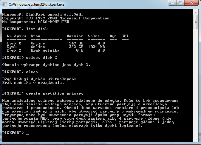

    diskpart does not detect the flash drive and neither does TestDisk

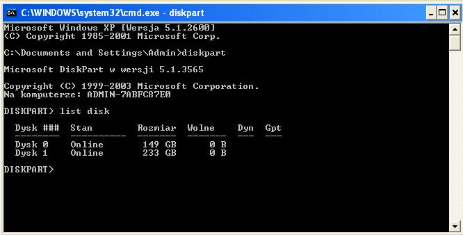

    kumcyk
    Rate: 23
    connect the flash drive to the computer run cmd.exe type (without the quotes) "diskpart" wait a moment enter the command "list disk" and you will see disk 0 disk 1 disk 2 depending on how much you have and you need to choose the one that corresponds to your flash drive, e.g. . disk 1 has 1024 MG = 1 GB as much as let's assume the connected pendrive, so you write "select disk 1" (it may be different for you) then type "clean", wait a bit and type "create partition primary" again, wait until something pops up that it worked or something, then the command "activ" and finally "format fs = fat32 quick"
    you are waiting again and as it writes that you have succeeded, you close it and the end of the pendrive should work

    So it looks like this:
    Pendrive Issue: Insert Disk into Drive H: - AX216 Flash Reader USB Device, Unknown File System
    PS: I would like to add that after connecting the pendrive the diode is on all the time.

    The pendrive does not detect anything; /
    "QCTool" or "DM 8261 Partition".

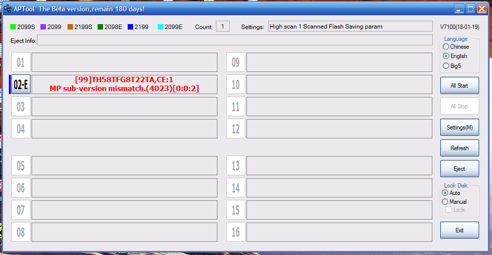

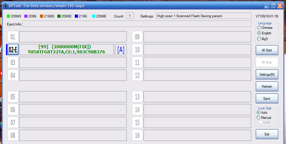

    I have a similar problem, only that the program detects me. Still a failure.
    Additionally, there is progress between these two pictures, but only 1.5% and then an error as in the picture.

    Programs for working with the logical structure will not help you in the case of damaged pendrives. There are only programs from, as one of his colleagues put it, the Ruthenian side that reigns on this forum. To select the correct program, you can use VID and PID identifiers or open the housing and read the controller marking. Pendrive repair with programs from this Russian website makes it impossible to recover data. If the data is more important than the flash drive, in case of such symptoms you should desolder the memory chips and recover the data directly from the memory ... and buy a new flash drive.
