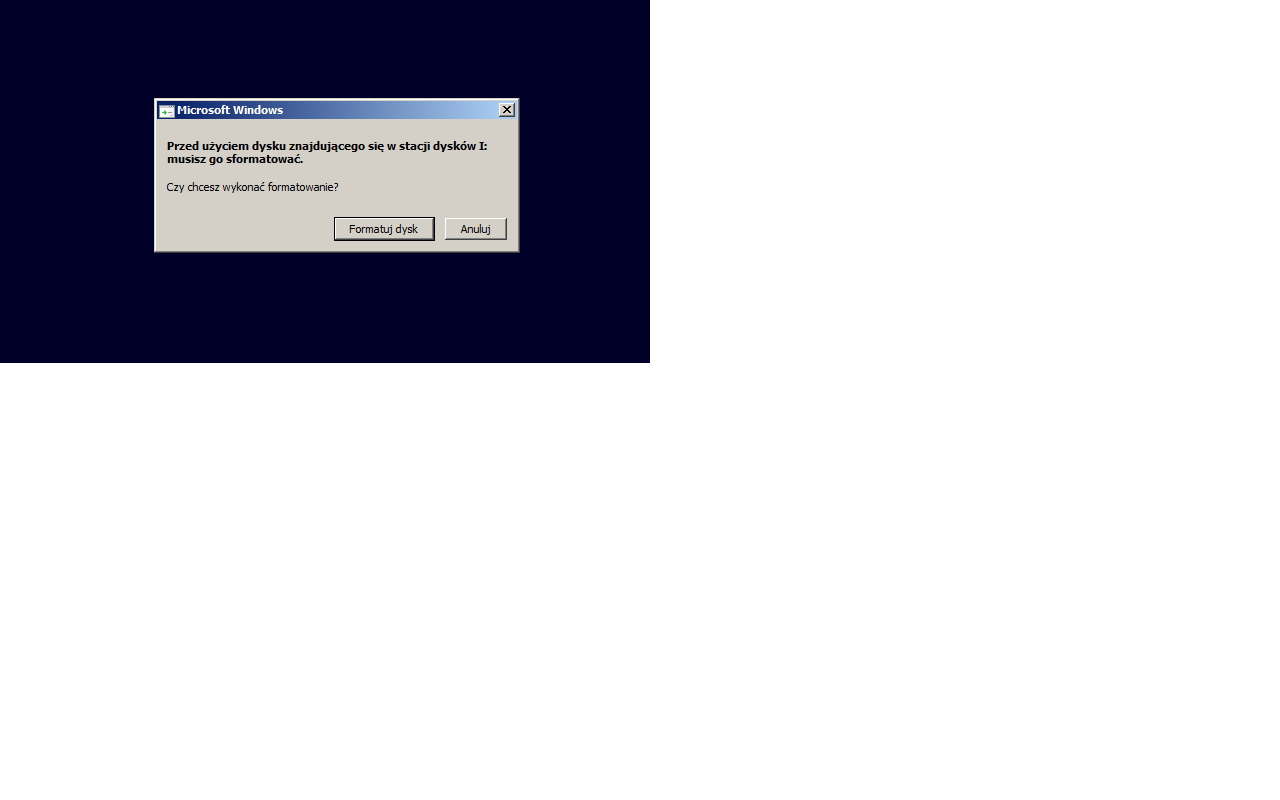

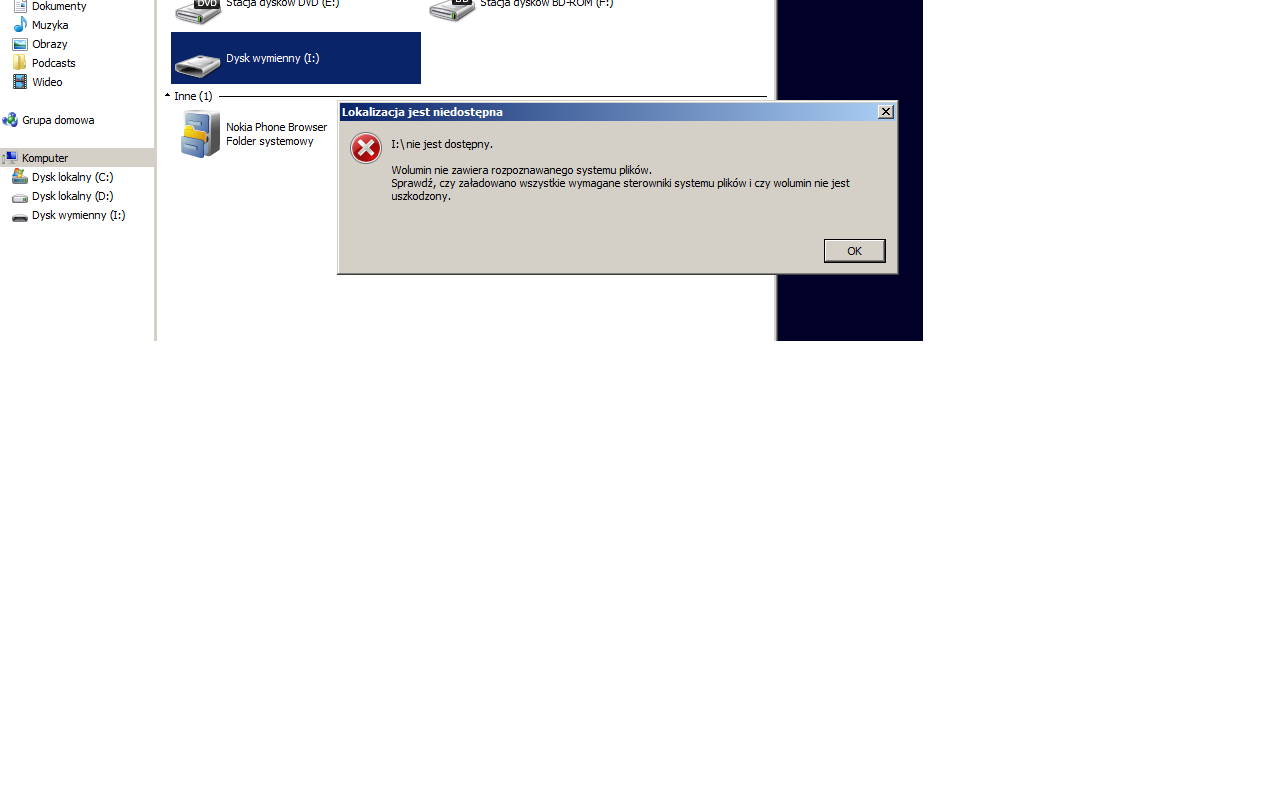

    Hi, until recently I was working with a flash drive and niz it suddenly after inserting it into the usb port it wants to format itself, and Windows reports the error "the volume does not contain a recognizable file system."
    I would like to somehow open it, because I have some data there that I need for my MA thesis, and they are only on this drive :| .

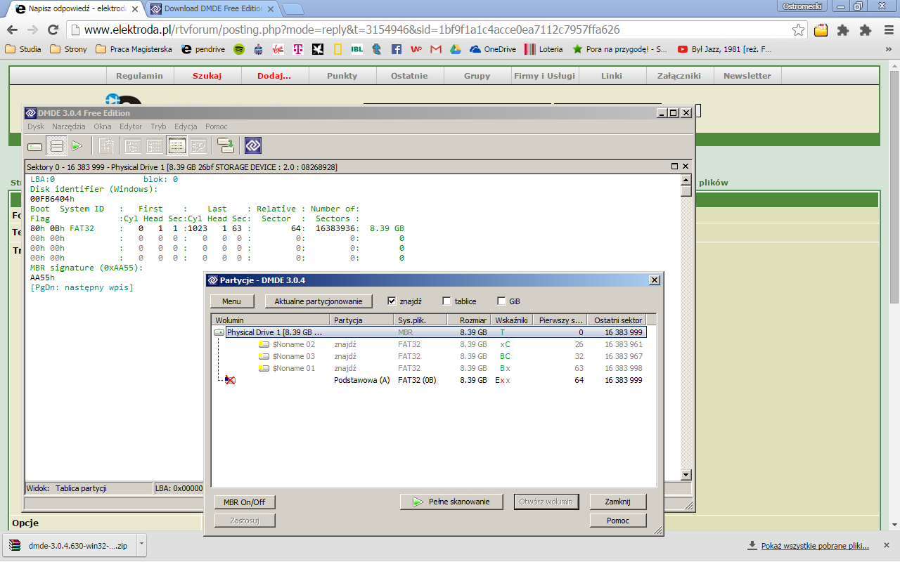

    Does DMDE throw any errors after selecting this pendrive from physical devices, or can you see the partition window normally?

    I don't know that much, if you told me what to do I would answer. When I go into cmd and dir command I:\nthere is the same "volume..." message.

    Download: http://dmde.com/download.html
    Start up, select the flash drive from the physical devices, and see if there will be errors, or maybe there will be access to the partition after skipping it, or maybe there will be access to the data without errors, or you can't access the partition on that flash drive at all. The damage can range from the simplest, to the most difficult, where you have to read data directly from the memory bone to recover something.

    wow, great! It sees something, however, I don't know what to do next to restore the things I found.

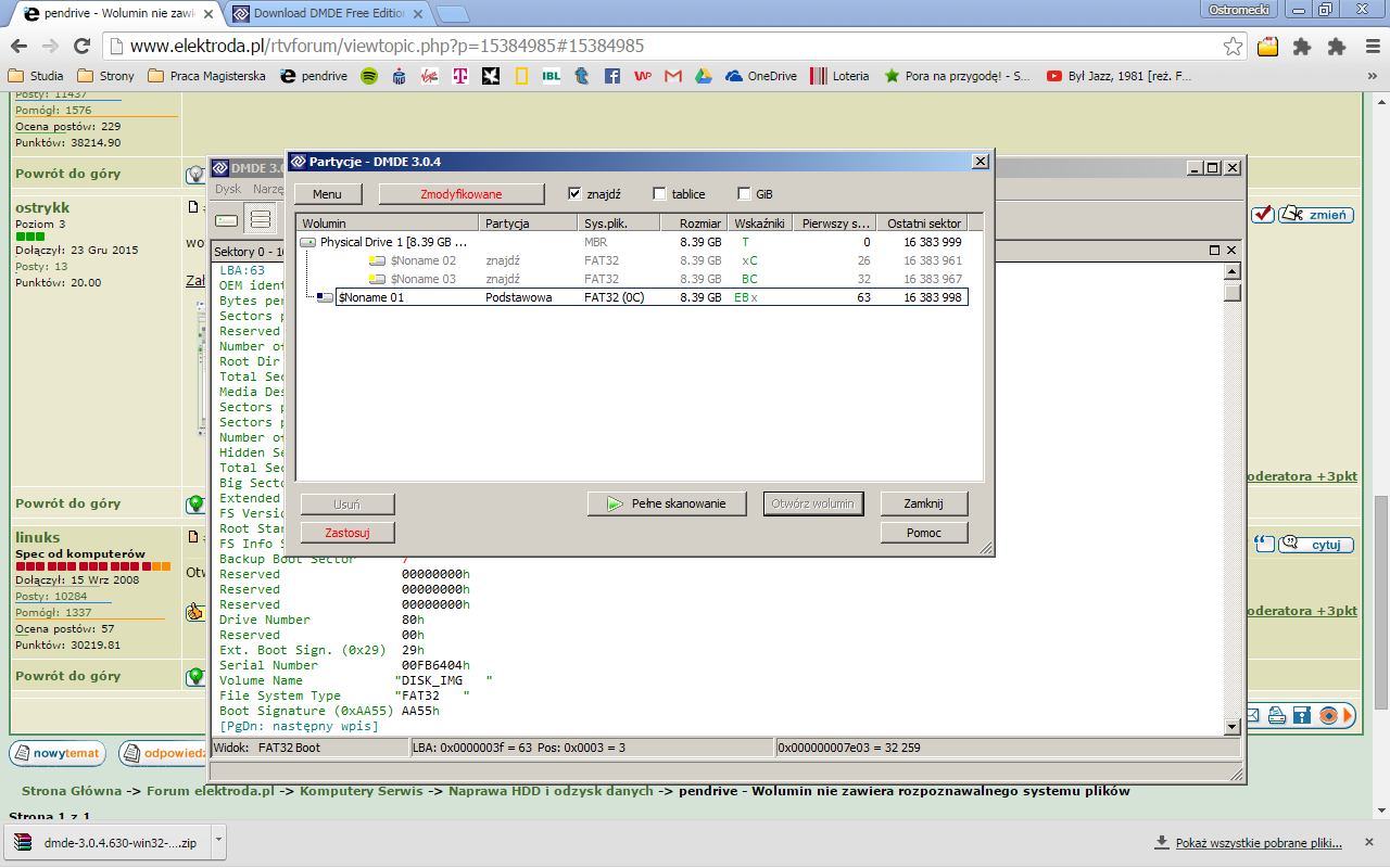

    Open noname01. If you can see the files, delete the last one (primary A ) and insert noname01 as primary. Save the changes. After reinserting the pen, the data should be visible.

    Done. What's next?

    Have you checked if your data is on it, by going to that partition and checking what it contains in $Root? If your data is: Apply, save the file to undo changes, disconnect and reconnect the flash drive. A copy of the Boot sector is missing, but it should work without it. What is on the other partitions also checked?

    Yes, on 01 there is data just like on 02. On 03 there is nothing in $Root folder.
    Added after 5 [minutes]:
    It pops up info about inserting the drive into the station (I:) , and then Windows asks to format.

    Then copy the files under Linux-live or recover in DMDE. Linux will see the files. It will be faster than fighting the fads of windows.

    Linux-live even pendrives good did not win. I have no idea what's wrong with it. DMDE helped fully. Thanks a lot for your help!
