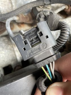

    Exactly, after the change-over throttle has a different plug and you need an adapter which costs about 160 PLN. Photo from the adapter:

    There is someone able to send me a diagram for such an engine because as I wrote earlier the scheme of the engine in iveco 2.3 hpi does not match the throttle which is the same in iveco as in ducato 2.3 mjtd. I have such an ankle (black - as above put in the picture)

    After transferring the pins in the plug according to the drawing, the Pierburg throttle instead of Wahler 7523D works, there is no error :-)
    In addition, I am posting a photo of the plugin with superior Pins
    @DoctorCar thanks a lot for your help!!!

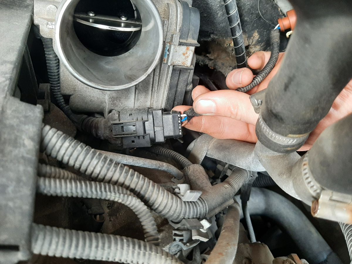

    Hello I too have a problem with the throttle in my iveco 2.3 4th gen after turning the key it makes a tiny movement.... when starting and stopping no work.... Ever since I bought the car the EDC is on, the seller claimed he changed the throttle, it was ok for a while and the throttle error came back again. My comp doesn't show the error because it's not just a bluetooth toy. I have a magnetti maareli throttle with an adapter from flat to oval like on the photo above. Which throttle do you recommend to make it last longer?
