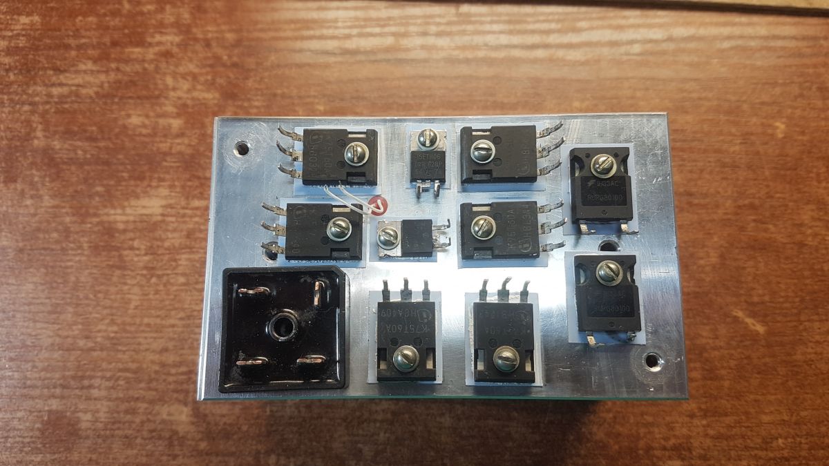

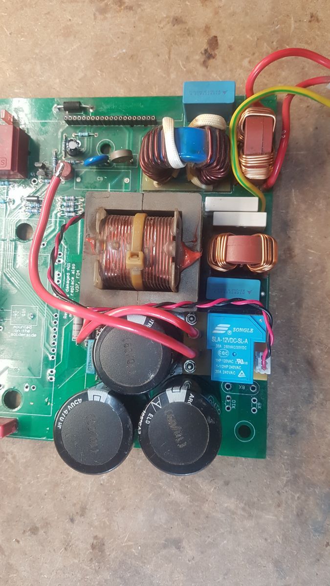

    Hello, welder as in the title. Defective power module. Can you buy it somewhere? The service has the entire power plate for a net price of 2,400. Esab module number 0349312345 DP50L600T111605 F423183 / 13071 m.
    • Where to Buy Esab Caddy Mig C200i IGBT Module 0349312345 DP50L600T111605? tmp_18758-IMG_20170706_172445263379786.jpg (2.01 MB) You must be logged in to download this attachment.
    • Where to Buy Esab Caddy Mig C200i IGBT Module 0349312345 DP50L600T111605? tmp_18758-IMG_20170707_121307-888808912.jpg (1.99 MB) You must be logged in to download this attachment.
    • Where to Buy Esab Caddy Mig C200i IGBT Module 0349312345 DP50L600T111605? tmp_18758-IMG_20170707_121253-413735475.jpg (1.88 MB) You must be logged in to download this attachment.
    • Where to Buy Esab Caddy Mig C200i IGBT Module 0349312345 DP50L600T111605? tmp_18758-IMG_20170707_115243-946994304.jpg (1.61 MB) You must be logged in to download this attachment.
    • Where to Buy Esab Caddy Mig C200i IGBT Module 0349312345 DP50L600T111605? tmp_18758-IMG_20170707_1151571074514733.jpg (579.09 KB) You must be logged in to download this attachment.

    I can try to make such a module on individual elements. I estimate the cost of the elements at PLN 250, does it make sense?

    Decode what elements you have damaged in the hybrid.
    Lead the wires from them outside and connect the new replacements.
    I do this in audio hybrids.

  • #6 16655953
    stasiekb100
    Posts: 2091
    Help: 118
    Rate: 454

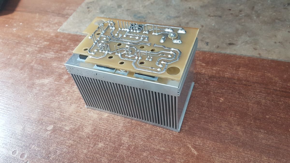

    Hello, I made a replacement for this module. Pfc works, the lower key is also working, the ZTX 949 transistor in the upper key control circuit is damaged. If someone has a bearing, please write where you can buy it. I found the ZTX 951 a little weaker.

    Thanks for the link. Yesterday I already welded it. I resisted him, it hasn't fallen apart yet :-) . It remained to protect against filings.

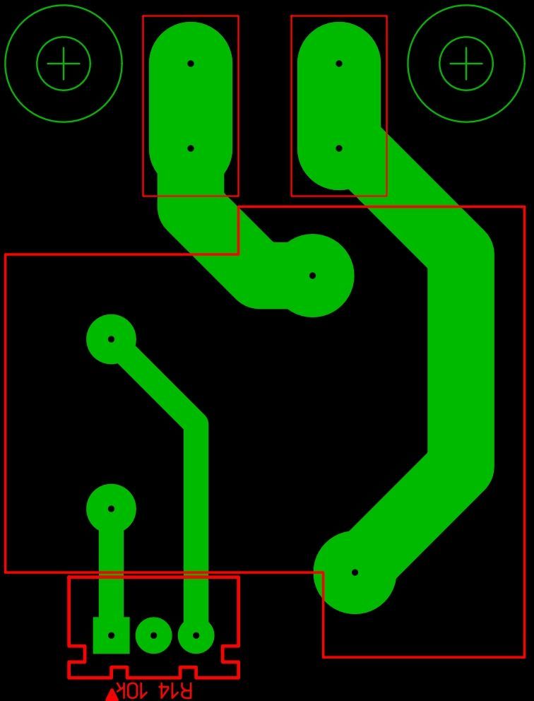

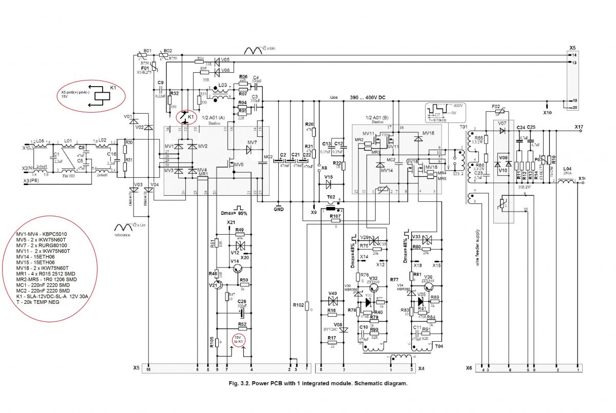

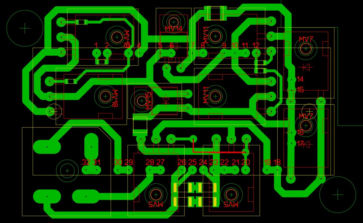

  • #21 20912439
    Alex_Ro
    Electrical schematic showing a power PCB with one integrated module.
    Printed circuit board schematic with marked traces and components.
    Module replacement option.
    Use it.

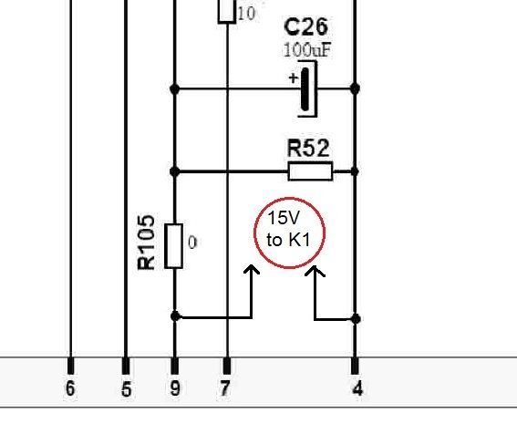

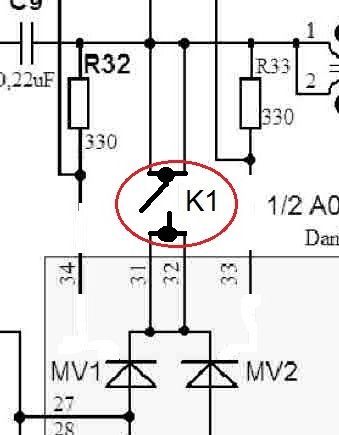

  • #22 21001183
    DaveTW
    I have the same problem with my welder. Does anybody have an actual source for the igbt module, or any other solution?
    Thanks
  • #23 21002634
    Alex_Ro
    Electronic circuit on an aluminum heatsink on a desk.
    A circuit board with several transistors and electronic components on a wooden background. >>21001183

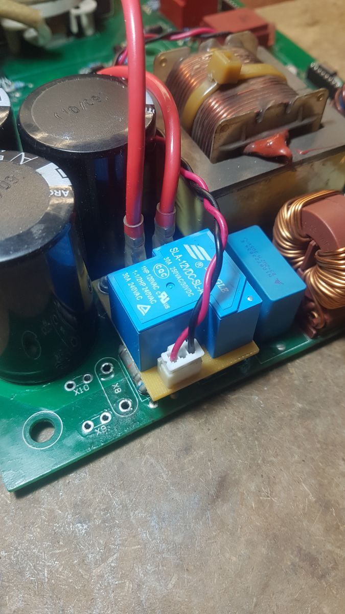

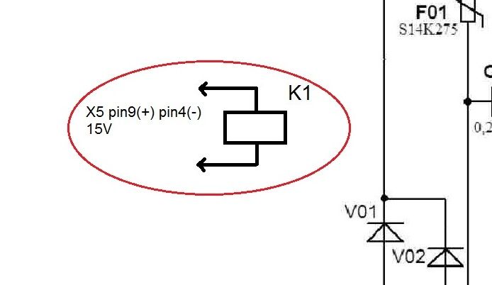

  • #24 21002654
    DaveTW
    Thanks a lot. Did have any info for the k1?
  • #27 21003519
    Telo
    Service technician RTV
    Posts: 12929
    Help: 1501
    Rate: 2325
    K1 is a 12V relay
  • #28 21374421

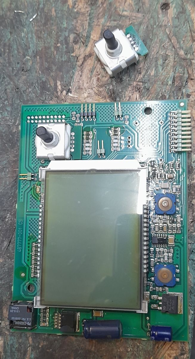

    karwo
    Posts: 1550
    Help: 151
    Rate: 360
    Anyone have any ideas for encoders to change parameters
    Damaged PCB with LCD display and two rotary encoders, one detached
    Both damaged...
