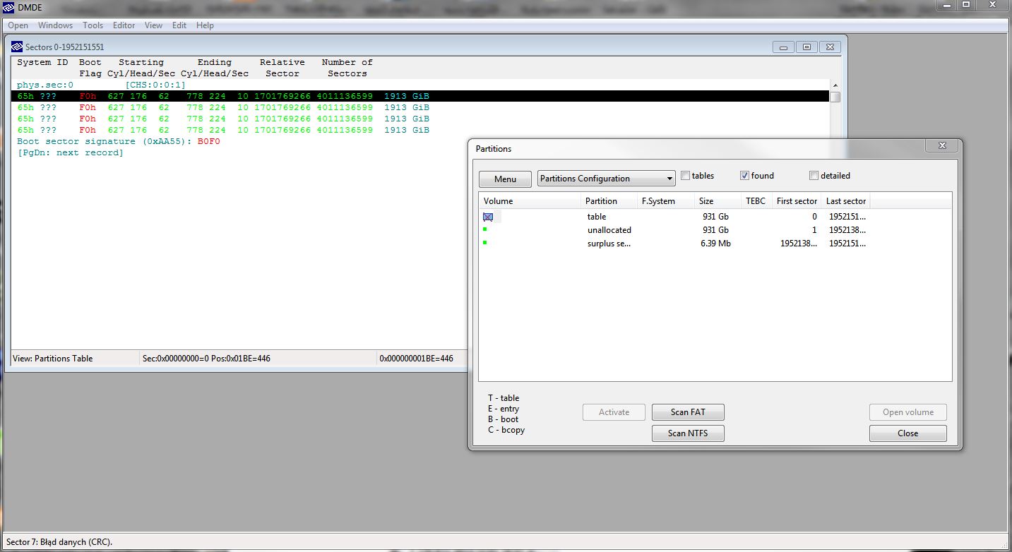

  • #11 13202620
    cirard
    Posts: 40

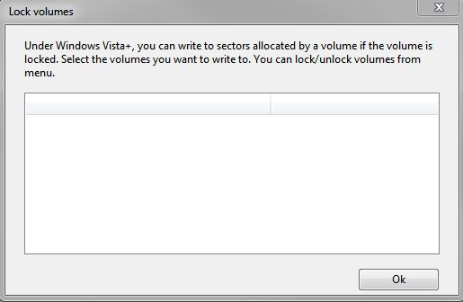

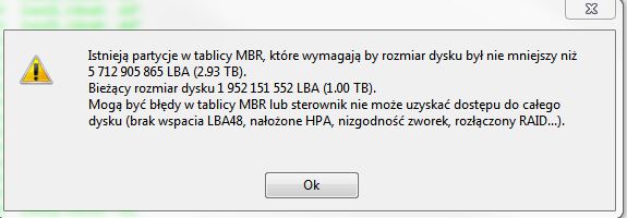

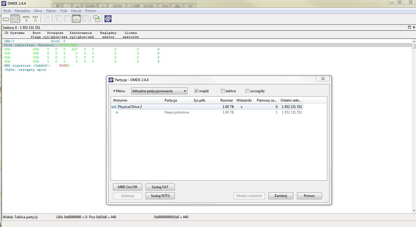

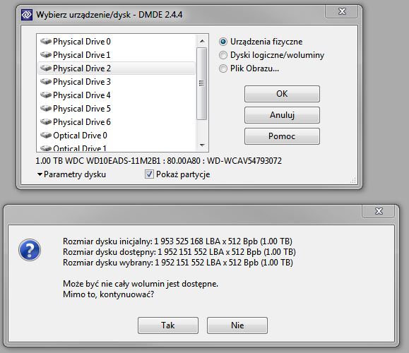

    After connecting to the computer via USB and switching on dmde.
    I got the following message:
    WD My Book Essential 1TB Not Recognized by Windows - Possible Data Transfer?
    I chose like this:
    After a while, this window appeared:

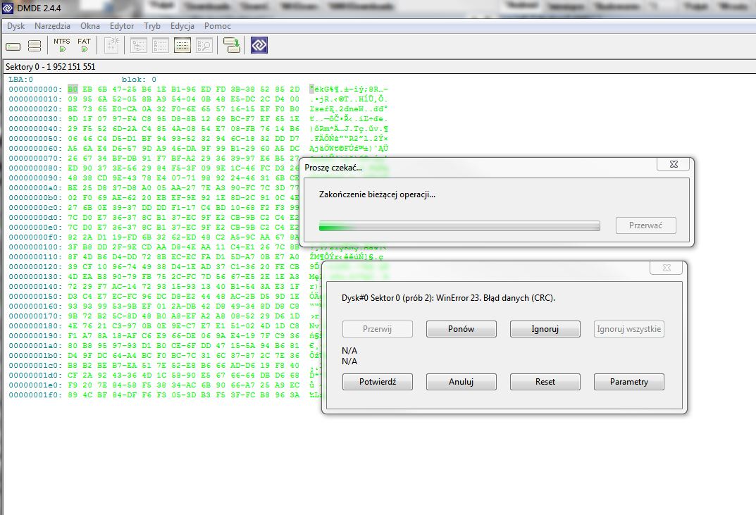

    In this case, I selected "ignore" and another window popped up:
    I confirmed OK.
    At the next error, I chose "ignore all" and after the scan I have this status:
    What should I do now.
    I don't see any recoverable partition anywhere.
  • #12 13202636
    migol21
    HDD Recovery specialist
    Posts: 10064
    Help: 1253
    Rate: 415
    Because the disk does not want to be read, which unfortunately does not bode well. The problem may be in the casing.

    When viewing the main dmde window, the data appears at
    LBA 2048 block 2047

    When running an older version of dmde I get these messages
    WD My Book Essential 1TB Not Recognized by Windows - Possible Data Transfer? WD My Book Essential 1TB Not Recognized by Windows - Possible Data Transfer?
    does that change anything for us?
  • #22 13203018
    migol21
    Posts: 10064
    Help: 1253
    Rate: 415
    NOTHING.

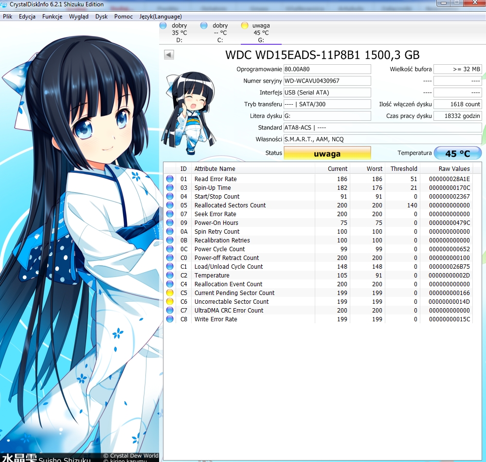

  • #23 14228893
    kret1103

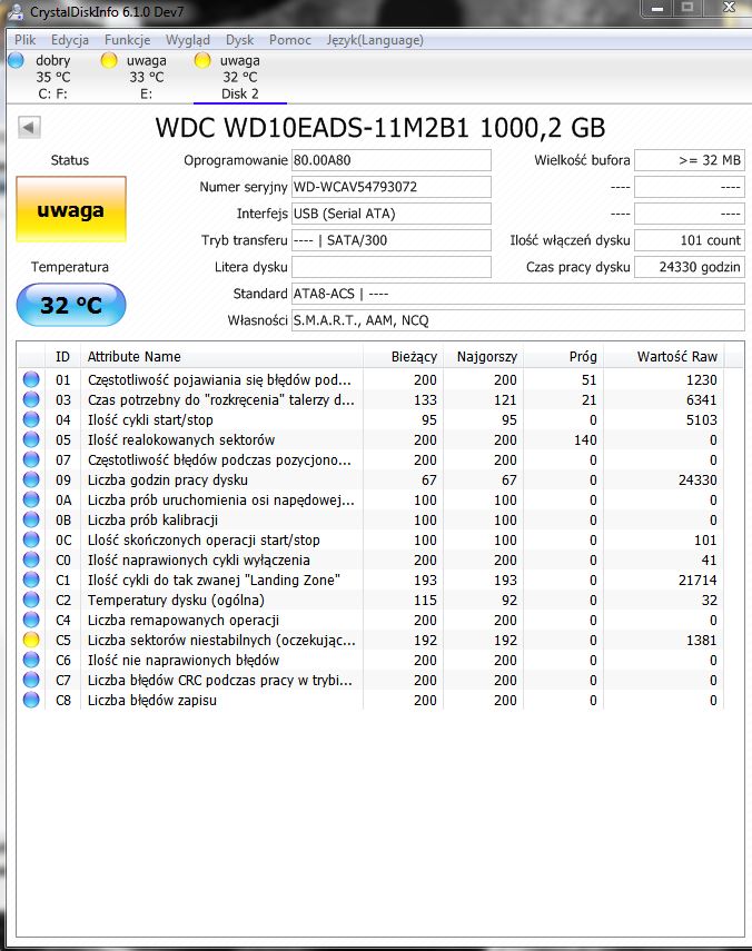

    A few years ago I bought a 1.5TB My Book Essential drive - parameters pasted from CrystalDIskInfo
    I had a similar situation, i recently started and it did not detect the disk. I combined in every possible way. Using DMDE in the latest free version, I made a post-sector copy as described above. Using the paid version, it was possible to recover data from the bin file.(DMDE Prof ver 2.4.6)
    Note: The DMDE 2.4.6 version saw only 1 TB of disk, so I made a copy with a free program and the recovery was done with the pro version directly from the bin file.

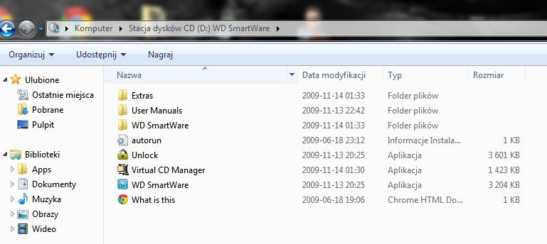

    All the time, however, the disk did not respond and was invisible by the system (I used it on windows 7 and windows xp). I downloaded a program for formatting these disks from the manufacturer's website. It turned out that the program detected the disk and was able to format it correctly. I can't post the link because I don't have enough posts, but on the manufacturer's website you will find:
    wdc-pl.custhelp.com/app/answers/detail/search/1/a_id/3868
    The disk came to life and is correctly recognized by both windows and the internal software that you can install to this disk
    that is WD SMARTWARE (generally a waste of disk space and computer memory :) )
    I also recommend installing drivers for these drives from the WD SES Driver website (if we upgrade the software to the drive, it will install this driver right away)
    Drivers can be found on the manufacturer's website
    support.wdc.com/product/download.asp?groupid=120&lang=en
    Healthy and Happy Holidays :)

  • #24 14229102
    mati211p
    Posts: 16923
    Help: 2585
    Rate: 1133
    If it's current SMART then the drive has serious surface issues.
