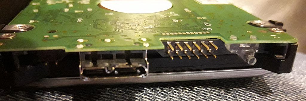

  • #7 16508463
    uomo
    Posts: 533
    Help: 14
    Rate: 36
    OK, I opened it. Unfortunately, I am away from home. I can't access any computer except my laptop. I still have a question, can this disk be connected to a stationary computer at all? Plug as in the picture Post-Drop Failure of My Passport 1TB External Drive: Windows Detection Issues

  • #8 16508563
    laptokowiec
    Posts: 1520
    Help: 112
    Rate: 120
    these are drives with USB interface only
    Added after 1 [hours] 9 [minutes]:
    When it is connected to the usb, does the engine work?
  • #9 16508749
    Kasek21
    Posts: 45661
    Help: 4981
    Rate: 3547
    Not that - there are different drives in these models.
    CrysatlDiskInfo shows something?

  • #12 16511244
    laptokowiec
    Posts: 1520
    Help: 112
    Rate: 120
    This is interesting, because this sata housing with a usb adapter will not fit
