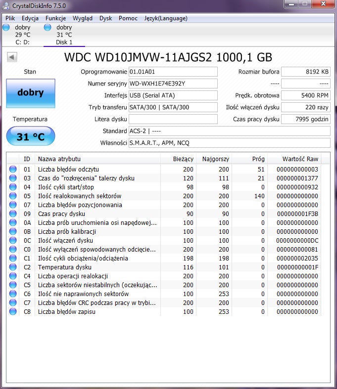

    I have a WD My Passport 1TB portable drive.
    A data backup has always been stored on the disk. Currently, after connecting to the computer, you can hear that the disk is working, the LED flashes, but does not completely detect the disk. Checked both on Windows 7 64bit and Linux Mint. How to "bite" the problem and recover data from the disk?
    I've attached a screen with CrystalDiskInfo.
    • WD My Passport 1TB Portable Drive Not Detected: Troubleshooting & Data Recovery (Win7 & Linux Mint) dysk.jpg (206.44 KB) You must be logged in to download this attachment.

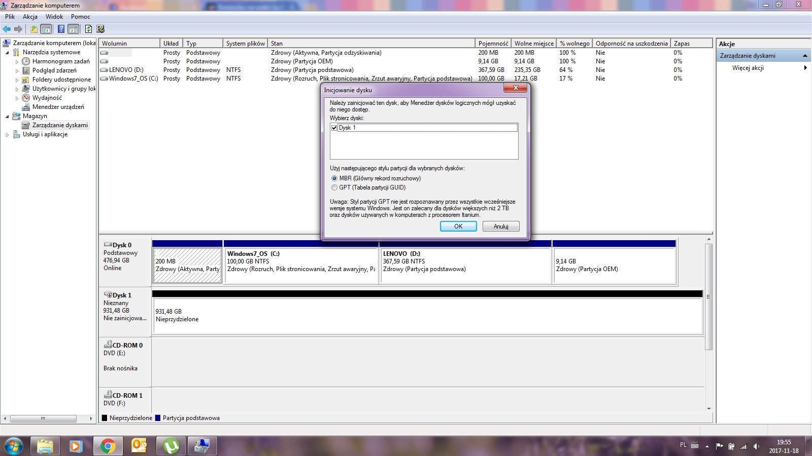

    Give a screen from Disk Management, i.e. My computer -> Manage -> Disk management.

    Disk management is, but when you try to initialize, an "I / O device error" pops up.

    Kasek21 wrote:
    Give a screen from Disk Management, ie My Computer -> Manage -> Disk Management.
    I will post the screenshot after 16.

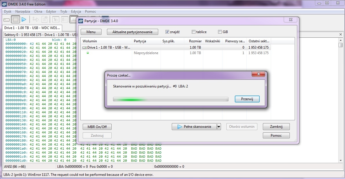

    After all, it can be seen that in Disk Management it will be visible without a partition (possibly only initialized or not). The partition table of this disk has sprung out, but rather something more and the lack of an array is the result of a failure. Show screen from DMDE from window view partitions after selecting this disk from physical devices (probably I / O error). To check on another USB cable yet. An attempt to initialize is the worst thing you can do - never initiate a disk after losing data.

    Exactly as a colleague writes above. Upload a screen from the DMDE program. All you need is a demo version.
    Only that 95% of this screen will not be thrown, or it will be empty after ignoring messages, because problems with disk initialization do not bode well. Jenak will wait for the information from the author.

    I throw screenshots from disk management and DMDE right after starting the program and after clicking ignore all errors.

    It does not read the disk completely. On another USB cable the same effect? Sure, at home, you will not get much of the disk with this disc.
