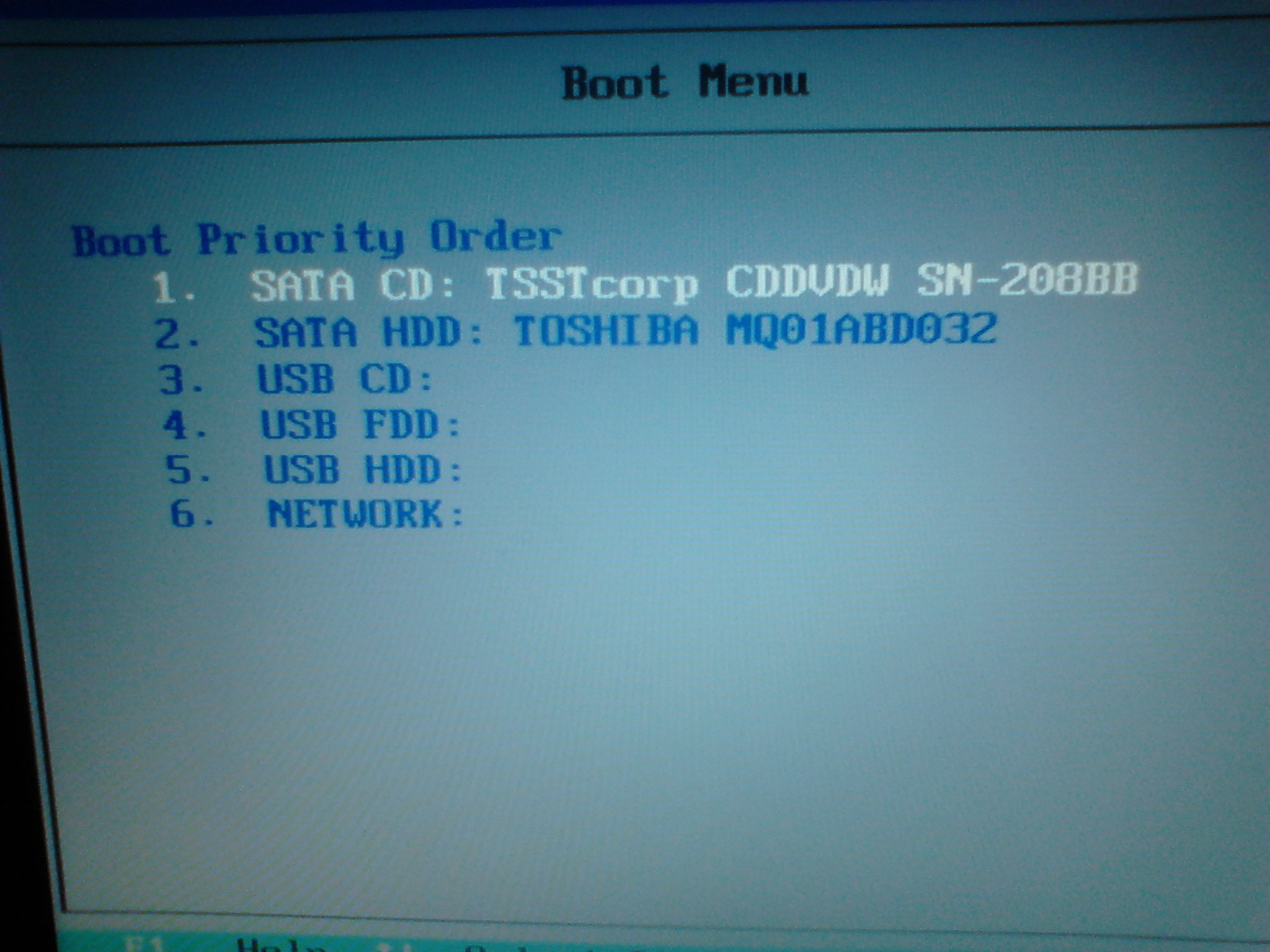

    Hello. My problem is that I wanted to install Windows 8 from a pendrive. I prepared it through the command line (commands: diskpart, list disk, select disk, clean, create partition primary, active, format fs = fat32 quick, assign), then I copied the files from the CD to the pendrive prepared in this way. And when I wanted to set it in the BIOS, I noticed that it did not see the name of the pendrive (photo), and so I set it to 1st place. Unfortunately, the installation does not start when the computer is started, but the system starts up immediately. And my question is what to do to start USB booting.

    My way, you should set USB HDD first.

    You're right. Only before starting the computer and entering the BIOS, the pendrive should be already connected. If it does not, you will not be able to set the USB HDD as the first one.

    Depending on the motherboard, the pendrive can be seen as a hard drive, see if it is not there in the hard drives tab.

    Also once I had problems with the installation on a computer with USB.
    As far as I remember correctly, I set up the bios start somehow atypically.
    Instead of USB HDD, another option had to be set. I don't remember now.
    Try to set up USB CD or FDD.

    Here it can simply be that the bios, despite its function, is not able to force the start of this device. First make sure the flash drive contains a working boot loader.

    In that case, your bios is not able to handle such a function.

    Here you have a fragment of the BIOS description (booting).
    I don't know English, but in order to set booting from USB you need to select "Fast Bios" in the "Advanced" tab.
    Marked box in red.
    I hope it will help.
