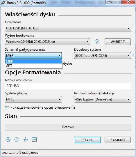

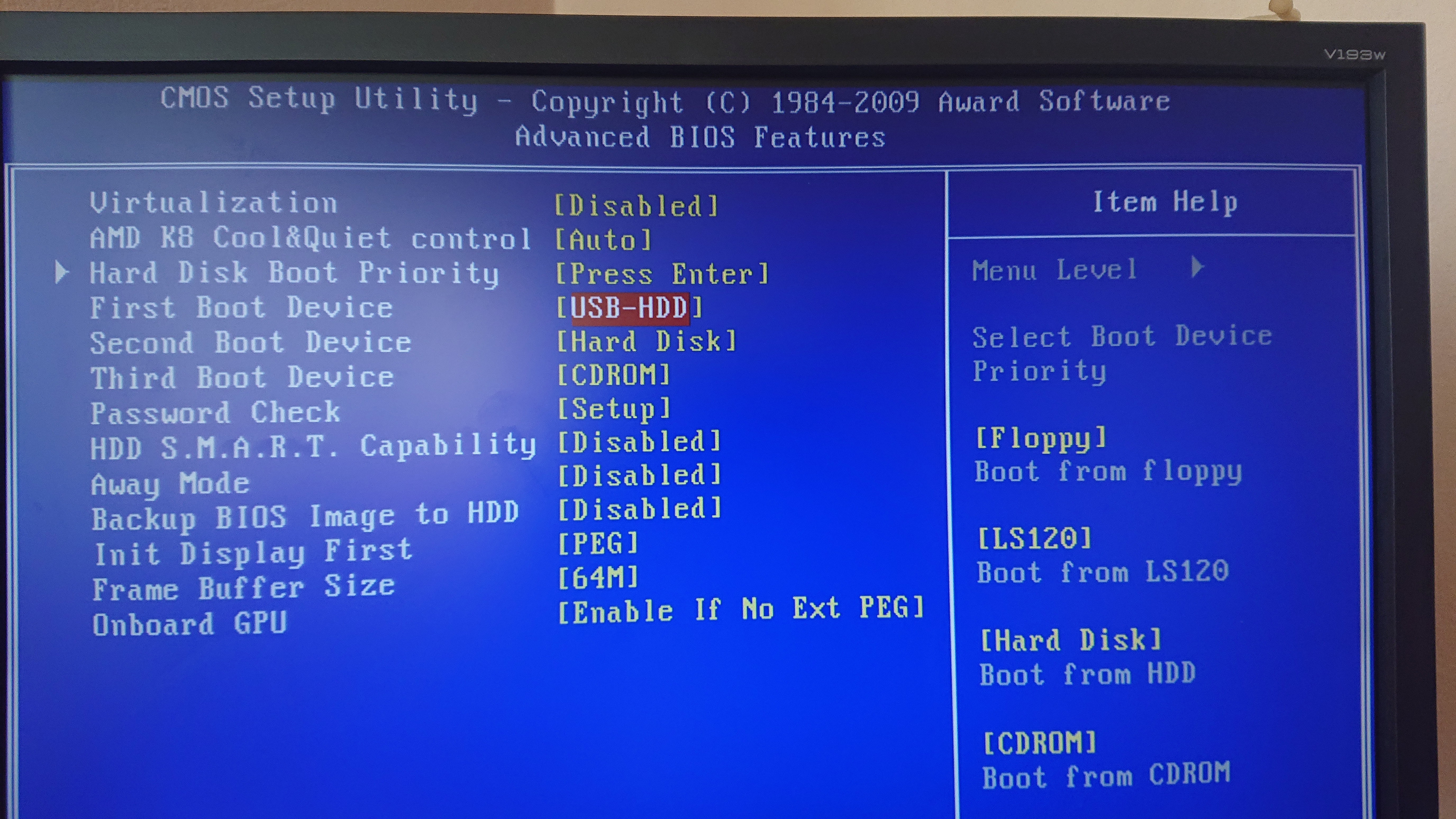

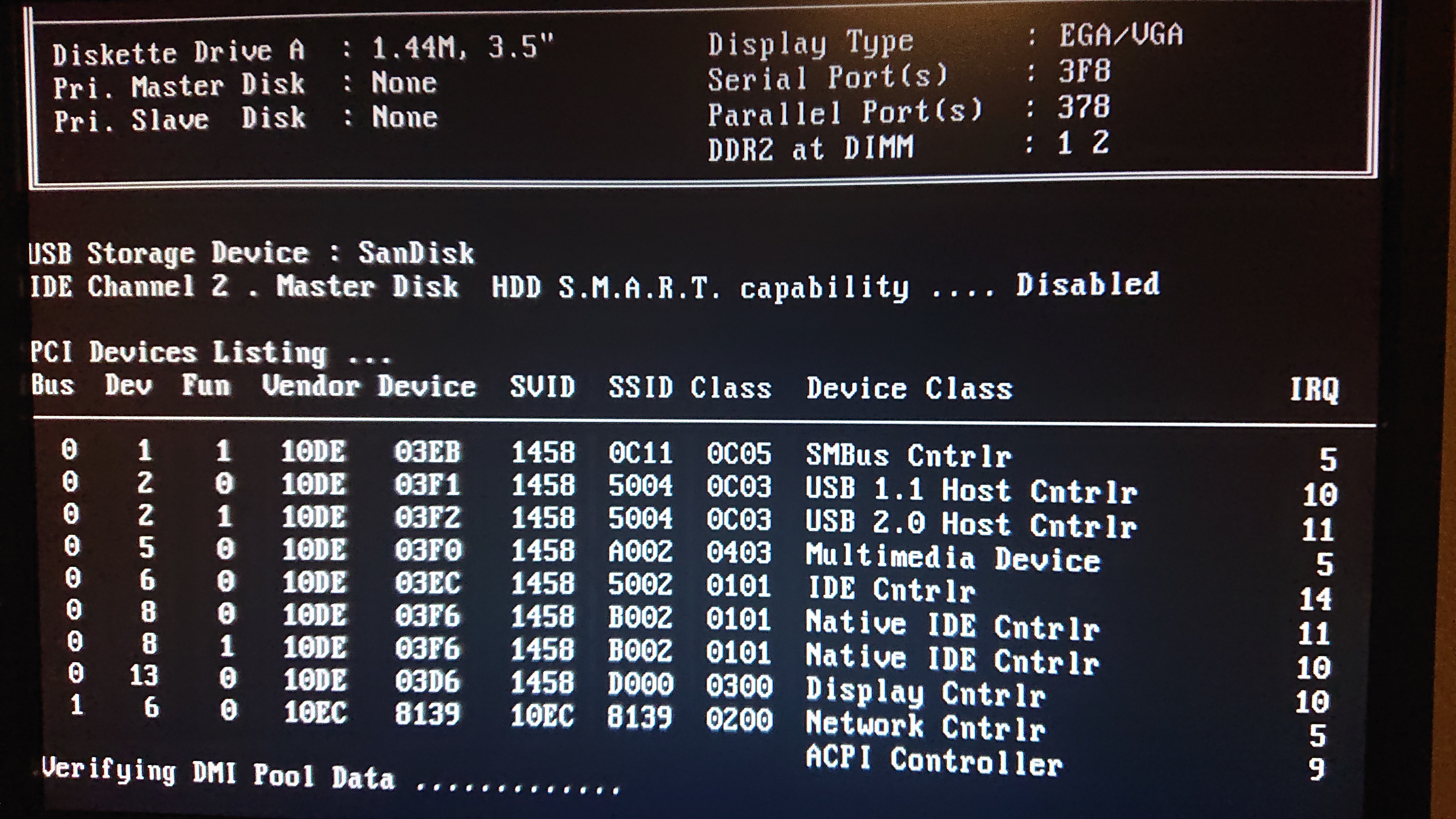

    The situation is that I had an old pc, I bought another and changed the graphics card from the old one to the new one, everything works fine on the new one, it sees the flash drive, I installed windows 10, and when I want to install it on an old pc (Gigabyte M68m-s2p motherboard, pena sees but when I mark it so that it starts the system, it is still verifing data ... I attach photos from the bios, boot and boot panel, I will add that I took the battery from the bios, the pen plugged in on the back. The BIOS sees but does not boot - the flash drive works on one pc and not on the The BIOS sees but does not boot - the flash drive works on one pc and not on the The BIOS sees but does not boot - the flash drive works on one pc and not on the The BIOS sees but does not boot - the flash drive works on one pc and not on the The BIOS sees but does not boot - the flash drive works on one pc and not on the

    Tomequ123 rather, not all understandable, I do not understand enough yet, ?, malik123 in the sense that in bios set the date today? Seriously, something like this can help?
    #5 17740974
    #6 17741049
    malik123
    Posts: 454
    Help: 11
    Rate: 37
    MieloszPLPL wrote:
    Tomequ123 rather, not all understandable, I do not understand enough yet, ?, malik123 in the sense that in bios set the date today? Seriously, something like that can help?
    yes maybe see the thread i linked.
    Tomequ123 wrote:
    Set USB HDD here
    And then do the same, BOOT from that SanDisk
    If it doesn't help, then in this picture set Hard Disk and then BOOT too from that SanDisk.
    you're right, it has unset USB and they had HDD

    I checked all possible options in the BOOT menu option and the same everywhere, it is on verifing, I will try to set this date

    I once encountered such a case on older equipment that the pendrive did not move from the Boot Menu. It only started working after I set it in the BIOS as a boot device.

    The date was good, I did not change anything, the pen still does not start ... Neither manually nor alone The BIOS sees but does not boot - the flash drive works on one pc and not on the The BIOS sees but does not boot - the flash drive works on one pc and not on the

    I used to be like that. Entering boot then hdd helped. showed disks and pen. Pena needs to be moved to 1 place and saved and restarted. Of course, the pen must be connected. F8 does not choose boot order on startup?

    MieloszPLPL wrote:
    I have a system downloaded from the microsoft website and then made with the rufus program,
    And don't you have chosen GPT in Rufus? Try to switch to MBR
  • #17 17774449
    MieloszPLPL
    Posts: 25
    I have selected mbr ...

    badboy84 wrote:
    https://www.microsoft.com/pl-pl/software-download/windows10
    Why are you using rufus and not using the media creation tool? Maybe it's worth a try.
    because at the beginning I tried to upload to another pc and it didn't work for me, but I will try
    Added after 1 [hours] 4 [minutes]:
    ahh it worked !! without any problems, the installer surprised when I uploaded it via the windows installer from microsoft ... thanks for your help !!
