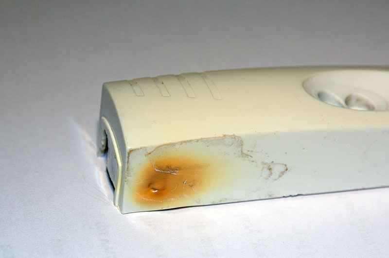

    I need to turn off the alarm completely along with the power.
    Some time ago, one of the detectors reported "sabotage" to me. I turned it off from the alarm level and thought the matter was settled. Unfortunately, today it turned out that moisture had accumulated inside and it was short-circuited. Good thing there wasn't a fire.
    I do not want to risk with other detectors and temporarily need to completely disconnect the alarm so that no voltage is applied to any detector.
    How can I do it so it doesn't start screaming at me. Is there any option in the control panel to completely disable the system (I have the installer code)? Ideally, so that later you can simply disconnect the power supply and the battery from the control panel.

    Looking at what the detector housing looks like, I have serious concerns:
    Satel Integra: Steps to Completely Disconnect Alarm and Power Supply Safely
