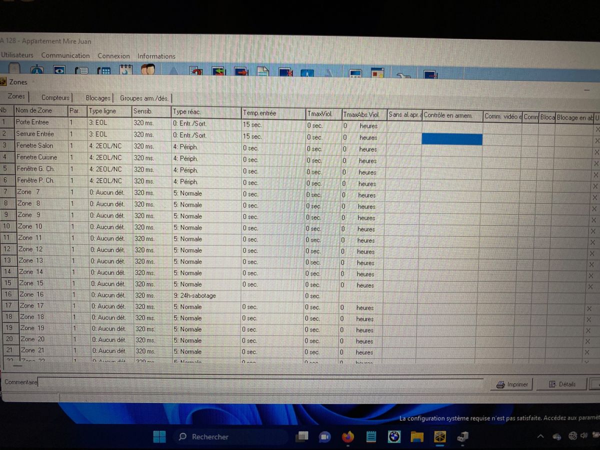

    #2 20645018
    sosarek
    Posts: 83875
    Help: 9320
    Rate: 15532
    Show zone settings, disable control on arming.

    #3 20661560
    aurea06
    Posts: 8
    Thanks for the reply.
    I tried your advice, it worked for a few days but now it works differently.
    The only thing I changed was to add a partition containing a zone that acts as 82 activate/disable that is triggered through KNX.
    If I leave it with the default configuration when activating the alarm, it reports a violation and offers to check it and bypass the violation.
    If I add the check mark as you advised to ignore the verification, it still reports the violation when trying to activate it and the only thing I can do is to see the violation, the bypass option is not available. (I tried a couple of times to check/uncheck the feature, it doesn't ignore the violation).
    As I'm in France with the French version of DLOADX, I was wondering if I am adding the check to the right column? (blue one, that was empty when taking the picture)
    Configuring Satel Integra 128: Reed Sensor Zone Violation and INT-SCR Keypad Partition Activation
    Thanks

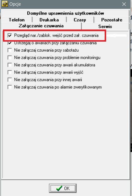

    System options control violation skipping behavior
    #4 20664302
    alster1
    Posts: 2105
    Help: 352
    Rate: 540
    aurea06 wrote:
    If I leave it with the default configuration when the alarm is activated, it reports a violation and offers to check and skip the violation. If I add a checkmark as you advised ignore verification it still throws a violation when trying to activate and all I can do is see the violation, the skip option is not available. (I've tried checking/unchecking this feature several times, it doesn't ignore the violation.)
    You're not messing around here, look in the system options.

    follow the instructions of sosarek.
