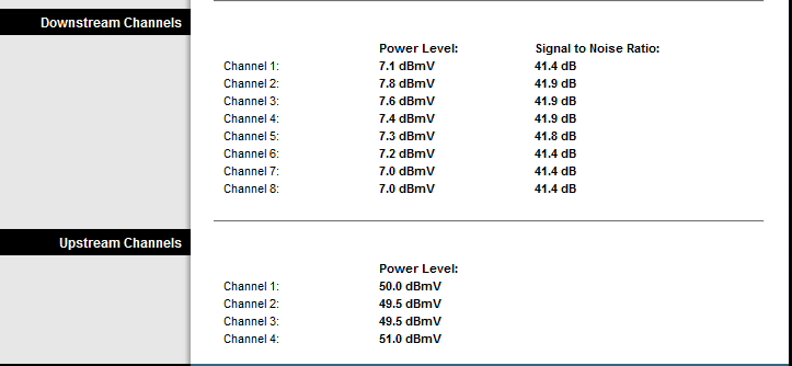

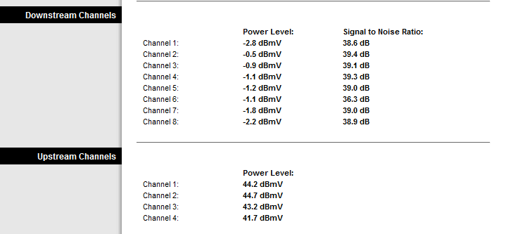

    apfelek
    I have had problems with the internet for 3 months, today he was an internet technician again. We decided to replace the router with a new one, but I have some doubts about the internet signal. Please, assess whether the parameters are correct at a 120MB / S link.
    greetings
    I have a vectre in another location and everything works fine and the parameters are completely different, but I can't interpret them.
    • UPC: Correct Downstream & Upstream Parameters - Power Levels, Signal to Noise Ratios vectra.PNG (18.01 KB) You must be logged in to download this attachment.
    • UPC: Correct Downstream & Upstream Parameters - Power Levels, Signal to Noise Ratios UPC.PNG (17.17 KB) You must be logged in to download this attachment.
  • #4 15109834
  • #5 15359079
    tomi31
    Posts: 58
    Help: 5
    Vectra - Upstram too high, UPC - Upstram unequal, too large discrepancies
  • #6 15359181
  • Evaluating 10–11 dBmV downstream, 43–45 dBmV upstream levels
