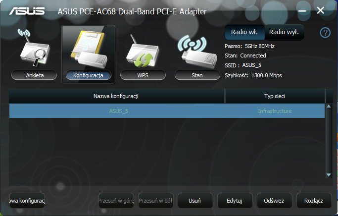

    PC away from Compal UPC 3m card Idle speed 867Mbps:
    How to check the parameters in the UPC Connect Box Compal modem
    while copying, the speed increases to 1300Mbps:

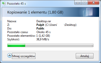

    Cable test PC LAN 1000 Compal UPC Cloud LAN 1000
    speed ? 38MB / s = 304Mbps,

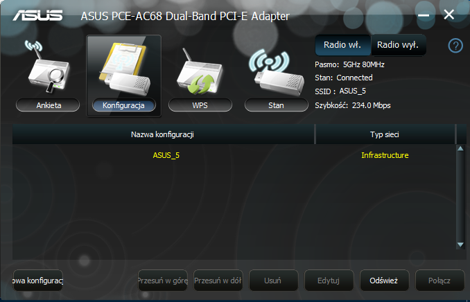

    At the end of the test, I turned off the 2.4GHz band, which resulted in a slight increase in the Wi-Fi performance of the 5GHz band.
    The speed of the ASUS PCE-AC68 AC1900 600 + 1300 Wi-Fi card away from the ASUS RT-AC68U router by 3m
    The speed of the ASUS PCE-AC68 AC1900 600 + 1300 Wi-Fi card away from the ASUS RT-AC68U router by 10m, sometimes the card accelerates to 867-1300

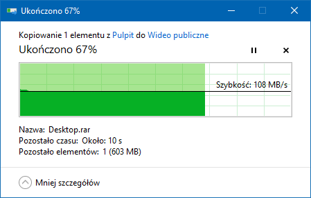

    Copying via LAN cable from PC LAN W7 ASUS RT-AC68U PC LAN W10, 116 MB / s = 928 Mbps
    Copying via LAN cable from PC LAN W10 ASUS RT-AC68U PC LAN W7, 108 MB / s = 864 Mbps

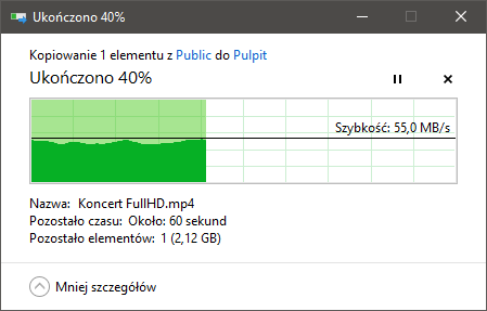

    After the LAN network, the two-way (from and to) copying and the system version do not matter much, and the copy speeds are similar (108 and 116MB / s).
    For the PCE-AC68 card, a new driver for Windows 10 ver. 7.35.351.0 Broadcom,
    I reinstalled it from the CD version ver. 6.30.223.259 ASUS and the copy speed slightly increased from 55 to 61MB / s
    How to check the parameters in the UPC Connect Box Compal modem How to check the parameters in the UPC Connect Box Compal modem
    sending remained unchanged

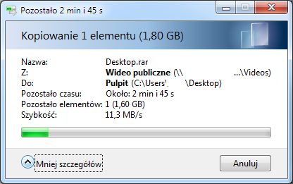

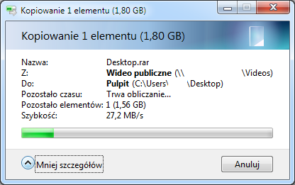

    To make the test transparent, I restored clean Systems from the backup and installed the PCE-AC68 drivers after the LAN update,
    then I checked the impact of the antivirus and firewall on the transfer speed,
    since in the previous test file transfer tests were performed with such programs.
    For Windows 7, with the antivirus and firewall software turned on, copying and sending remains at the same level (they are even slightly higher by about 2-3MB / s),
    and for windows 10, copying drops from 55-61 to 27 MB / s
    and uploading drops from 38 to 10MB / s (maybe firewalls can't keep up with constant changes of Win10 compilation, because for Win7 it doesn't matter,
    in order for the speed to return to normal, disabling the firewall will not do anything, you need to uncheck the coil in the Properties of the network card of the firewall program)
