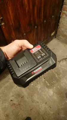

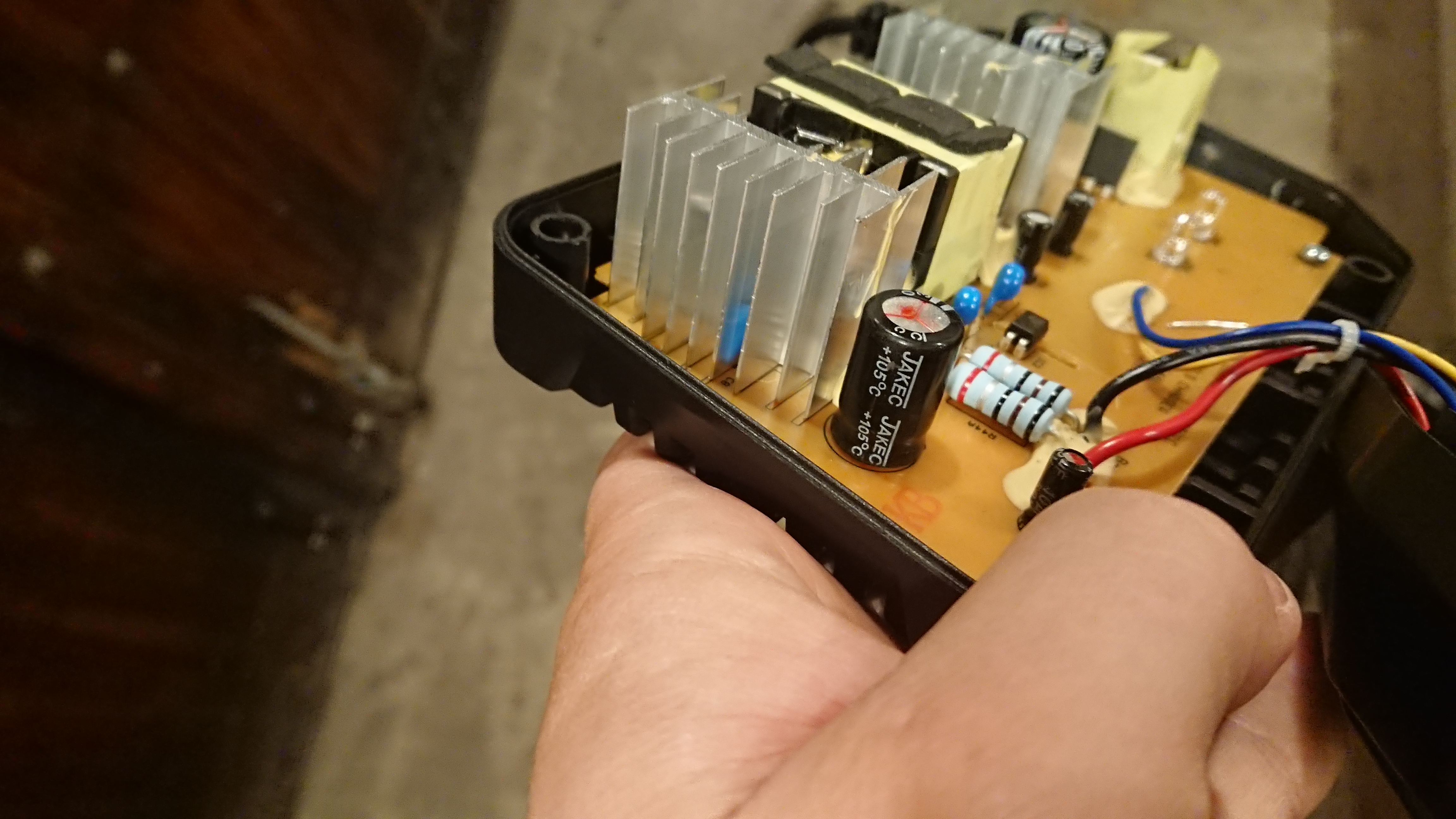

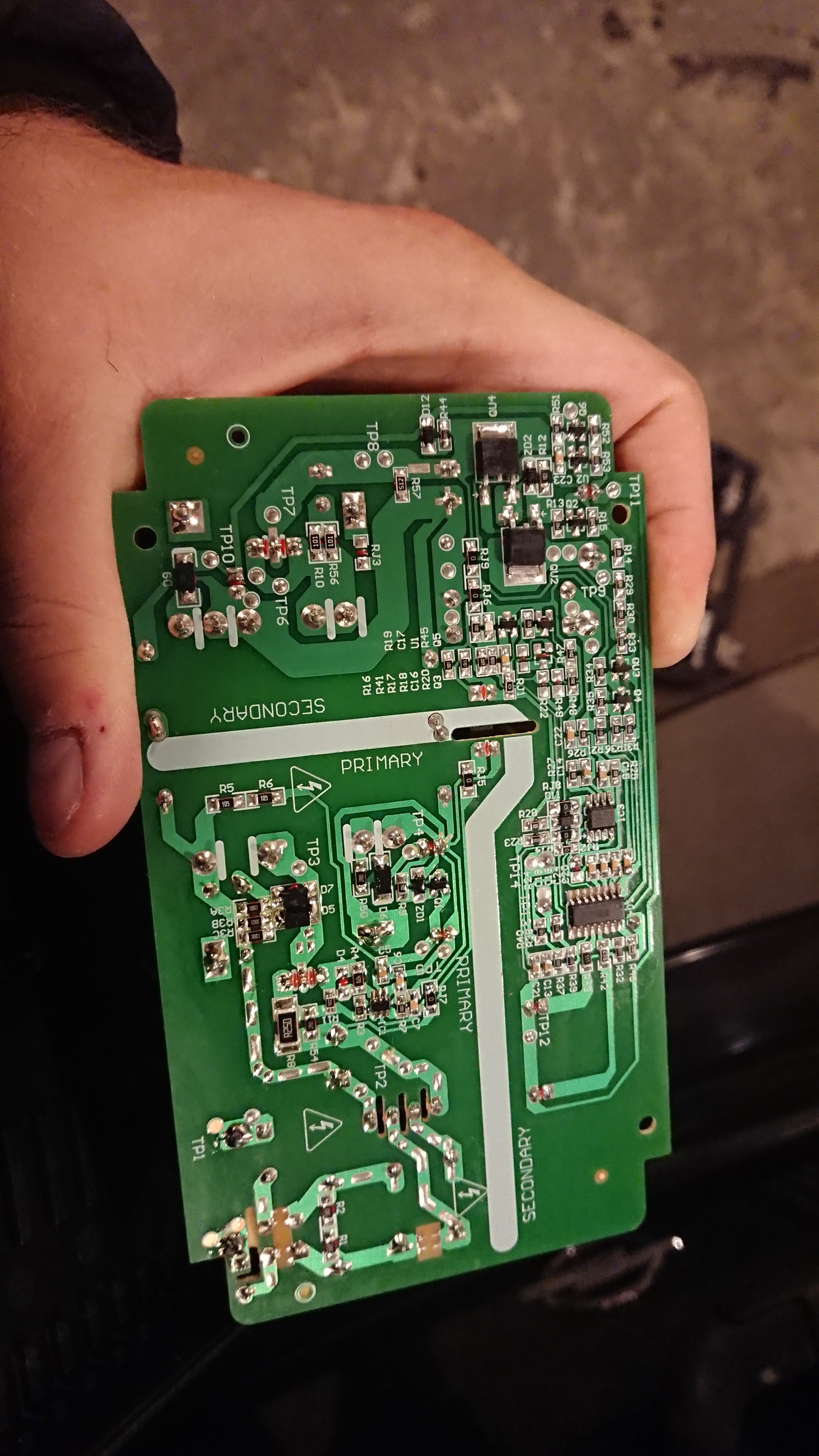

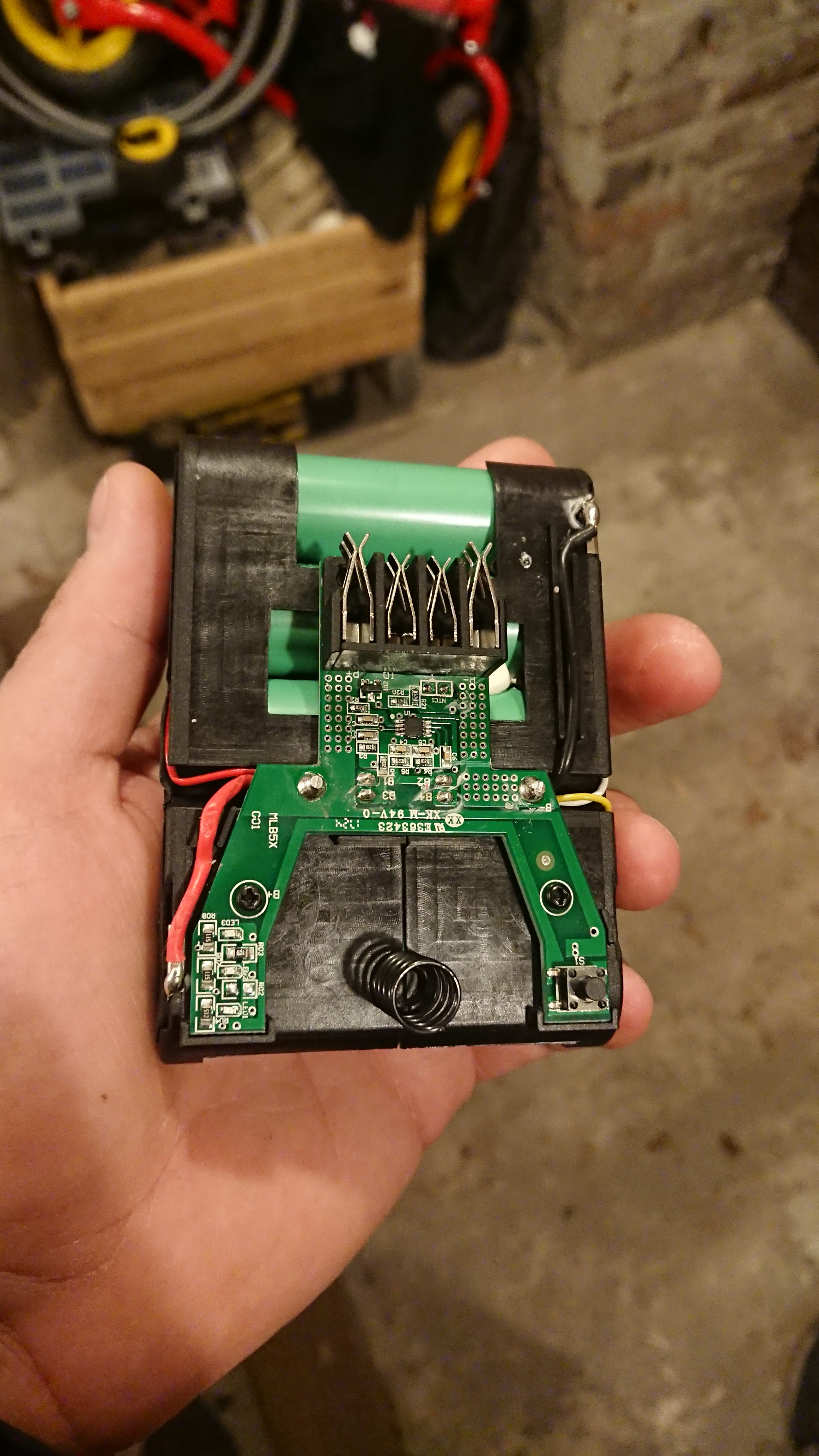

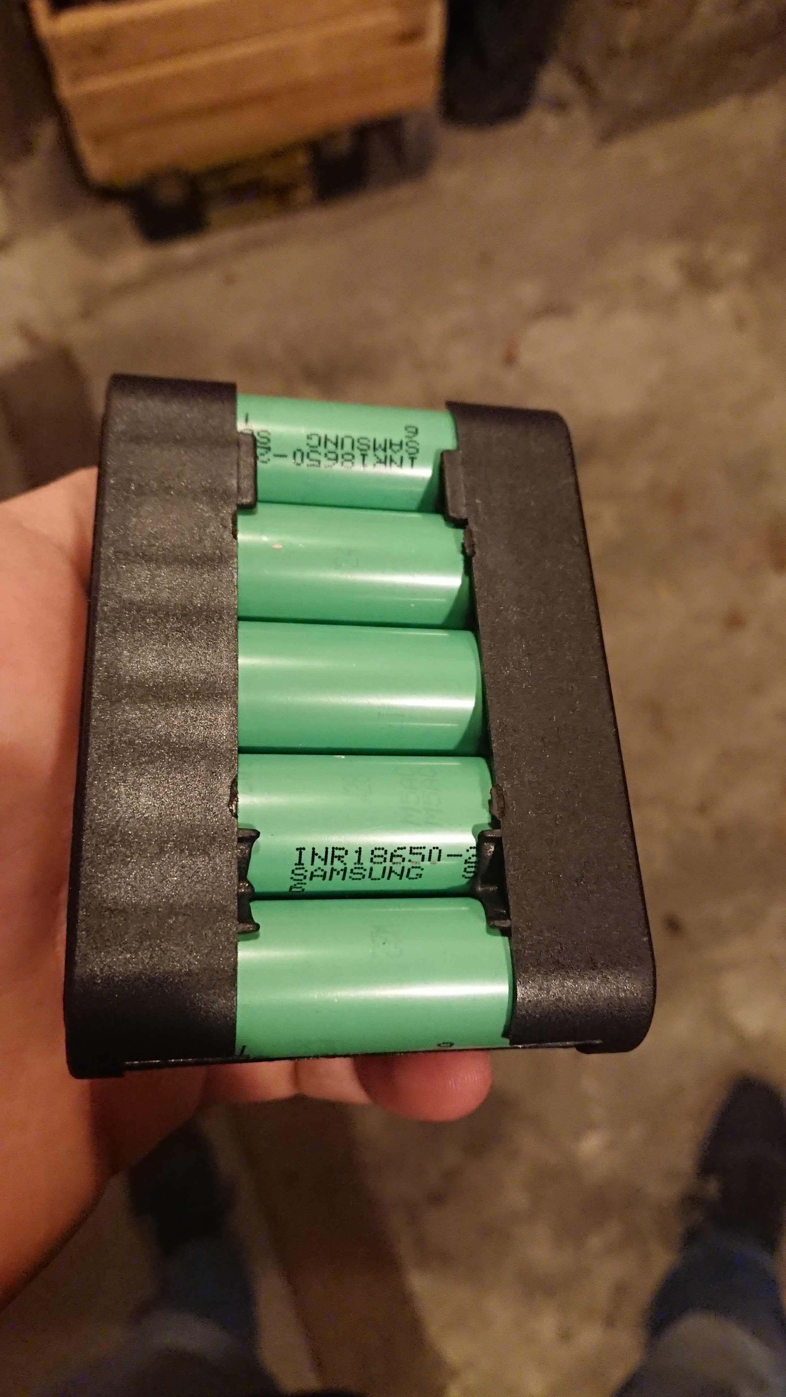

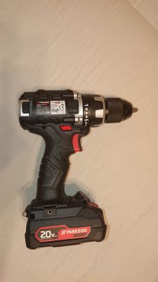

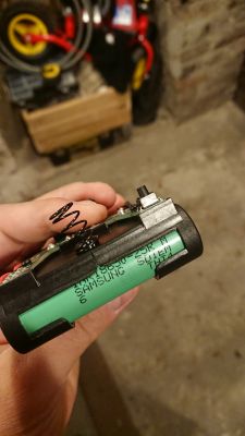

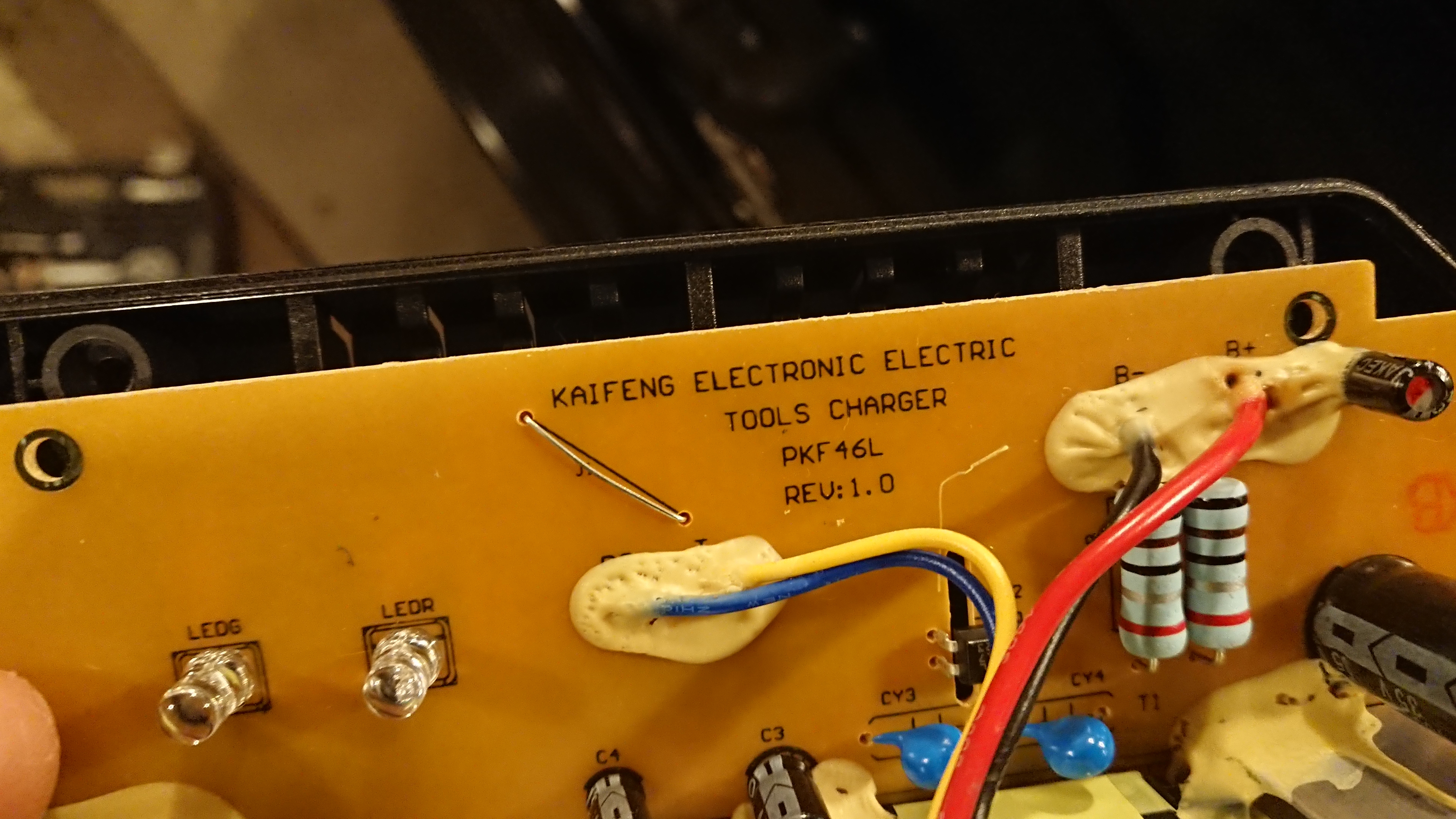

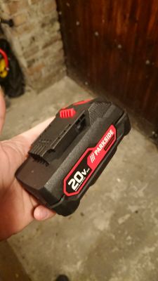

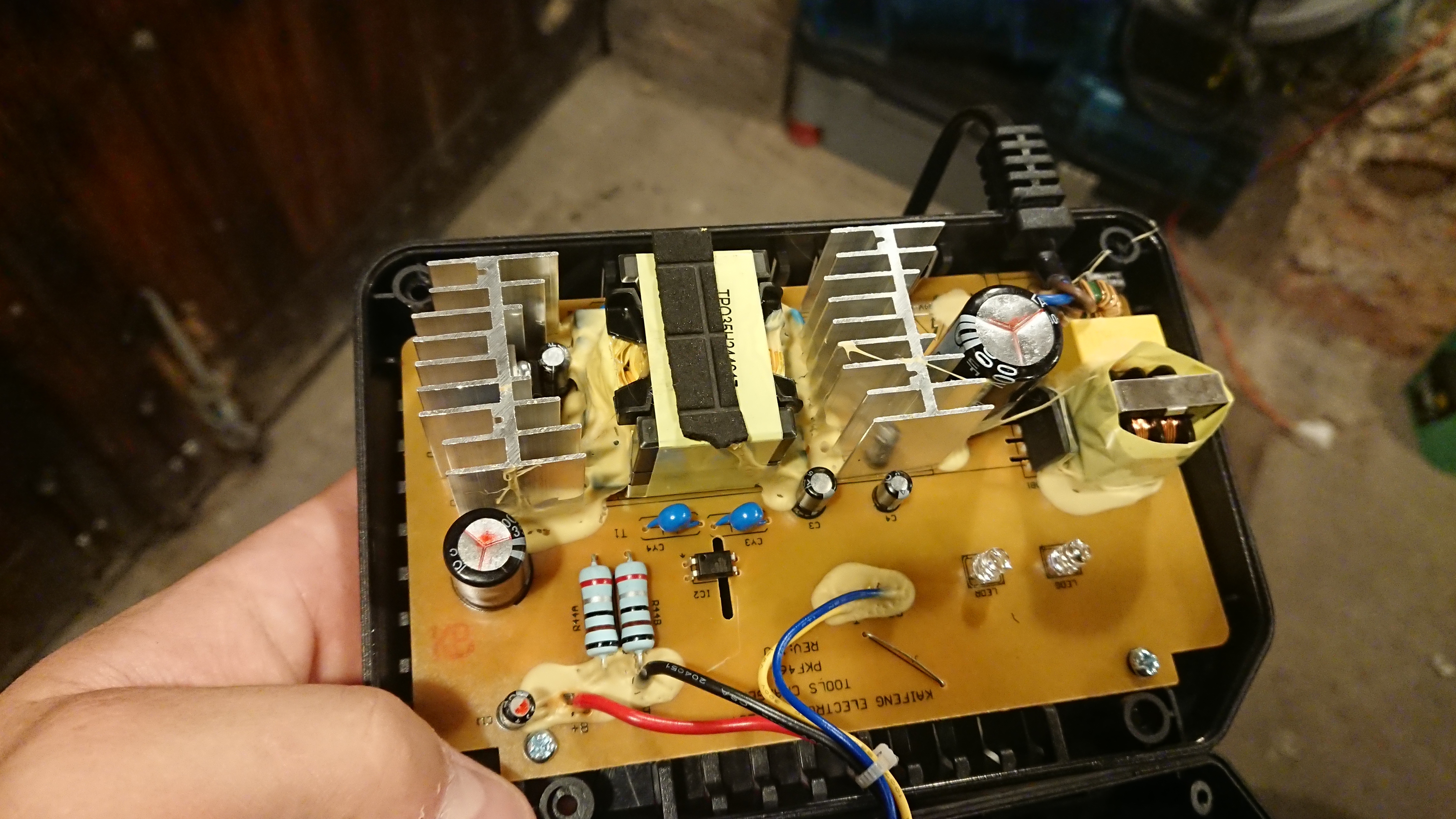

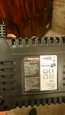

    The package arrived today.
    The screwdriver itself and the box make a very solid impression. The grip is secure, nothing flies. It is noteworthy that it is quite loud. The previous Parkside was quieter. The power is great. Looking at speed 2 with my hand I am not able to counteract the spindle rotational forces. The screwdriver is quite heavy, but not to exaggerated values.
    Battery - from what I look at quickly - good Samsung 20A cells. I don't know about her electronics.
    Charger - I have no knowledge here - if anyone has opinions about the equipment or the quality of electronics, please let me know :)

    This is my observation during use - the clutch on the 1st stage out of 21 is too weak - i.e. at 1 it is expected that even when the screws are gently tightened, the clutch will cut off the drive, so if someone plans to tighten the screws gently must take into account that he must be careful and regulate it with the trigger, because there is no need to count on the clutch.

    Today I received my copy, but it is too early to write about my impressions.
    What is your production date? It is 2017-07 at my place. It is strange that it is only now available for sale.
    I was surprised that the battery had a red line, it immediately went to the charger. I hope it will have full capacity ...
