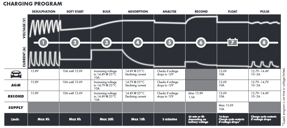

    C`TEK has a very extensive control algorithm, many chargers of this type (including C`TEK) charge with constant current in the main charging phase (the voltage increases, of course, but this is the effect of the battery charging).
    The process is described quite well here: http://www.inelco.com.pl/keepower.html
    Here from the C`TEK manual:
