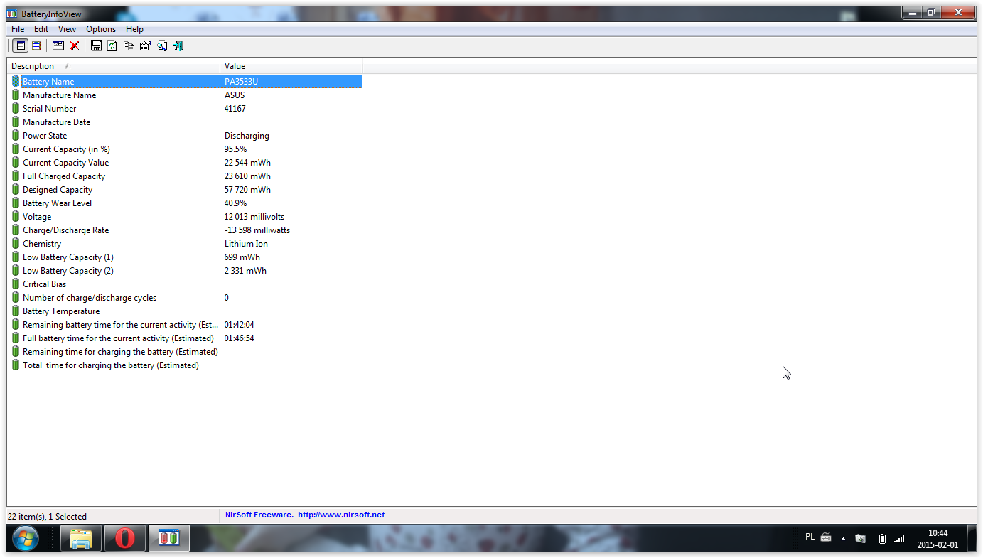

    Hello. I am also in the process of buying an Asus laptop battery. My A32-K53 battery works for max 5 minutes after disconnecting the power, even though it is charged to 100%. For 2 years, when I have a laptop, it worked maybe 30-40 times on the battery alone, but most of the time it was connected to the mains with the battery inserted and it probably killed her. Unfortunately, the original battery costs PLN 240, so I thought about a replacement.
    On the Allegro I see two sellers who sell mainly laptop batteries. They offer two batteries:
    - Green cell 4400mAh battery - green cell
    - X-Batt 4400mAh battery unfortunately I do not know if the manufacturer of the cells is the battery manufacturer.
    The cost of the battery PLN 79 and 12 months warranty.
    Maybe some of you bought batteries from one of these companies and can comment on their quality?
    BatteryInfoView and BatteryMon show this information.
