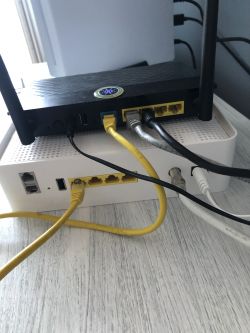

    With the new contract with Multimedia, a technicolor cga2121 modem/router was installed for me and for a few days it was ok. I have consoles, tv and a second asus router connected to it, which makes me wifi. 2 days ago the asus router lost its connection to the internet, yesterday the console and internet it is only in tv. Of course, I do not have access to the multimedia router settings and resetting the routers did nothing.

    How do you have these routers connected to each other - what ports are they connected to?
    What happens when you disconnect the Asus completely?

    Issue with Technicolor CGA2121 Router: Connectivity Loss on Asus Router, Console & TV
    Yes, I have it connected
    Added after 11 [minutes]:
    With various combinations of connections, the Internet is only on the TV.

    Either Asus for the LAN port and you make an AP out of it, or you switch Technicolor to bridge mode and put all the equipment under Asus and then Asus under WAN as you have now (the second option is better).
    Now you have a mish you have there and it is no wonder that some of the equipment does not work.

    [img-0] So it's supposed to be connected like this? Technicolor is probably in bridge mode, because it can't run wifi. [img-0]

    You call multimedia and arrange to switch to modem mode, just ask to talk to some technician / service technician and not a chatterbox from customer service who will have no idea what you want to do.
    After switching and restarting the router, you can connect your own router.

    Because when I have it connected like this, there is no internet anywhere.

    Bridge mode and WiFi are two separate things. You probably won't switch it to bridge mode, because Asus looks like some cheap toy that probably can't handle routing several hundred Mbps.
    The Asus router must be connected to the LAN port and configured according to this guide, but the IP address of the LAN interface must be changed (NOT WAN - what everyone does) and DHCP turned off: https://www.tp-link.com/pl/support /faq/417/
    However, before that, try to disconnect everything from the provider's router and connect only wired clients to it and test the operation of the services.
    Because in bridge mode, your own router needs to be properly configured, not just push the conductor.

    After changing the Technicolor to a modem, you will have to disconnect everything (Technicolor and Asus) from the power supply for at least 30 seconds, wait and connect the power to both devices again - Technicolor will get a new IP, and only then it will work with Asus.

    The current problem may be identical addressing in DHCP in both routers, in Asus you should first turn off DHCP and check how it works.
    Some routers can be used as a switch, it is worth checking if something will connect to the LAN input (yellow) after disabling DHCP in Asus.

    So I reset the Technicolor and it works for now, but the net is very slow. Is it the fault of Asus? Model RT-AC51U. Max cable speed 90 and I have bought 300.

    but the net is very slow. Is it the fault of asus? Model RT-AC51U. Speeds on the cable max 90 and I have bought 300.
    Yes, this is normal, this Asus has only 100Mb LAN / WAN ports - it will not be faster on this Asus.
