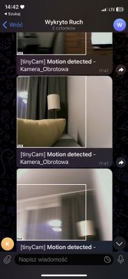

    #44 20449174
    szulcmaks1
    Soft this neo coolcam camera is terrible, emails don't work, few functions, you can't turn off unpnp (I turned it off in the router). But I have a way to get rich, find yourself an old Android phone, install the TinyCam apk (I recommend buying the pro), and plug it in to keep it charged all the time and it works as a mini recorder, you can configure notifications for telegram, email, sending to ftp, motion detection (and even people, cars or animals, it is associated with less false alarms), I use it myself and I am satisfied. You can connect a lot of cameras to this app. Seeking Updated or Alternative Firmware for Neo Coolcam NIP-02 & NIP-06 Cameras
