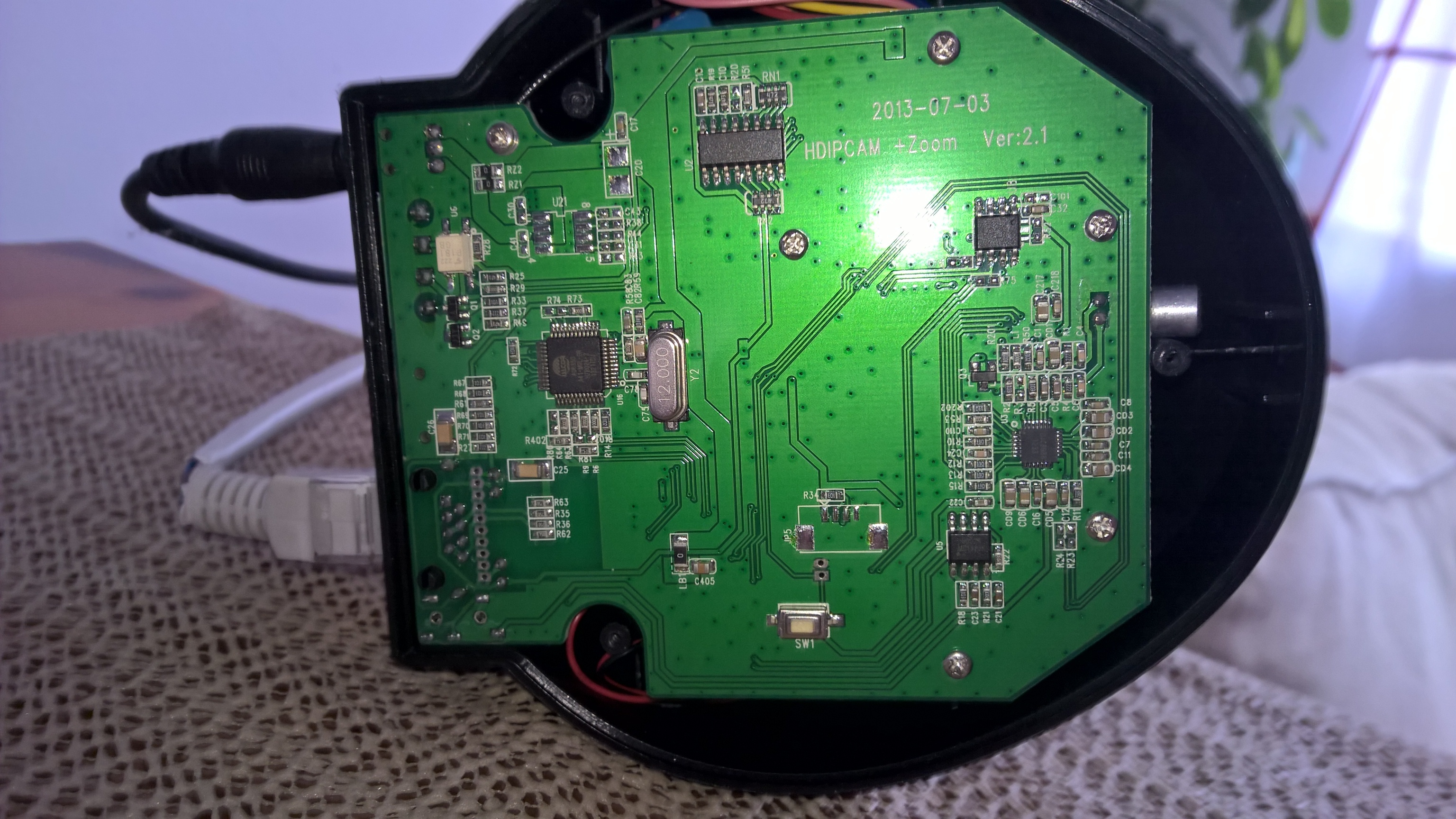

    Colleagues, I have an old Coolcam camera, I don't know how to identify it, the firmware is very old, I have never done anything, now it has been connected to the recorder but unfortunately it is not visible, can you help me identify what it is exactly and if there is a newer firmware to be uploaded maybe after the change for the registrar to see.
    Device Status
    Device ID 006E06021621
    Device Firmware Version 0.37.2.47
    Device Embedded Web UI Version 0.2.9.12

    Rate: 99
    It doesn't seem to be plug & play. Often recorder manufacturers make them compatible with their products. Usually these "better" NVRs have the option of connecting cameras via RTSP, not to mention jpg. From what I can tell, Neo Coolcam only has JPG, so it's pretty much impossible.

The PCB antenna outputs about 12 dBm; users lose connection beyond 5 m and one wall [Elektroda, halski_26, post #16005493] Switch to 2.4 GHz channel 1 or use an external AP for better coverage.

Does the OZX variant really support SD recording and image rotation?
Yes; flashing 81_2_0_157.bin on an OZX restored color and PTZ plus kept SD recording [Elektroda, jqtz3k, post #16058533]
