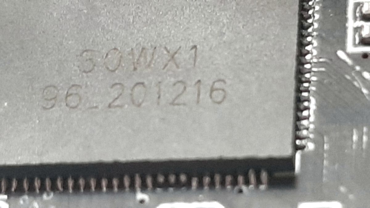

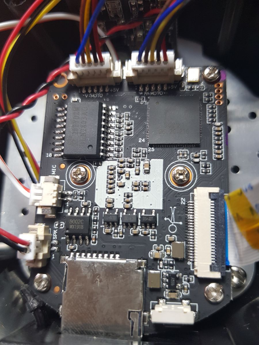

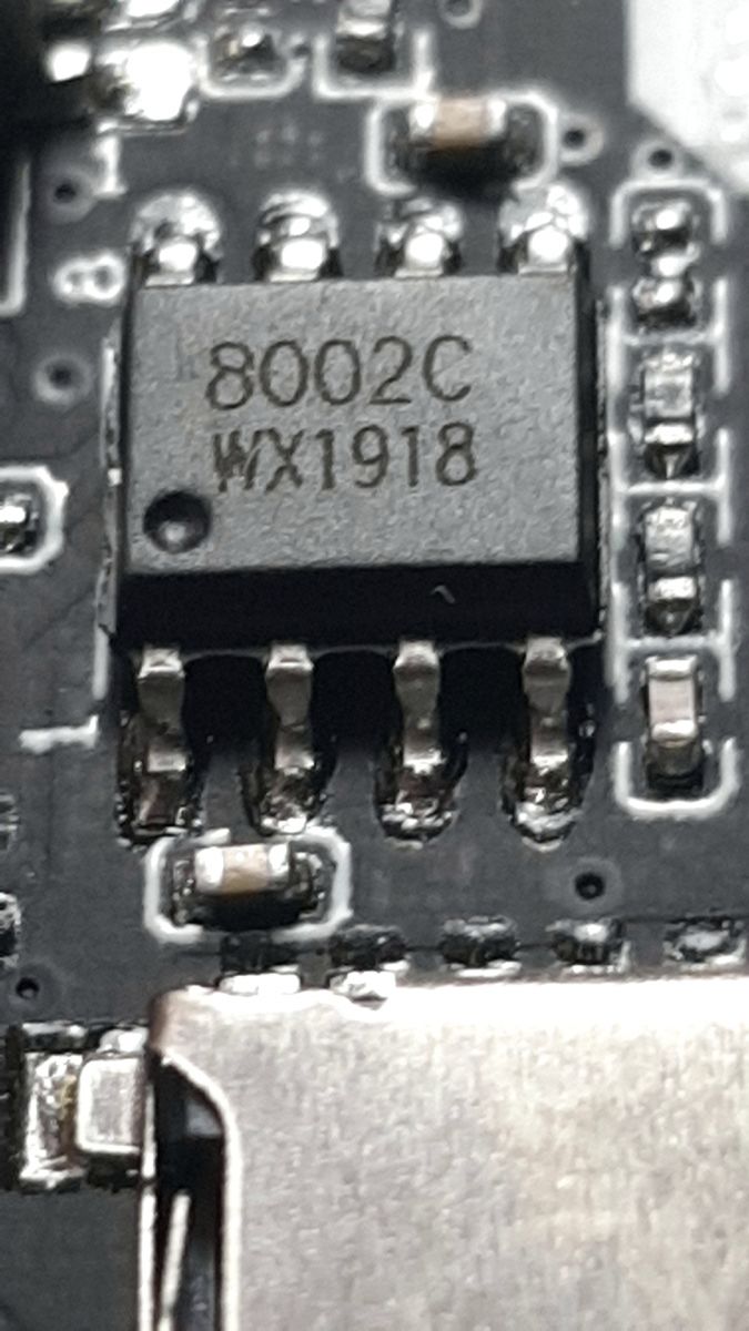

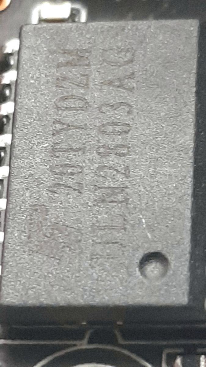

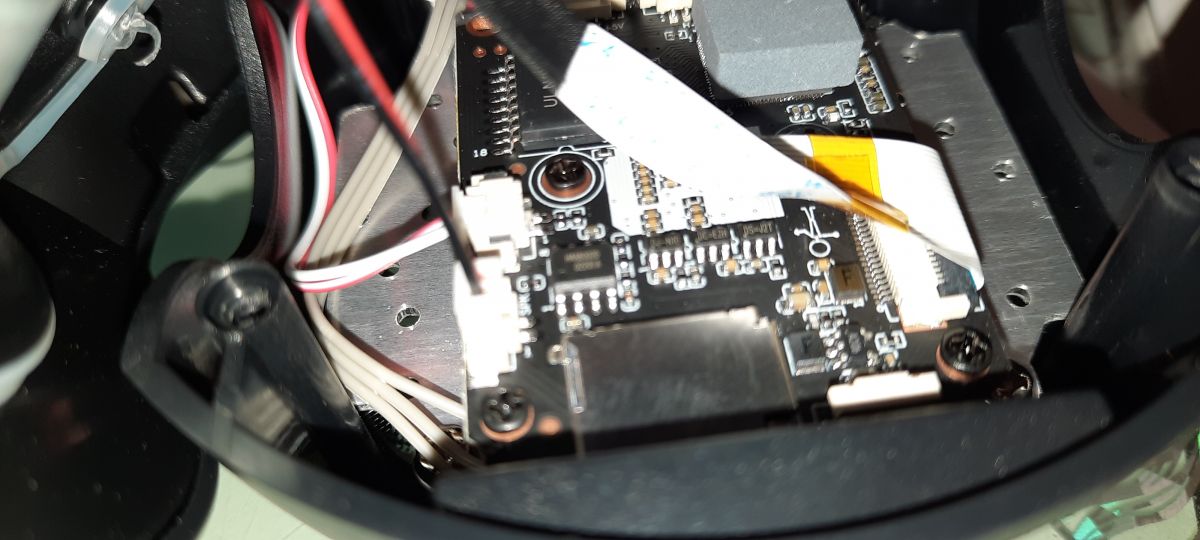

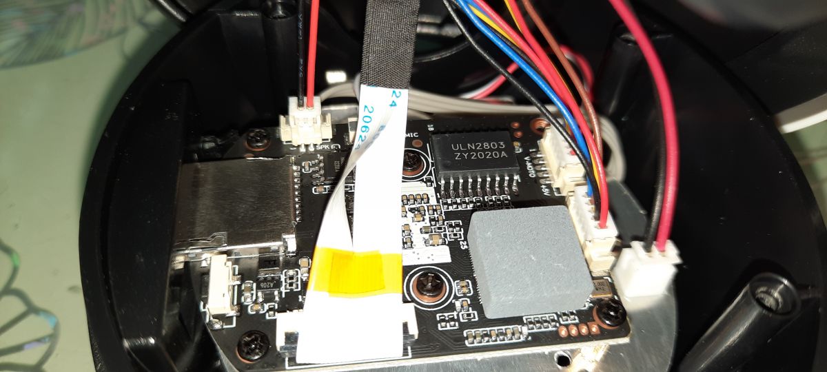

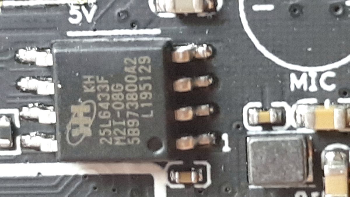

    Below are photos of the tiles and a memory dump. If nothing can be done about it, maybe someone will come in handy someday ;)
    5MP Chinese Webcam: No Browser Access, Fixed IP & Telnet Password Solution Needed 5MP Chinese Webcam: No Browser Access, Fixed IP & Telnet Password Solution Needed 5MP Chinese Webcam: No Browser Access, Fixed IP & Telnet Password Solution Needed 5MP Chinese Webcam: No Browser Access, Fixed IP & Telnet Password Solution Needed 5MP Chinese Webcam: No Browser Access, Fixed IP & Telnet Password Solution Needed 5MP Chinese Webcam: No Browser Access, Fixed IP & Telnet Password Solution Needed
    • 25L6433F.BIN (8 MB) You must be logged in to download this attachment.

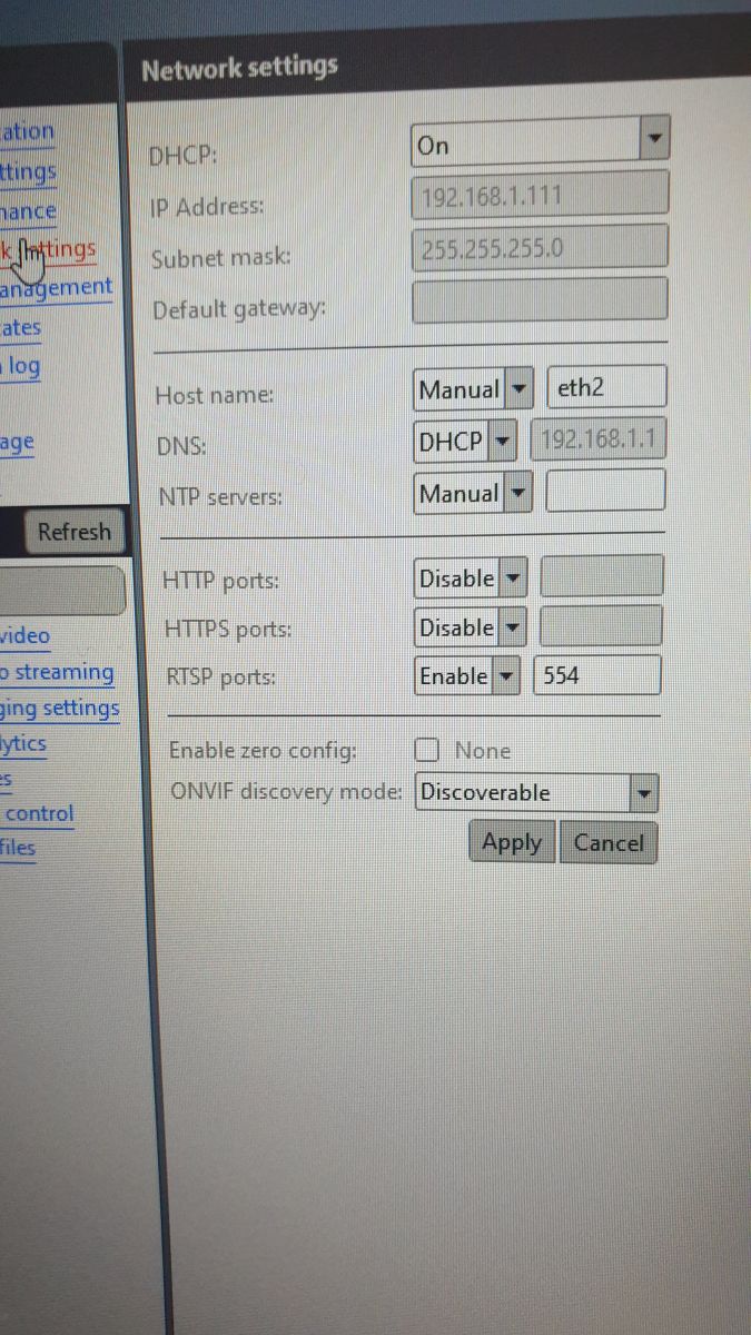

    amigos wrote:
    After checking in ONVIF Device Manager, I have info "Sender not authorized" under all options. This is the one with IP 192.168.8.114
    Have you reset it to factory settings? Logging in with the login and password is the same login and password, entering ONVIF Device Manager instead of admin admin will allow you to access the information.
    As for the root password, you need to decrypt it from what I can see, it is rather not long. You would have to throw it in for some online decryption or on Linux with some supporting program

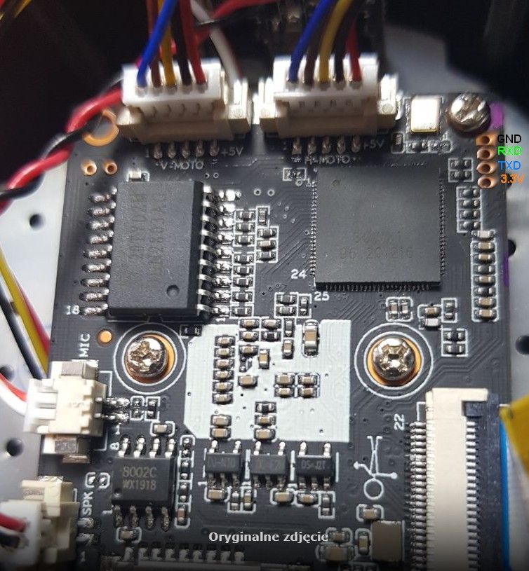

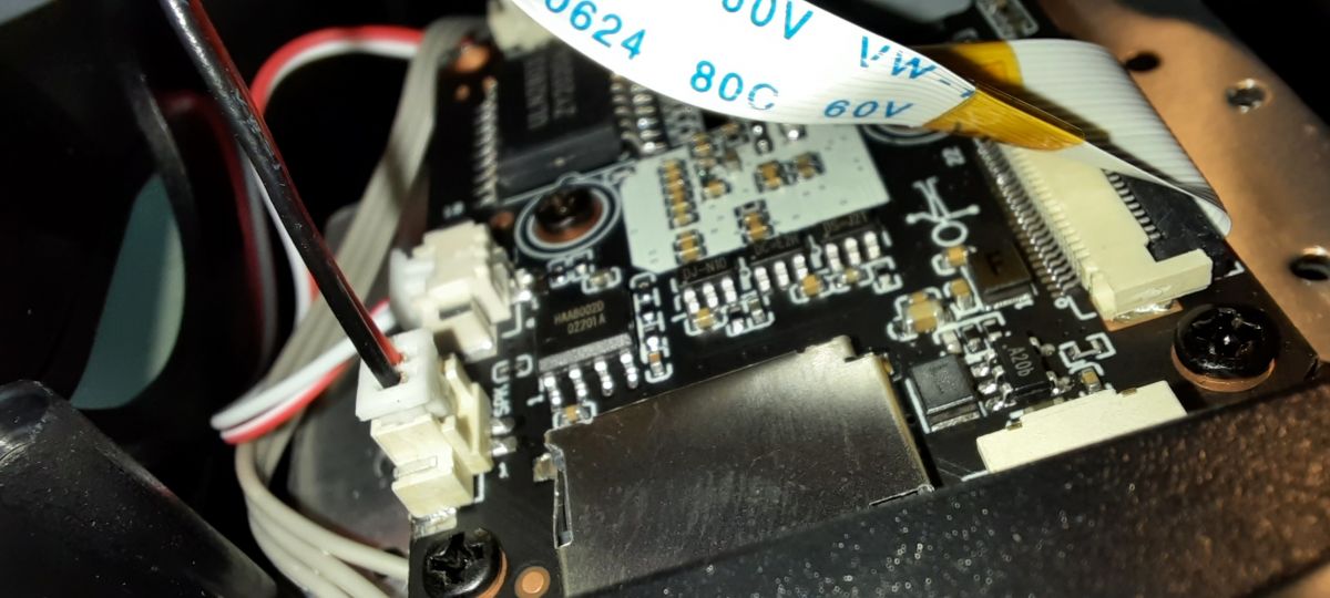

    Take a look here .
    After UART, when you connect to the board via the adapter, you can kind of fumble.
    Above you are supposed to change the environment variables, and maybe from this level, for example, the bootloader, you can turn off the DHCP server. And enter the IP manually. Only if after restarting the camera it will not turn on again. I didn't play with these blocks that much.
    Interesting info worth a look. As you handle Linux, it should probably be understandable to you.
    unless I'm not mistaken you will be more or less:
    It's just worth checking out first.
    You do not connect 3.3V.
    I do not know about you, but if you connect the camera to the power supply but without the Ethernet LAN cable plugged in, the camera fires if clean as only with the option of searching for a configuration to connect to Wi-Fi. For this, check if you turn off the power for the camera and connect it to the LAN cable, then if you turn on the info in ONVIF Device Manager for admin admin will appear. And the ability to enter the browser.

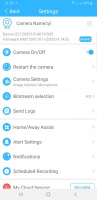

    To connect as AP I have to hold reset and turn on the power. In order for it to connect via wifi, I have to turn it on without a cable. It always connects via the cable when the sponge is connected.
    Now I noticed that I still have such data in Carecam as in the screenshot.
    In addition, I see that there will be a problem with uploading other firmware because it only has the option of updating via the Internet and it will not go from the file.
    UART you described well.
    U-Boot 04/04/2014 (Dec 17 2019 - 15:47:31)
    CPU: XM530
    DRAM: 64 MiB
    MMC: arasan: 0
    In: serial
    Out: serial
    Err: serial
    Net: dwmac.10010000
    Press Ctrl + C to stop autoboot
    ### CRAMFS load complete: 1468336 bytes loaded to 0x81000000
    ## Booting kernel from Legacy Image at 81000000 ...
    Image Name: Linux-3.10.103+
    Image Type: ARM Linux Kernel Image (uncompressed)
    Data Size: 1468272 Bytes = 1.4 MiB
    Load Address: 80008000
    Entry Point: 80008000
    Loading Kernel Image ... OK
    Starting kernel ...
    Uncompressing Linux ... done, booting the kernel.
    y1111111111yyyyyyy1111yyyyyyy1yyyyyyyy111111111111111111111111111111111
    I am in no rush so I will slowly search the web how to spoil it ;) I have to look for some input on the XM530 for the 5MP webcam.
    Edit:
    For posterity ;) The root password on this webcam is ccadmin.

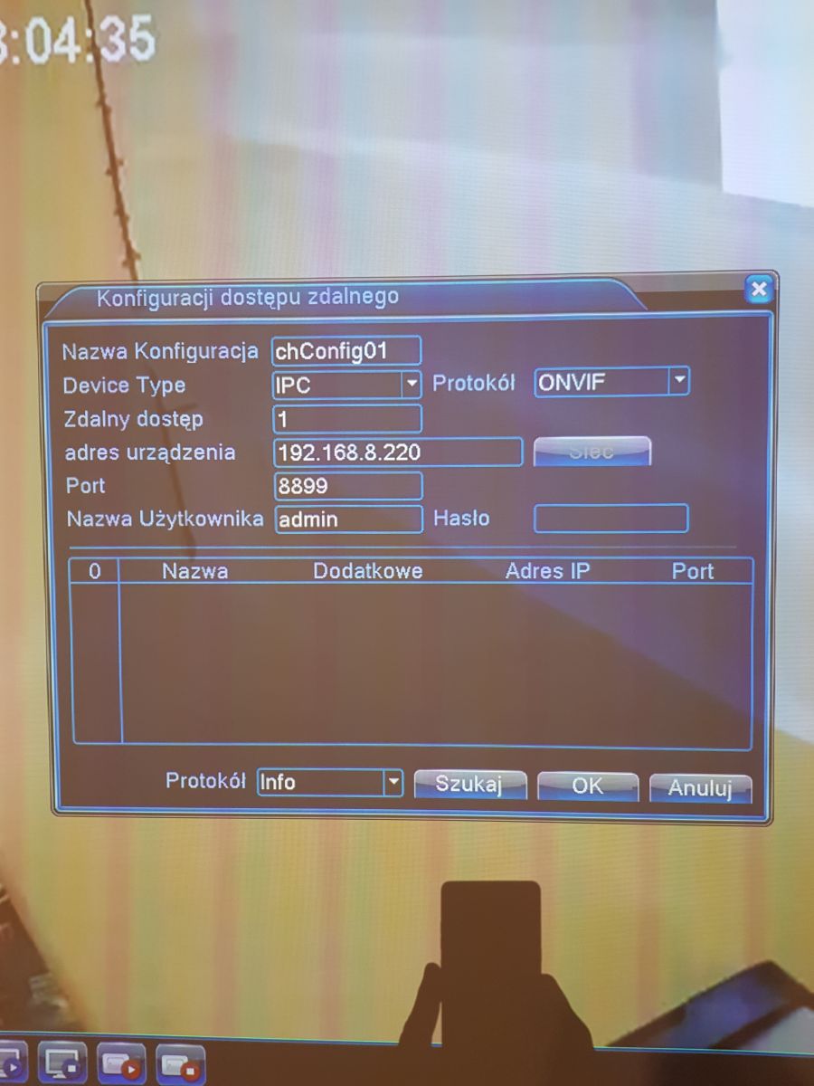

    I don't know what recorder you have. For me it looks like in the picture. I select the channel and search with the info option. I find my camera as onvif on port 80. I change port to 8899, leave user: admin and no password. It works instantly.

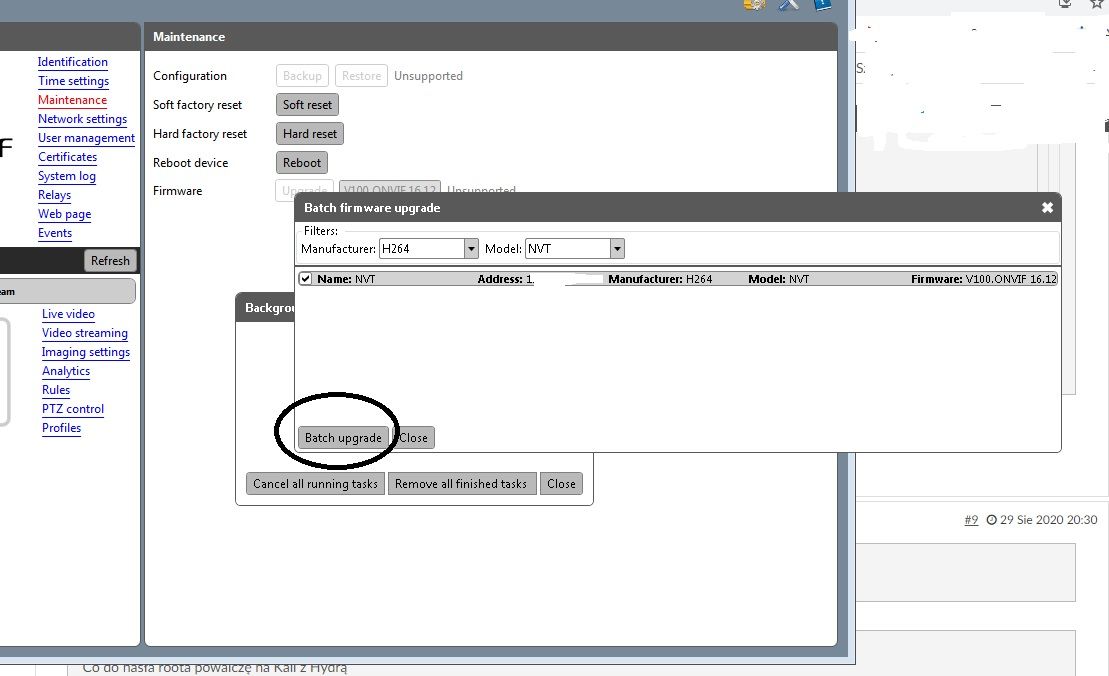

    Have you tried to update the firmware from this post, e.g. using ODM?
    I noticed that there is such a possibility - but I'm not sure if this update is for my camera

    I also have a camera in this housing.
    Firmware: HMT.CM2005-v210104.1124 (displayed on CareCamPro)
    SDK Version 2020202
    Firmware: V100.ONVIF 16.12 (displayed in ONVIF APP)
    From what I noticed, it is some kind of universal housing and inside it you can find quite different equipment. In the offers from Aliexpress, these cameras are supported by various applications. The software can only be changed by online update in the application CareCamPro . Neither version CareCam does not work, does not show the picture. I checked all archives.
    The only thing I was able to do with ONVIF is to create a new media profile where you can choose one of the three available image formats from the list.
    Profile_000 (H264: 2304x1296 ); Profile_001 (H264: 640x360 ); Profile_002 (JPEG: 640x360 ). You can save a new profile with any name, but the memory of this action remains until the first reset.
    The PRESET call and write function also does not work. Selecting any will move the camera all the way to the left and to the top.
    The data shows that 5MP is not, but rather 3MP. Such a marketing "chick" like 1 dummy antenna. The Chinese says he sent the wrong model. But the box and the camera itself have 5MP stickers.
    What is the real resolution of your cameras?
    Is the voice from the microphone blocked by the 50Hz mains hum? For me, you have to shout to the camera for the sound to break through this noise. Changing the power supply does not help.
    In my art of exactly the same "device", the resolution in EXIF info is: dimensions 2304x1296, H / V resolution 96 dpi, depth 24 bit. So it's like 3 MP, but it's not crazy.
    As for the mains hum, for the first days of operation it did not occur at all and the sound was really clear and loud, but after a few days the same problem appeared as with you. From observation while playing with this miracle of technology, when I was looking for loose connections, I noticed that the hum disappears if you touch the backlight heat sink with your finger :crazyeyes:

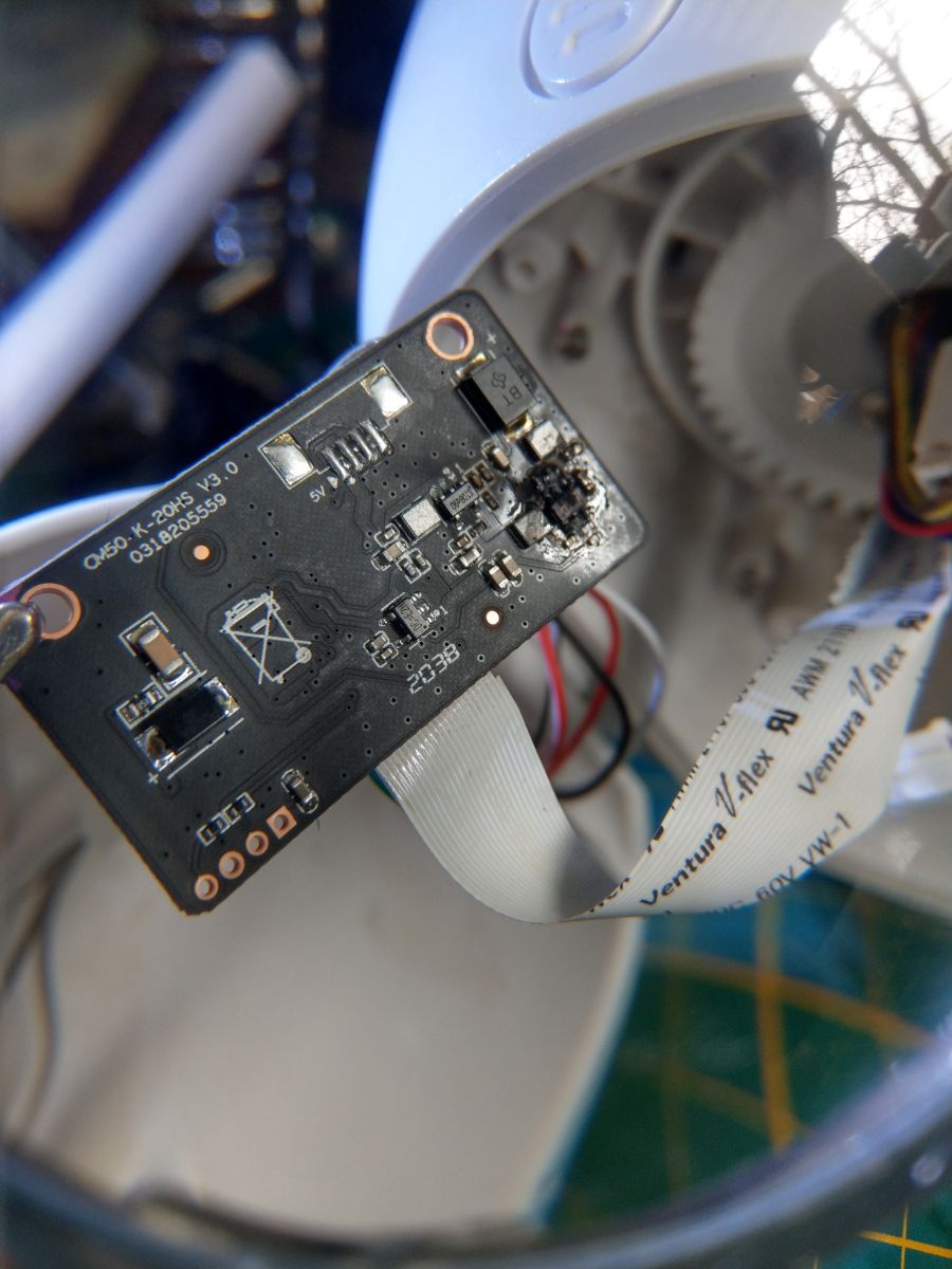

    Overall, my experience with what was supposed to be a camera is terrible. After about a week of use, there was a problem with the sound, a few days later it stopped connecting to the wifi (I tightened the lan), then maybe twice a day I was able to go into the preview - the rest of the time I saw the message "camera offline". At the same time, she once saw the SD card and once failed (I tested several different cards), RESET helped for a while. After another week, the paths in the tape connecting the modules broke (I made a new one taken out of some printer), it worked for a few days until the backlight wires broke off, making a small fire on the Poe module PCB
    If any of my colleagues could share a photo of this plate with me to identify what should be there, I would give francy one last chance to come back alive.

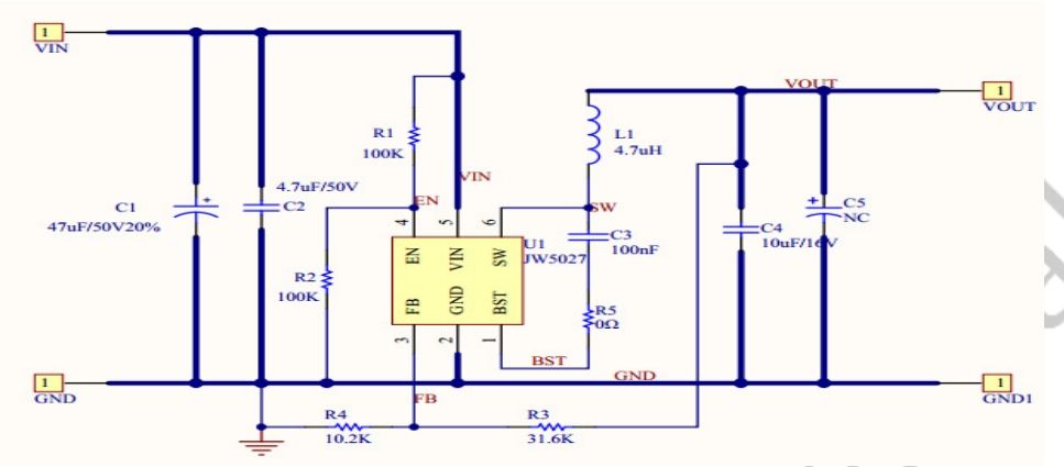

  • #25 19348567
    gradek83
    Posts: 9043
    Help: 925
    Rate: 2075
    Board Language: polish
    JW5027
    for ali 20 pieces for 35 PLN
    • EV5027_S0_R0.pdf (742.14 KB) You must be logged in to download this attachment.
  • #26 19349935
    damianos1981
    Thank you very much. :D

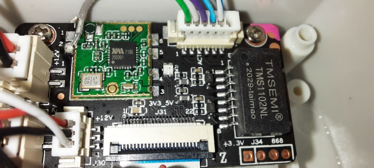

    mipix
    Posts: 4049
    Help: 489
    Rate: 1457
    After dismantling the housing and fumbling with the wires, the hum disappeared and appeared randomly. Touching the backlight heat sink or the memory card connector housing cuts this hum to zero. Disconnecting the microphone leaves only the hum of the amplifier. Sometimes, when it does not hum, it is enough to bring your hand closer to the microphone for a few centimeters and the hum returns in direct proportion to the distance of the hand from the microphone. There was also a moment when the sound was clear for several hours. After rebooting and changing the tab, the hum came back.
