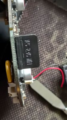

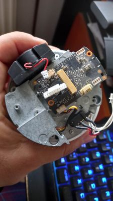

  • The teardown examines the Ezviz C6C (CS-CV246, A0-3B1WFR) cheap Wi‑Fi camera.
  • Inside, it uses an STM8S003F3 microcontroller and exposes Hikvision protocol on port 8000 plus RTSP on port 554.
  • The camera can be dismantled and reassembled non-invasively: bottom screws hide under the rubber band, and the head is secured with latches.
  • No alternative software exists yet, and the other circuits are shown in the photos as legibly as possible.
  • Producer: Ezvis
    Model: C6C (CS-CV246, A0-3B1WFR)
    Camera Ezviz C6C (CS-CV246, A0-3B1WFR) teardown Camera Ezviz C6C (CS-CV246, A0-3B1WFR) teardown
    Description: Cheap Wifi camera by Ezviz operating via Hikvision protocol on port 8000 with RTSP on port 554. Based on STM8S003F3 (8S003F3P6) microcontroller (16-MHz STM8S 8-bit MCU, 8Kb flash, 128b EEPROM, 10-bit ADC, UART, SPI, I²C). The other circuits are visible in the pictures - I tried to make them legible. At the moment there is no alternative software. The device itself can be dismantled and assembled completely non-invasively (housing screws are located under the rubber band from the bottom - the rest are not hidden, the "head" of the camera is closed with latches).
    Teardown photos:
    Camera Ezviz C6C (CS-CV246, A0-3B1WFR) teardown Camera Ezviz C6C (CS-CV246, A0-3B1WFR) teardown Camera Ezviz C6C (CS-CV246, A0-3B1WFR) teardown Camera Ezviz C6C (CS-CV246, A0-3B1WFR) teardown Camera Ezviz C6C (CS-CV246, A0-3B1WFR) teardown Camera Ezviz C6C (CS-CV246, A0-3B1WFR) teardown Camera Ezviz C6C (CS-CV246, A0-3B1WFR) teardown Camera Ezviz C6C (CS-CV246, A0-3B1WFR) teardown Camera Ezviz C6C (CS-CV246, A0-3B1WFR) teardown Camera Ezviz C6C (CS-CV246, A0-3B1WFR) teardown Camera Ezviz C6C (CS-CV246, A0-3B1WFR) teardown Camera Ezviz C6C (CS-CV246, A0-3B1WFR) teardown Camera Ezviz C6C (CS-CV246, A0-3B1WFR) teardown Camera Ezviz C6C (CS-CV246, A0-3B1WFR) teardown Camera Ezviz C6C (CS-CV246, A0-3B1WFR) teardown Camera Ezviz C6C (CS-CV246, A0-3B1WFR) teardown Camera Ezviz C6C (CS-CV246, A0-3B1WFR) teardown Camera Ezviz C6C (CS-CV246, A0-3B1WFR) teardown Camera Ezviz C6C (CS-CV246, A0-3B1WFR) teardown

    Thanks for showing the inside. The camera is very cheap, only PLN 160. Does it send any data to an external cloud? Can you just connect to Hikvision cameras?
