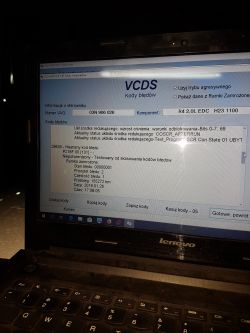

    I have a question about the Adblue system in a 2012 Seat Alhambra 2.0 tdi cffb car.
    After refilling the fluid , the system does not see this fact. Displays meadblue light and distance to go which is decreasing .
    What is the procedure after topping up the liquid? You have to wait with the ignition on or should immediately be detected full tank of liquid?
    In Vcds I made in adaptations : "Resetting of SCR tank level detection"
    because it seems to me that this function is responsible for the reset? but it does not help.

    Was there an error from the NOX sensor in the engine controller
  • #3 13895127
    Albus
    Level 21  
    Posts: 596
    Help: 13
    Rate: 344
    Yes there was a NOX error, the car could not be started, errors cleared do not return. The car starts , drives. In adaptations I also selected learned Nox sensor. . did not help

    To do a flash of the engine controller, it should extinguish the light , if not you need to do an adaptive driving.To replace also the NOX sensor because the fault will return and will light the check engine light.
    What controller number and software version ?

    Address 01: Engine
    Control Module Part Number: 03L 906 018 HL
    Component and/or Version: R4 2.0L EDC H24 9959
    Software Coding: 0019001A043401080000
    Work Shop Code: WSC 80232
    VCID: 7BF5116EF2456DC6C11-802E
    Advanced Identification/FAZIT
    Serial number:
    Identification: BPG-810
    Revision: 44H24---
    Date: 21.02.11
    Manufacturer number: 1236
    Test stand number: 0179
    Flash Status
    Programming Attempts(application): 1/1/1
    Successful Attempts(application): 1/1/1
    Flash Date: 12.08.20
    Misc.
    Hardware number: 03L 906 018 M
    and the errors were as follows :
    9567 - NOx Sensor 2 Bank 1
    P229F 00 [237] - Implausible Signal
    MIL ON - Confirmed - Tested Since Memory Clear
    Freeze Frame:
    Fault Status: 00000001
    Fault Priority: 2
    Fault Frequency: 24
    Mileage: 43606 km
    Date: 2026.14.30
    Time: 11:33:00
    15733 - SCR NOx Catalyst Bank 1
    P20EE 00 [237] - Efficiency too Low
    Freeze Frame:
    Fault Priority: 2
    Fault Frequency: 1
    Mileage: 48403 km
    Date: 2035.14.22
    Time: 12:56:04
    4891 - EGR Valve (N18)
    P0403 00 [096] - Malfunction
    Intermittent - Not Confirmed - Tested Since Memory Clear
    Freeze Frame:
    Fault Priority: 2
    Fault Frequency: 1
    Mileage: 48403 km
    Date: 2035.14.22
    Time: 12:56:04
    #6 13896632
    jacek074
    Level 30  
    Posts: 878
    Help: 186
    Rate: 719
    You can see that the flash is done.Sensor to be replaced.In VAS special procedure to disable the adblue message,time consuming but doable.Adblue is best to add to full, or min. 10 l.As for the problem in firing it is egr that is the cause.

    Adblue was added to full , stood for several minutes on the ignition on and nothing :) If it passes the mileage limit the car will not start or what happens? And this egr is a replacement for a new one or a cleaning which I don't believe myself :) ???The car has such low mileage and here such surprises.
    #9 13897800
    jacek074
    Level 30  
    Posts: 878
    Help: 186
    Rate: 719
    I had a car where the mileage limit passed and it fired up.I wrote that it does not fire up because of the egr because there was an error,maybe the car was standing and failed.I had a case that it died and did not fire up - it turned out that it hung up in the open position.It is very easy to check in these engines - plug the wire at the head.As for the procedure for these errors from the NOx sensor is service information in VW/SEAT, as for the egr too.

    With EGR in this car for several months was able to light up check and go out. And the NOx errors are only now popping up. This hint from your side Jack about replacing the sensor is I understand from the service information? I'm asking because the controller does not generate any errors and the adblue light did not go off after adding it, hence my post on the forum, and with the adblue system and in fact its failure I have to deal with for the first time.
  • #11 13905433
    jacek074
    Level 30  
    Posts: 878
    Help: 186
    Rate: 719
    Yes my hint based on service inf. , the fault from the sensor will probably return (I know it is not cheap) but without replacement the procedure is unlikely to pass.
