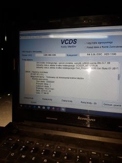

  • #8 17031051
    Pietka 1
    Posts: 8
    Rate: 22
    Hello gentlemen. Have you resisted these errors because I have the same topic. Sharan from 2011 mileage 130 thousand. I deleted the errors and the counter continues to count down. And I don't know where to start. I am asking for advice.
    Regards
    • Sharan 2,0TDI 103kW 2011: Dealing with P229F00 and P20EE00 NOx Sensor Errors after Long Drives 20180129_172838.jpg (3.17 MB) You must be logged in to download this attachment.
  • #9 17031181
    stiko
    Posts: 15
    Rate: 16
    Pietka 1
    I took care of the topic by removing the adblue system in the car driver. Since then, there are no mistakes related to this pseudo-ecological crap. There are a lot of magicians on the net who can modify the soft. Just browse OLX
  • #10 17037983
    Pietka 1
    Posts: 8
    Rate: 22
    So far I have not thought about disconnecting this crap, I am trying to do something about it because the counter is counting down, there are already 150 km left until the engine is not started.
    And he knows, there are mistakes, as if someone was to lose it.
    Address 7E8: 2 - number of errors found. Here they are:
    P20EE - SCR NOx catalyst; team 1: efficiency too low
    P229F - Sensor 2 NOx; team 1: implausible signal.
    After it was deleted, it came back
    Address 01: Engine (J623-CFFB) Labels :. 03L-906-018-CFF.clb
    Part No SW: 03L 906 018 HH HW: 03L 907 309 Q
    Component: R4 2.0l TDI H24 9980
    Verification: 44H24 --- Serial Number:
    Coding: 0019003A042401080000
    Service code: WSC 33804 184 00000
    ASAM dataset: EV_ECM20TDI01103L906018HH 003015
    ROD: EV_ECM20TDI01103L906018H.rod
    VCID: 77FCD340CECD45FEA0-8022
    1 error found:
    15733 - SCR NOx catalyst; team 1
    P20EE 00 [101] - efficiency too low
    Unconfirmed - Tested since erasing error codes
    Frame frozen:
    Error Status: 00000001
    Fault priority: 2
    Error rate: 1
    Mileage: 136 161 km
    Date: 2018.02.12
    Time: 09:01:26
    Engine speed: 2078.50 / min
    Normalized load value: 67.1%
    Vehicle speed: 113 km / h
    Coolant temperature: 85 ° C
    Intake air temperature: 7 ° C
    Atmospheric pressure: 990 mbar
    Terminal 30 voltage: 14.940V
    Learning cycle counter after OBD: 40
    Long-term adjustment of reducing agent dosing: 1.00
    Measured NOx conversion: -0.500
    Calculated NOx conversion efficiency: 0.868
    NOx conversion efficiency threshold: 0.300
    Current temperature in the NOx reduction catalyst: 263.0 ° C

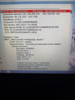

    I have a VW Passat b8 2.0 bitdi 240km, CUAA engine code, an error on the board - adblue fault and info about engine immobilization after 1000km.
    Error with VCDS 29630 (P218F00 in the attachment) - adblue pump fault according to the service.
    The pump has been replaced and the check is still on the display, the error in the VCDS does not return.
    I am asking for help on the subject

    Yesterday, the problem with Adblue appeared again - has anyone encountered the error P204F00 (Reducing agent system - team 1)
    After removing the error from the engine controller, it does not exist and does not return, while the clock calculates the time to immobilize the car and displays the message Malfunction: AdBlue. It will not be possible to start the engine in 1000 km

    The indicator itself went out after adding Adblue - unfortunately until today - it shows the same error
