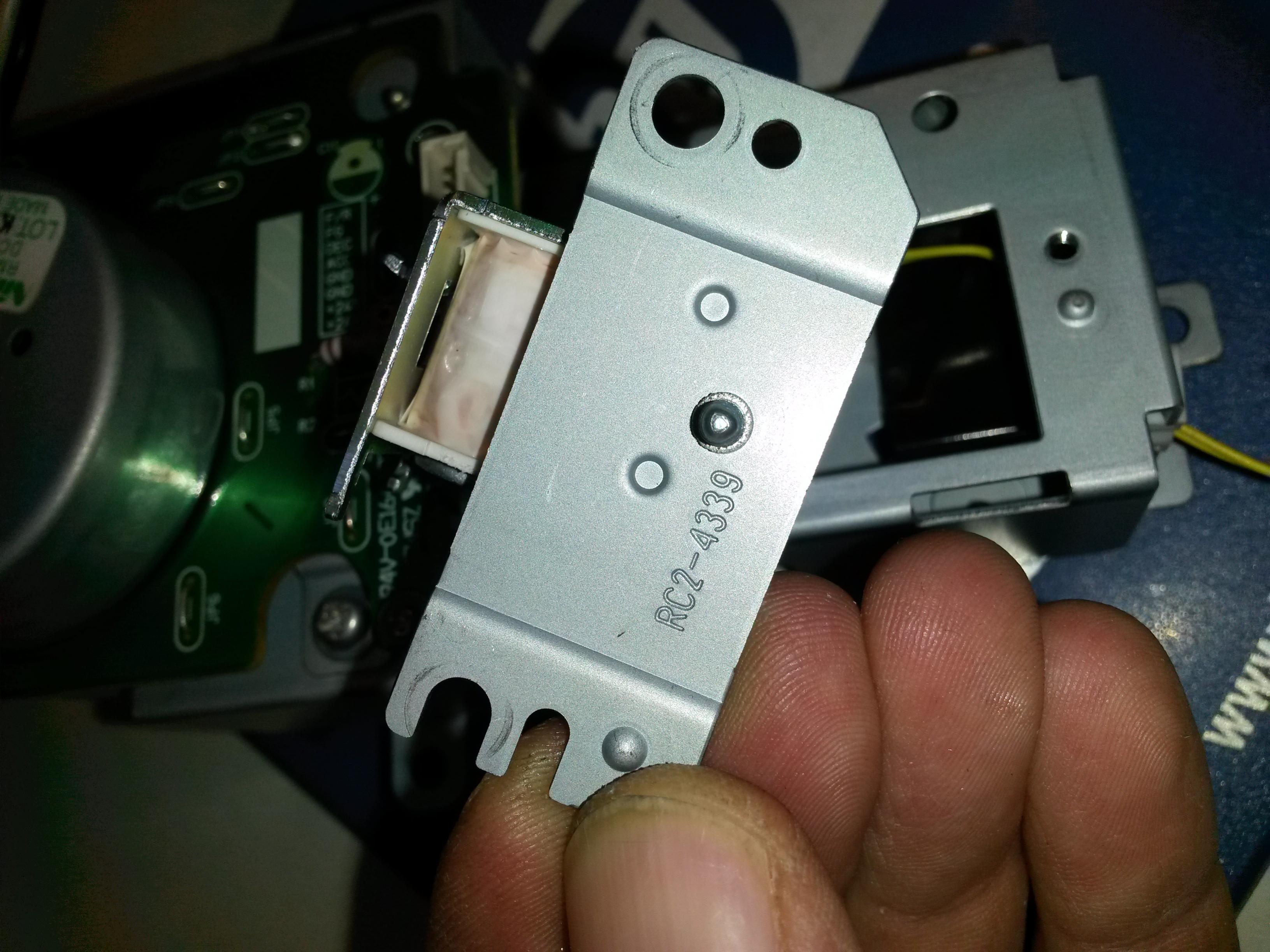

    Hello, the fuser drive assy module is 99% to blame. I suggest you first perform TESTS
    If symptoms are confirmed then I recommend TEN post.
    In short, you need to remove the fuser drive assembly, check whether the gears are out of sync as in photo 1, possibly correct them.
    Secondly, you need to eliminate the well-known syndrome of sticky solenoid in this mechanism - photo 2.
    Of course, you can replace the solenoid or even the entire fuser drive module, as you prefer.
    I know that I write on a very old post, but I'm just rolling this case and thanks to inquisitiveness I saved 200,- pln which I had to spend on a USED module.
    I'm sure it will be useful to someone.
    Greetings.

  • #4 16345595
    Dr Blade
    Posts: 80
    Help: 9
    Rate: 13
    Hello, in my case the cause of the error was a sticky solenoid, removal of the sponge and thorough washing from the glue gave an improvement in the operation of the device.

    I got through to the end of this ordeal of taking the printer apart and ...
    Solenoid didn't stick and the gears aligned correctly :(

  • #6 16733187
    kemotix
    Posts: 175
    Help: 27
    Rate: 69
    I had such a case, i.e. the solenoid and gears looked good, but still replacing the fuser drive was necessary. The machine got up immediately after the repair.

  • #9 16798180
    pcnet
    Level 32  
    Posts: 4096
    Help: 11
    Rate: 217
    I replaced this sprocket set and it was done:)
