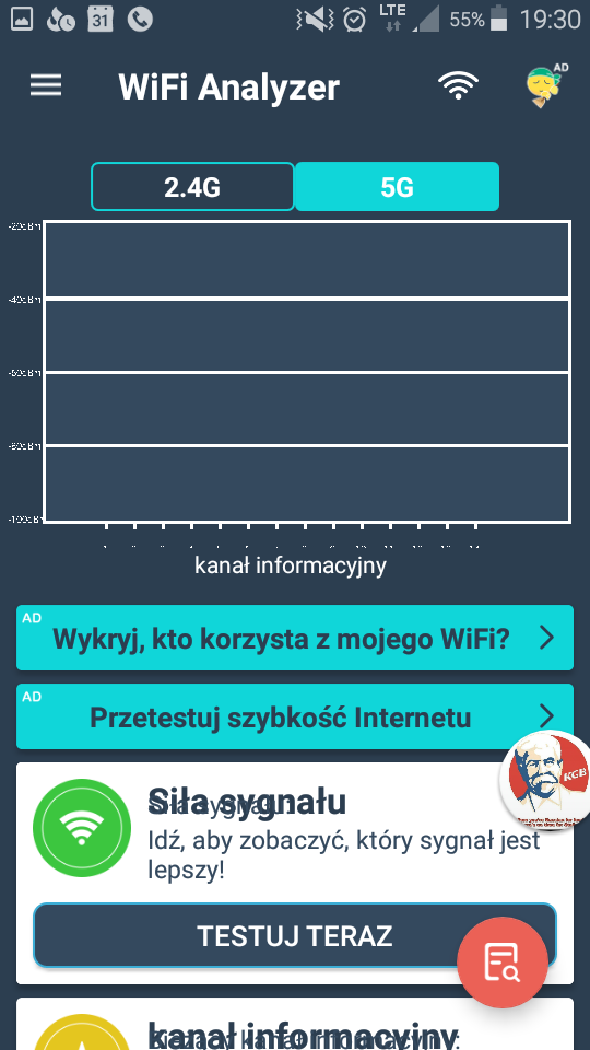

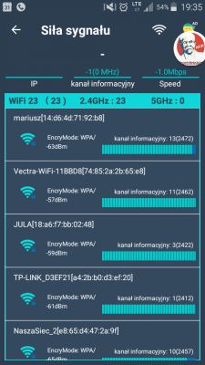

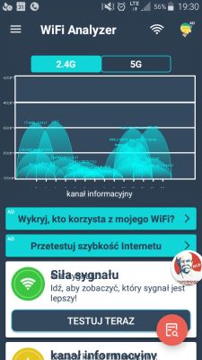

  • #17 17698613
    permenentnie
    Posts: 19
    Rate: 9
    Unfortunately, I don't have Wifi access here. How can I read it (attachments) where to check if the device supports 2.4 or 5 waves or if it is possible to change which frequency supports the device? Vectra 150 Mb/s Internet: Modem Router Guide, Cisco EPC3928S vs Technicolor CGA2121 vs Ubee EVW32B Vectra 150 Mb/s Internet: Modem Router Guide, Cisco EPC3928S vs Technicolor CGA2121 vs Ubee EVW32B Vectra 150 Mb/s Internet: Modem Router Guide, Cisco EPC3928S vs Technicolor CGA2121 vs Ubee EVW32B
    • Vectra 150 Mb/s Internet: Modem Router Guide, Cisco EPC3928S vs Technicolor CGA2121 vs Ubee EVW32B Screenshot_2019-01-13-19-30-15.png (130.4 KB) You must be logged in to download this attachment.
    • Vectra 150 Mb/s Internet: Modem Router Guide, Cisco EPC3928S vs Technicolor CGA2121 vs Ubee EVW32B Screenshot_2019-01-13-19-30-19.png (92.13 KB) You must be logged in to download this attachment.
    • Vectra 150 Mb/s Internet: Modem Router Guide, Cisco EPC3928S vs Technicolor CGA2121 vs Ubee EVW32B Screenshot_2019-01-13-19-35-11.png (106.69 KB) You must be logged in to download this attachment.
  • #18 17698946
    sebap
    Posts: 7140
    Help: 538
    Rate: 1082
    At 2.4GHz it's terrible crap and I wouldn't expect more than 20-30Mb / s from WiFi.
