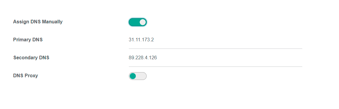

    Yes, it is impossible to separate the network also for me. The system time of the modem is not synchronizing and (I think) I have problems with connecting to the Sony TV, which "goes crazy" and loses the network ... so I went back to managing the modem by Vectra.
    The advantage of the open mode is the ability to enter your own DNS settings or change the network mode, e.g. for 2.4 GHz to 20 MHz (the default is 40 MHz) or 160 MHz for 5 GHz ...
    I am waiting for an updated firmware that will solve these problems.

    Do you have the option to change DNS settings in this modem after switching to open mode?
  • #29 20049176
    Ptrzask
    Posts: 6
    @oculars_increasers As for this option, YES, it is active, you can change entries.
