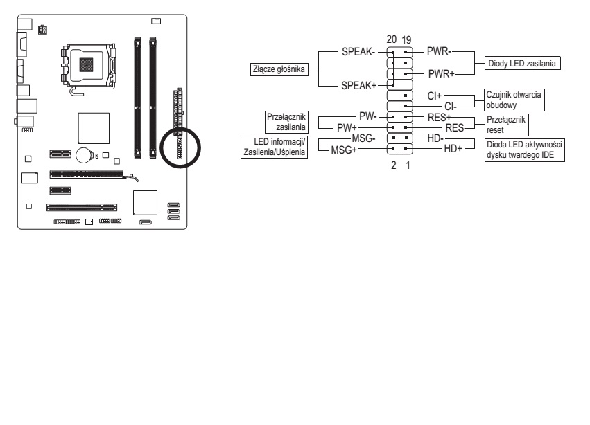

  • #9 13953814
    meaverick
    Posts: 785
    Help: 100
    Rate: 224
    Board Language: polish
    I have attached a description of the pins and if there is a loudspeaker on this board, check if it has sat down? Troubleshooting Radeon AX3850: Guide to Measuring Output Voltage and Comparing Values
    The pins for the loudspeaker are free, and I can't see the device itself, so I don't think the board has one.
  • #11 13955546
    meaverick
    Posts: 785
    Help: 100
    Rate: 224
    If you have a loudspeaker with a similar plug, you need to put it there, but see the computer, there should be a free plug somewhere, moreover, I don't know, maybe they don't install such things now.
