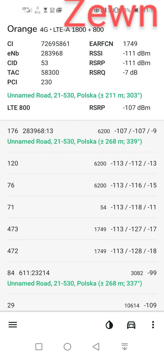

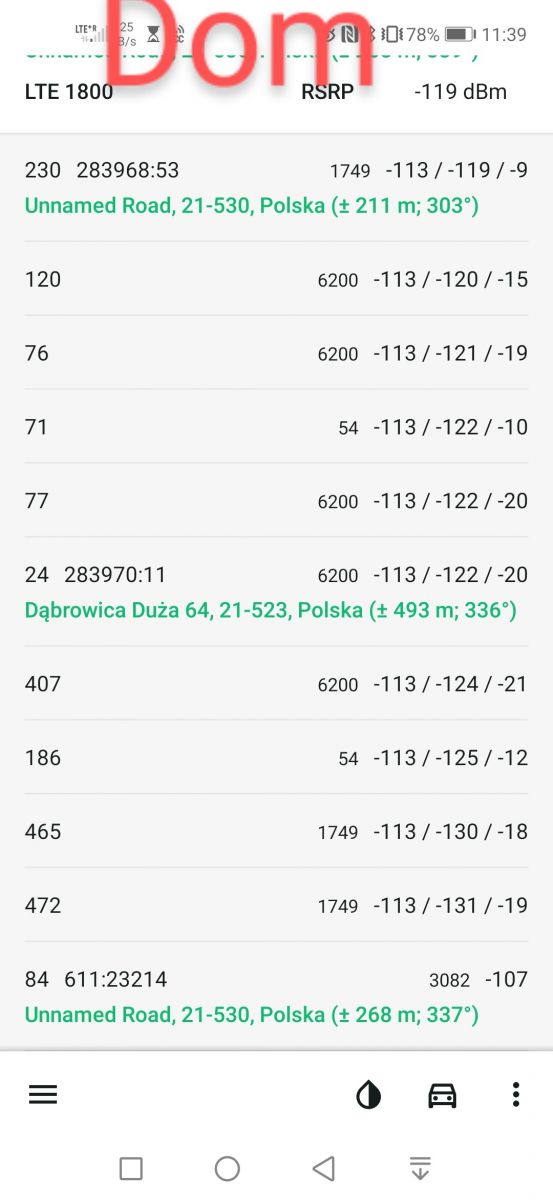

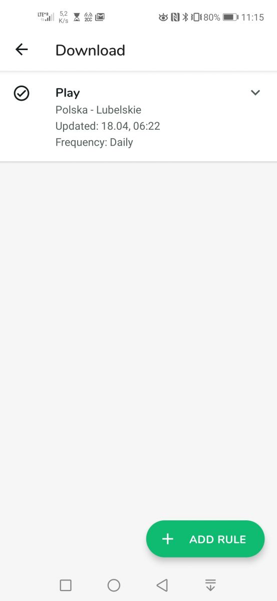

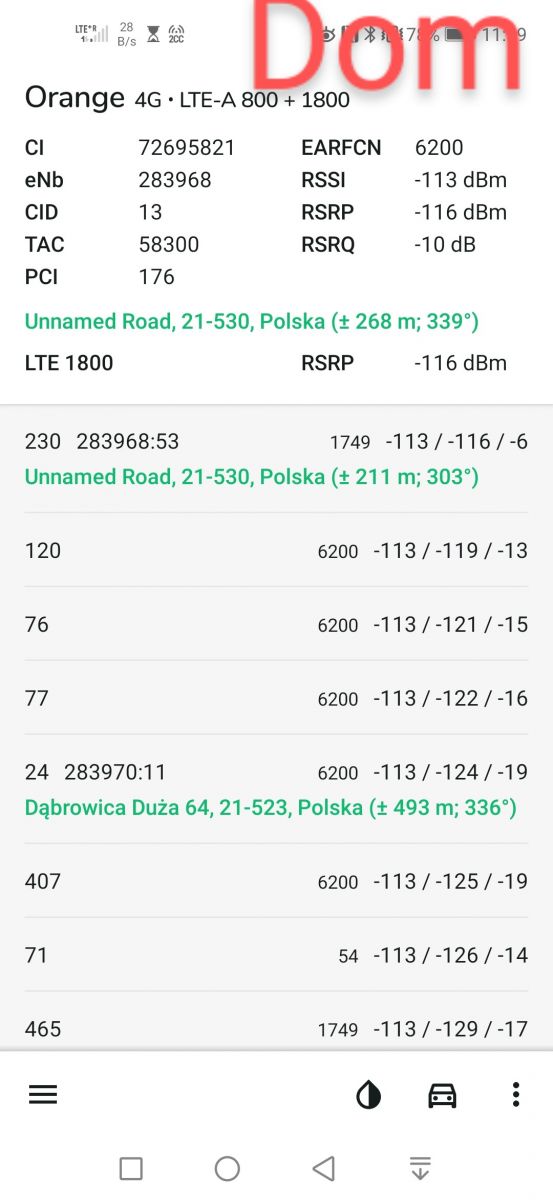

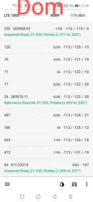

    EwaKo1
    I have installed the applications, I have no idea what is displayed there, but I am sending screenshots of the test at home and outside. I just don't know why, even though I added play, only Orange is displayed, maybe I did something wrong ...
    When it comes to speed, I understand that you will not get miracles here, so even a stable 10Mb / s would please me ... Although it is known that the more the better ;) Huawei B593 LTE Configuration: Troubleshooting No Internet Connection Issue for New Device Huawei B593 LTE Configuration: Troubleshooting No Internet Connection Issue for New Device Huawei B593 LTE Configuration: Troubleshooting No Internet Connection Issue for New Device Huawei B593 LTE Configuration: Troubleshooting No Internet Connection Issue for New Device

    Raycoreti
    Posts: 241
    Help: 33
    Rate: 24
    In this location as far as Playa the closest is BTS Piszczac, ul. Włodawska 1 - the Church of the Exaltation of the Holy Cross with stripes LTE 800 LTE1800 and LTE2100 .
    A bit further you have BTS Play Lachówka Duży - gm. Zalesie, own mast (former T-Mobile) - from LTE 800 to LTE2600, i.e. a full fan only a problem with the distance which is very large - 9.5 km .
    Next to it is Piszczac, ul. Terespolska - the mast T-Mobile + Orange where you have the lousy LTE800.
    LTE1800 + 800 is probably connecting you to BTS Orange which has eNBID 283970 and LTE800 band, although I am surprised by LTE1800.
    You don't connect to any BTS from Playa.

    Test on the Play voice card but without domestic roaming disabled, so you are connected to Orange, but the NetWorks Połoski base station should be modernized and refarmed, LTE1800, LTE2100 and LTE800 for Orange and for T-mobile work on it. Turn off the RK on the phone, then you log in to the Play home network or do a test on the Play internet card, it should be in the router.
