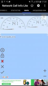

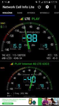

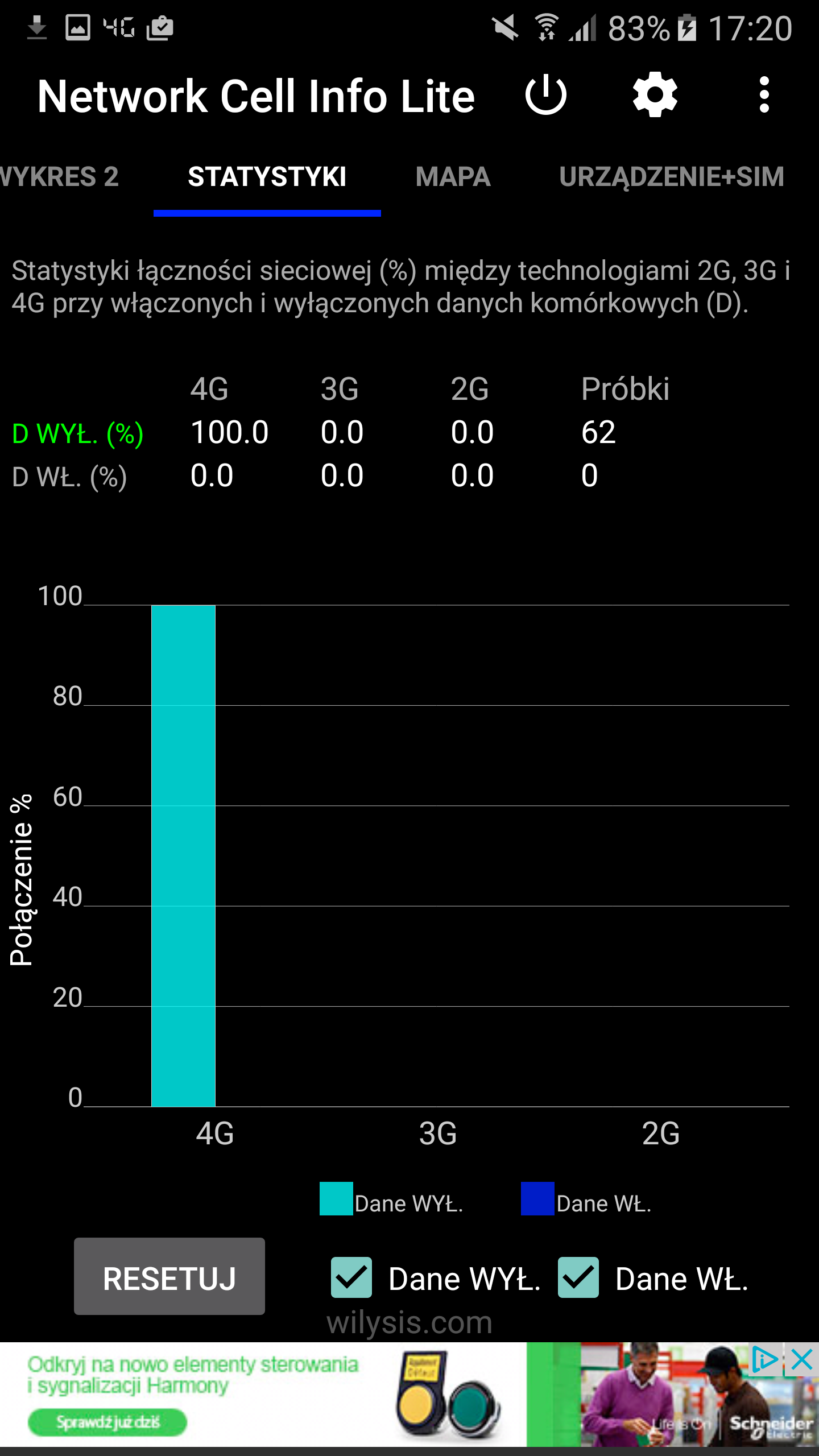

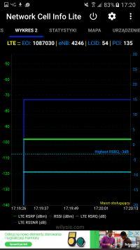

    Thanks for the guys. I put photos from the Network Cell Info program. WIFI connection.
    EDIT: I have the same in Warsaw and Lodz. :)

    In Play, there is sometimes a problem with hanging (freezing) an Internet connection to LTE. The router shows the connection to the BTS and the internet does not work. It helps to restart the router. Similarly, it was once in Orange pre-paid.
