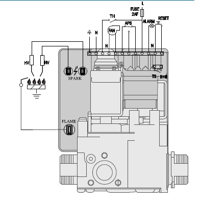

    maybe someone who repairs these things will help me because without a schematic I can't do much
    during the storm I lost the ignition in the CO de dietrich furnace, all the damaged parts on the board were replaced, except for the diode signed on the DZ2 board, there is no description on it

    Hello, it is a Zener Diode BZX85C 24

    At the beginning, it should probably be checked the supply voltage. Connect the power supply to the appropriate pins and check, first of all, if the micro-controller has 5V, it is powered from the voltage regulator LM7805 in the TO92 housing, it looks like a small transistor.

    Capacities often fall on this type of PCB - loss of capacity (I think they are labeled C1, C11 470n / 400V and C7 330n / 400V) from EPCOS. The only problem is that other capacities (from other manufacturers) do not fit in the package. So I change all three capacities to new 470n / 400V and it's after the competition. Of course, I always solder connectors and relay contacts at the same time, so that I do not have any further problems.

    Please help. Where does this module get the information to turn on the fan.
    I'll answer myself ... Maybe someone will need it.
    This module controls the fan ... After replacement, the fault is no longer present. If someone has a problem that the pressure switch blows and the burner fires but the fan does not turn on, it is probably a fault of this ignition apparatus.

    What is it on the APS diagram under pins 6 and 7? Could it be the flue gas pressure switch? And if there is no fan, then maybe an exhaust STB?
