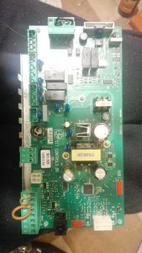

    During the storm, the control board for the de dietrich mcr / II 24/28 MI boiler burned. De Dietrich MCR II 24/28 mi, change of control board, CH operation not DHW The repair attempt failed.
    I have the same control board in appearance, probably from the model de dietrich mcr / II 24T De Dietrich MCR II 24/28 mi, change of control board, CH operation not DHW . After connecting it, the factory settings indicate the mcr / II 24T model. Here is a comparison of stickers from both boards De Dietrich MCR II 24/28 mi, change of control board, CH operation not DHW
    The sticker from the burned disc has information about the Firmware 2.0 version. When starting the furnace, it alternately displays F and 1.2. I conclude that I have firmware version 1.2
    At this moment I came to the fact that:
    For CO to work dF parameter De Dietrich MCR II 24/28 mi, change of control board, CH operation not DHW must be set to 10 (factory setting for the MCR / II 24T furnace with a sticker on the furnace housing), when I set to 6 (factory setting for the MCR / II 24/28 mi) error code 9 appears
    The problem is that the DHW does not work after changing the other parameters to those adapted to my furnace:
    - changing the P3 parameter from 2 to 1 gives nothing (DHW still does not work)
    - Parameter P30 is set to 1, if set to 0, error code 9 pops up. De Dietrich MCR II 24/28 mi, change of control board, CH operation not DHW
    In my opinion, it looks like the firmware is for the De dietrich 24T version. If I could upload the firmware from the 24/28 version, it should be ok. I called the official de dietrich service technician and I got the information that nothing can be done and you need to buy a new CD. The question is what do you think? Is it possible to update the software? do I have to put out PLN 1300 for a new CD?

    In addition to the df code, you also have to change du. If this does not help, unfortunately the new album.

    dU for both furnaces is 8, so I did not change.

    How do you restore factory settings you need to set df and a lot of not only 1 settings, how did you get the plate to MI, i.e. with a plate heat exchanger, check if you connected the flow sensor to a new plate, unless it is also damaged.
