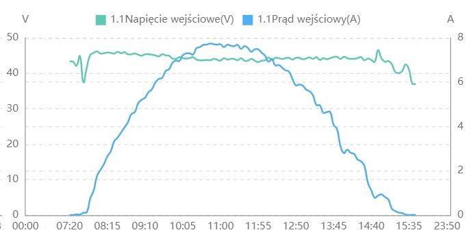

    Ad 8. graph of the panel output (here exactly as optimizer inputs)

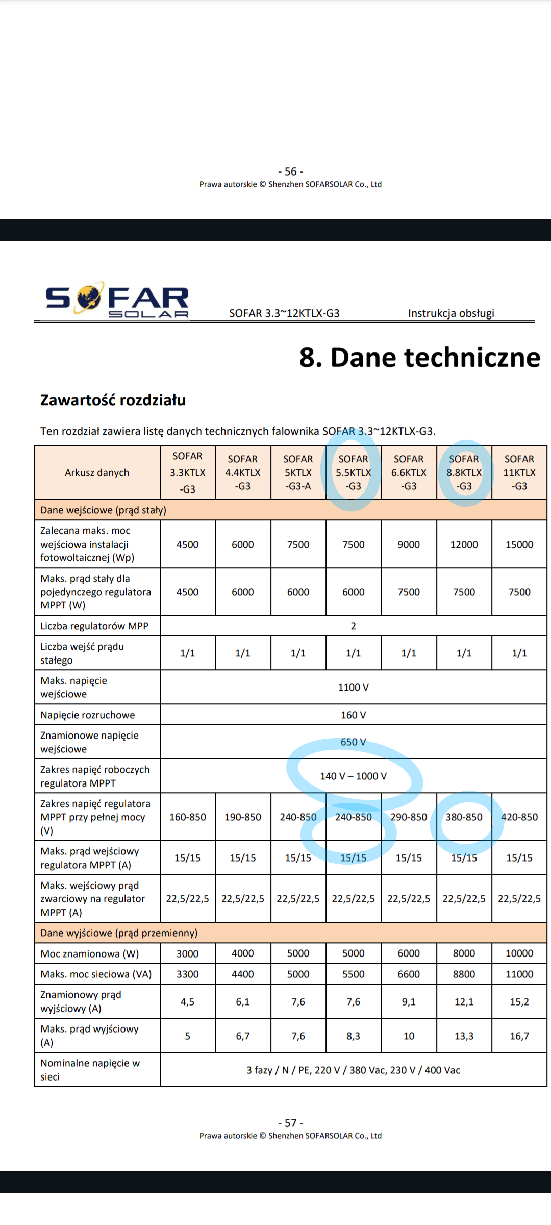

    I have 2 strings. One 6x33V=ok 200V and the other 6x39V =ok 240V. Currently on a sofar 3.6 ktlm g3 inverter it is running well because the voltage range of the regulator
    MPPT at full power is from 160 to 1000V.
    I want to change to a 3 phase 5.5 ktlx g3 but there
    MPPT regulator voltage range at full power
    (V) is 240-850. my question: will the first weaker string which is always around 200V work at full power? I will add that the operating voltage range of the inverter is 160-1000V. The 8.8 inverter has the same operating voltage range but at full power 380-850V here both strings are much lacking. How do I understand all this? Is there any point in fitting the 8.8? In the future I will certainly add panels, but I want to start by replacing the inverter. Technical data table for SOFAR 3.3~12KTLX-G3 inverters. @ElektrodaBot

    A string of approximately 200V will not operate at full capacity on a SOFAR 5.5 KTLX G3 inverter because the voltage range of the MPPT regulator at full power is 240-850V. This means that 200V is below the minimum threshold required to achieve full power.
    Detailed step-by-step analysis of the problem .
    1. Current configuration:
    - String 1: 6 x 33V = ~200V
    - String 2: 6 x 39V = ~240V
    - Inverter: SOFAR 3.6 KTLM G3
    - MPPT regulator voltage range at full power: 160-1000V
    - Operating voltage range: 140-1000V
    2. Planned change: .
    - New inverter: SOFAR 5.5 KTLX G3 (three-phase)
    - MPPT regulator voltage range at full power: 240-850V
    3. Performance analysis: .
    - String 1 (200V): The 200V voltage is below the minimum 240V threshold required to achieve full power on the SOFAR 5.5 KTLX G3 inverter. This means that this string will not operate at full capacity.
    - String 2 (240V): The 240V voltage is at the minimum threshold of the required range, so this string will operate at full capacity.
    4. Inverter 8.8 KTLX G3: .
    - MPPT regulator voltage range at full power: 380-850V
    - Both strings (200V and 240V) are below the 380V minimum threshold, which means that neither will operate at full capacity on this inverter.

    1. Addition of panels: Consider adding panels to the 200V string to increase its voltage to at least 240V, allowing it to operate at full capacity on the SOFAR 5 inverter..5 KTLX G3.
    2. Future expansion: If you are planning future system expansion, it is worth considering an inverter with a wider MPPT voltage range that will be suitable for both your current and future configuration.
    3. Consult an expert: It is recommended to consult an installer or photovoltaic system expert to make a thorough analysis and plan for future expansions.
    Summary .
    Changing the inverter to SOFAR 5.5 KTLX G3 may be reasonable, but requires string adjustment to meet voltage requirements for full performance. Assuming a SOFAR 8.8 KTLX G3 does not make sense with the current string voltages.
