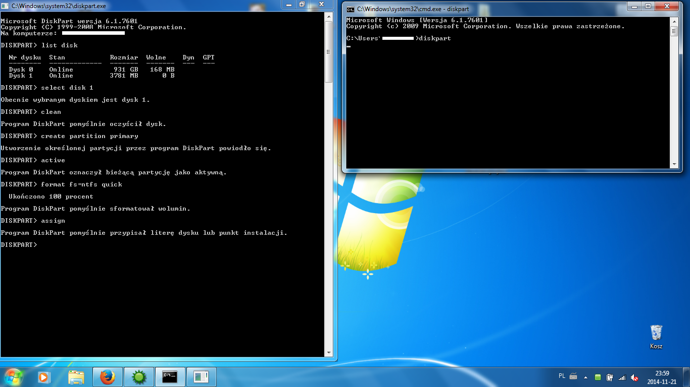

    Hello, how to unboot pendrive? I booted it to upload the system, now how to restore it to its original form? Unfortunately, movies on TV do not go well on it.

    Enter cmd then type diskpart , then list disk , select your flash drive, i.e. enter select disk (here the digit of your memory), then you type clean .
    Then type create partition primary , later active .
    Then you type format fs=ntfs quick then assign .
    Example:

    OK thanks :)
