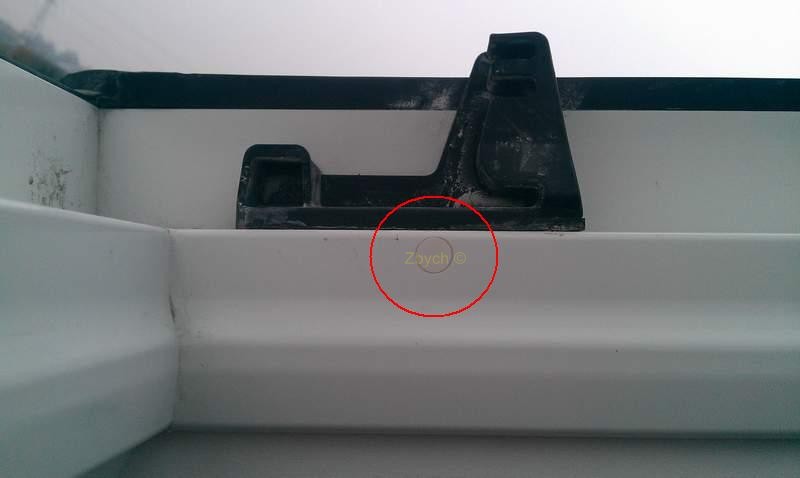

    This is what recessed reed sensors installed by us look like:
    Reed Switches in Windows: Alarm Integration, 4-Wire Contracts, WK1/WK2 Fittings & Keyed Handle Reed Switches in Windows: Alarm Integration, 4-Wire Contracts, WK1/WK2 Fittings & Keyed Handle Reed Switches in Windows: Alarm Integration, 4-Wire Contracts, WK1/WK2 Fittings & Keyed Handle Reed Switches in Windows: Alarm Integration, 4-Wire Contracts, WK1/WK2 Fittings & Keyed Handle Reed Switches in Windows: Alarm Integration, 4-Wire Contracts, WK1/WK2 Fittings & Keyed Handle

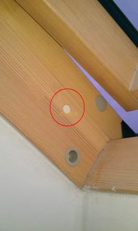

    This is what the recessed sensors mounted by us in roof windows look like:

    Here is another "professional" installation of reed sensors made by the window manufacturer - WindowsPlus (2017).
    The no-name reed switch is glued inside the frame, but on the outside.
    Only about 10 mm of plastic separates it from the outer part of the window.
    It can be blocked from the outside with just any magnet!
    In addition, it is mounted at the top of the window, which makes it impossible, for example, to sleep with a tilted window and simultaneously secured with an alarm!
    To what nonsense WindowsPlus writes on its website:
    WindowPlus: Perfectly safe windows from the OknoPlus offer owe their definition not only to the ActivPilot fitting, but also to the contact sensors.
    These little opening detectors or balancing a window they are a discreet and at the same time very effective supplement to the anti-burglary system.
    The biggest advantage of reed switches is that they trigger the alarm when the thief tries to get home and not only when it is inside it, as is the case with motion sensors.
    Lie! The reed switches are only open sensors, not balance sensors.
    It is absolutely not true that the reed switches sound the alarm when the thief tries to get home!
    Such attempts to force a window open are detected by inertial (impact) detectors, not by reed switches.
    WindowPlus: Thanks to this, we gain valuable moments to notify the relevant services about an attempted break-in and thus increase the chance of preventing theft.
    Lie! We gain nothing and we do not increase the chance of preventing theft.
    The reed switch will work WHEN OPENING THE WINDOW , i.e. a few seconds before the internal motion detector is triggered.
    Only inertial (impact) detectors detect attempts to force the window open (e.g. prying with a crowbar) and in combination with the so-called. burglar alarms give you valuable time and the ability to prevent theft. The alarm will be triggered when hammering the crowbar (and not only after breaking the window - as in the case of the reed switches themselves), and the thief remains outside and struggles with the window. This is what gives you that precious time to prevent theft!
    WindowPlus: They are also an extremely aesthetic solution - WindowsPlus installs them already at the production stage, so they do not disturb the appearance of the window frame.
    Another marketing crap suggesting that only "at the production stage" it is possible to aesthetically and invisibly mount the reed switches. Just look at my photos in this thread ...
    WindowPlus: By combining the ActivPilot fittings with reed switches, the OknoPlus company received perfectly safe windows. The kind that cannot be crossed by any thief. The combination of the opening detectors with the octagonal eccentric mushroom, which is the basis of the ActivPilot locking system, means that a burglar has no chance of breaking the window sash. Thus, our relatives and our belongings are perfectly protected.
    Only marketing gibberish is perfect here ...
    They mislead customers on purpose! The client does not know each other, so he believes in a large, well-known company ...
    At our client's, they installed sensors in several windows so that they do not work, so they did it simply - without checking. We'll see how they handle it :)
    To sum up (information for customers) - the alarm system should be installed by a specialized company (also window sensors). Then one company is responsible for the whole and you have a chance to protect perfectly!
    A good perimeter system is a combination of reed switches and inertial (impact) detectors + several internal motion detectors.
    Of course, the investment in window fittings (i.e. hinges and locks) with increased burglary resistance greatly improves the entire security system.
    Anti-burglary fittings give additional time to stop the intruder outside with the alarm already wailing and the intervention crew on their way to the scene.

    _ZBYCH_ wrote:
    Badly installed sensor - not only is it not working, but it has also been destroyed by the magnetic roller of the fitting, which tore the plastic cover of the sensor and damaged the inside of the detector.
    I do not understand in the first photo, why is the mounting screw marked in a smaller circle? It is a WinkHaus reed switch which is probably installed like this, of course the very position of the reed switch is bad, which caused the reel to damage it.

    pasikonik5 wrote:
    Find the difference :)

    I do not know if I will dazzle you, but I will explain what it is about.
    Pay attention to the size and type of screws.
    In the photo with the screw marked in the red circle, the sensor is attached with large, standard window hardware screws (C).
    The wrong screws with a countersunk head used make it impossible to adjust the sensor (moving to the sides), not to mention dubious aesthetics.
    The sensor should be screwed with cheese head screws (A, B) of a size that allows the sensor to be moved sideways within the range provided by the manufacturer.
    The fittings fitter did not want to do a few more steps (marking places for screws, drilling holes, unpacking the screws from the sensor kit, using a different screwdriver, etc.).
    It was easier and faster to knock down the sensor with a screwdriver for fittings screws with one move ...
    The magnet in the hardware component is weak, so the sensor must be precisely mounted and adjusted, not just screwed on to hold it securely.
    Knowledge and work culture are bowing :)
